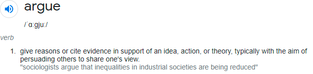

The regulation does not state "unless some people argue..." :) Some people argue the world is flat.
All true - but you're taking my word "argue" in a different sense from what I intended, so lets try again ...
"Some people may hold, and attempt to promote, the view that a reversible plug/socket represents a 'less degree of safety' than does a non-reversible one"
