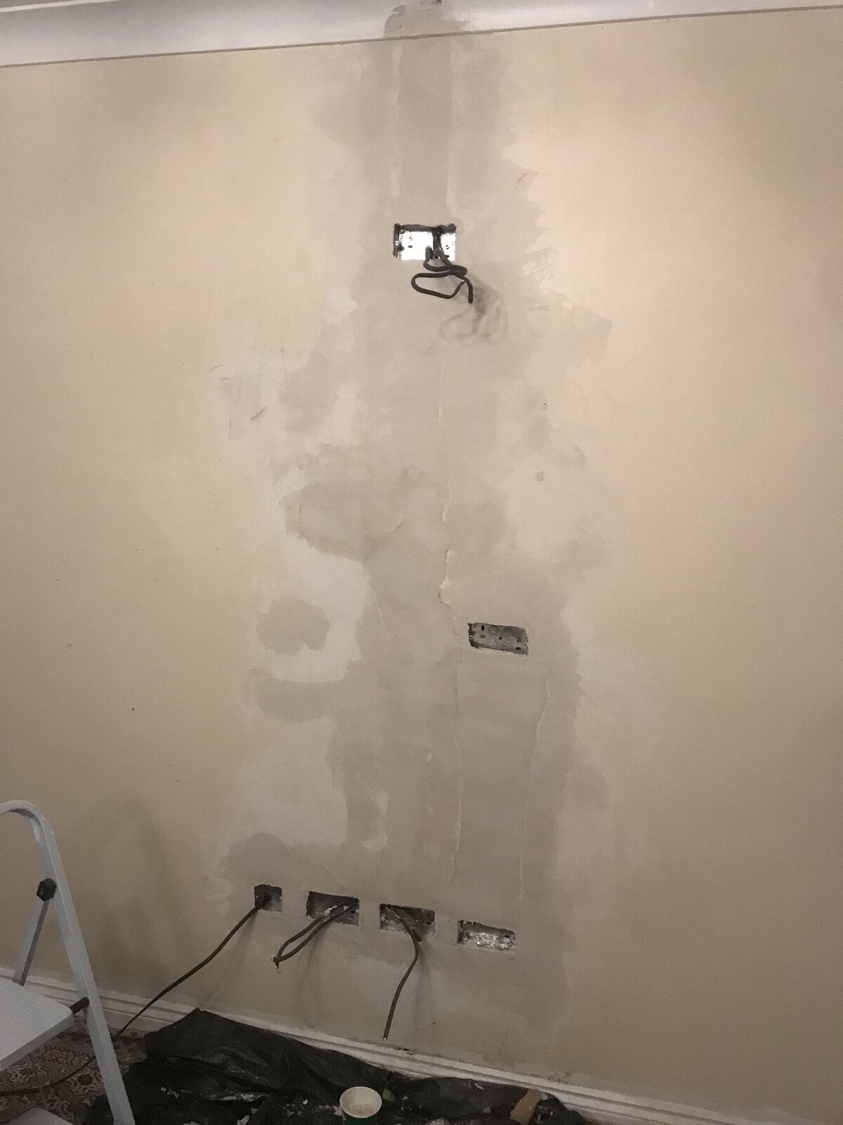

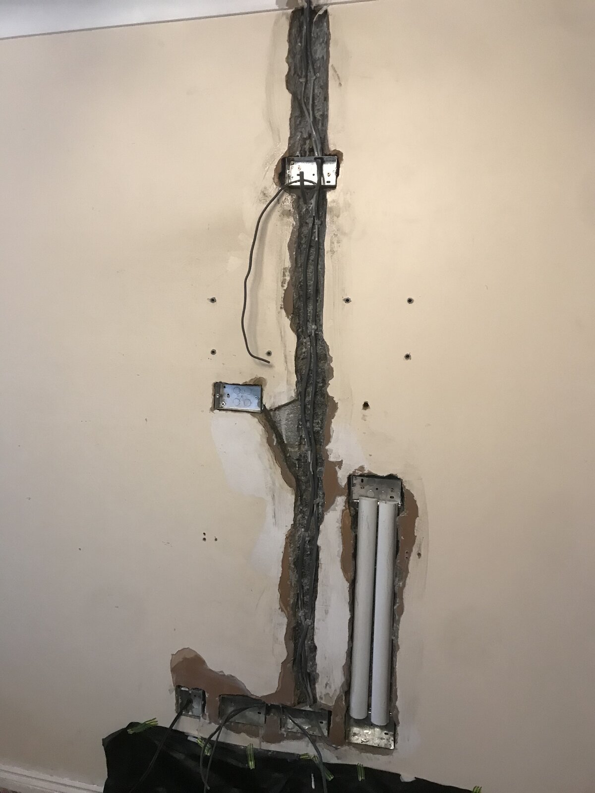

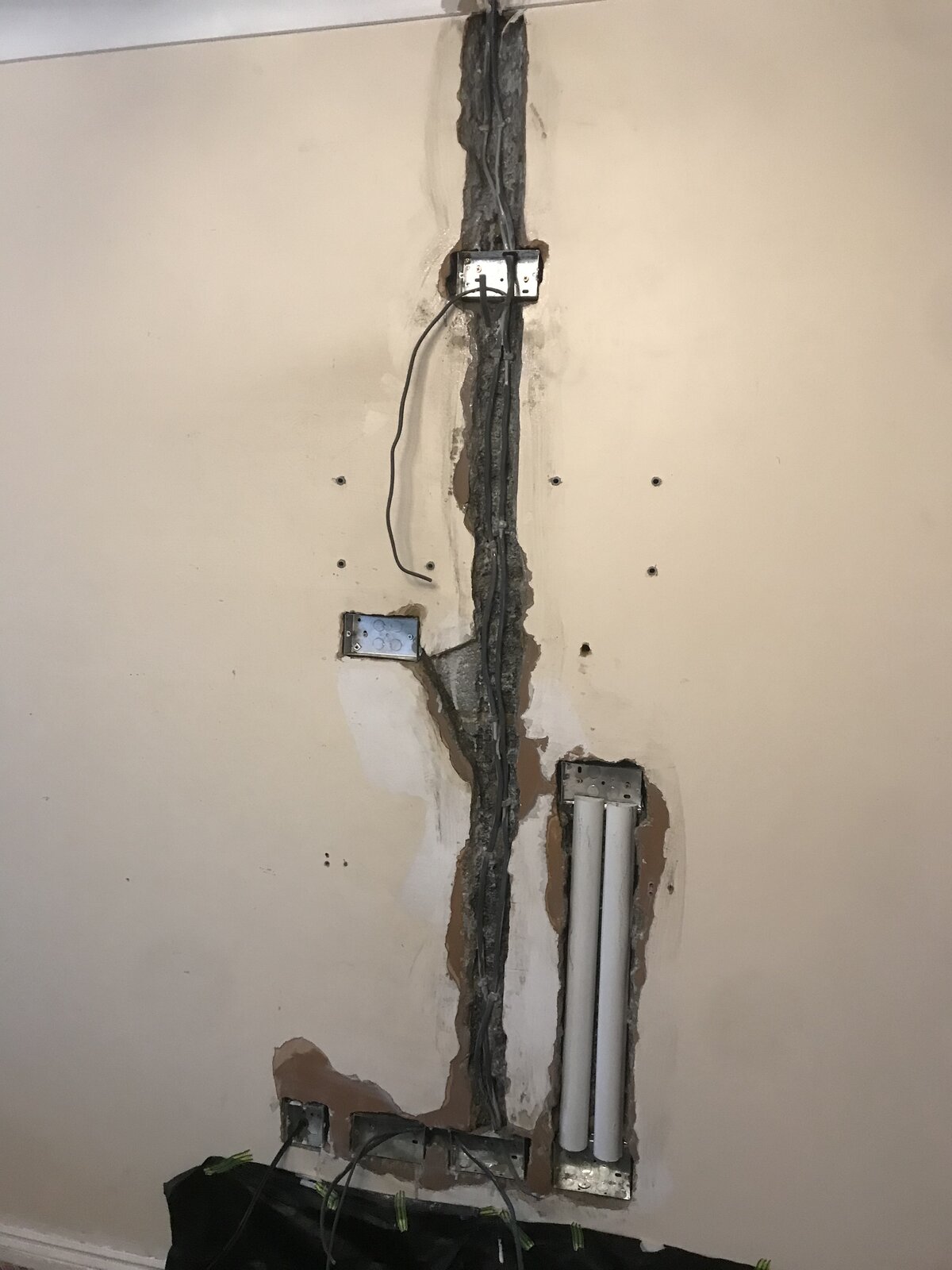

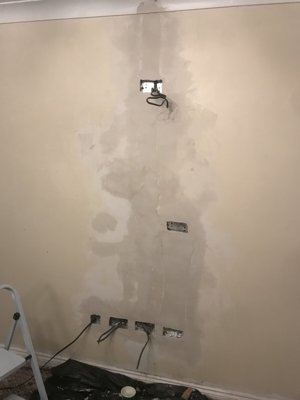

UPDATE: I have a run in a new and separate RFC for my 3 double sockets. I managed to source a new breaker for this SCHUPA Consumer Unit so need to double up an existing MCB.
I used a drill and chisel bit on my hammer drill to keep these chases as tight as possible. Struggled…
The easifill beautifully smoothed it all out.
I’d welcome your feedback and thanks for all your help.
New and separate circuit is notifiable work. How are you going to notify this work if you are not registered with one of the Competent Person Schemes?
How have you carried out the required continuity, insulation resistance, EFLI and other tests on this new circuit?
I own a MFT and will do the Continuity, Insulation Reistance and RCD tests. I then have a local sparky that will certify it and do the necessary admin.
It has always been permitted to use the LABC, and in England you can get third party inspectors, although not in Wales, the new circuit seems to be a bit vague, as it seems adding a FCU is not classed as a new circuit, I have one cable feeds a back box, can't remember if blanking plate or FCU, I would guess it did feed an outside socket at one time, so was likely once a circuit, so fitting an outside socket would not be a new circuit, although still notifiable.
