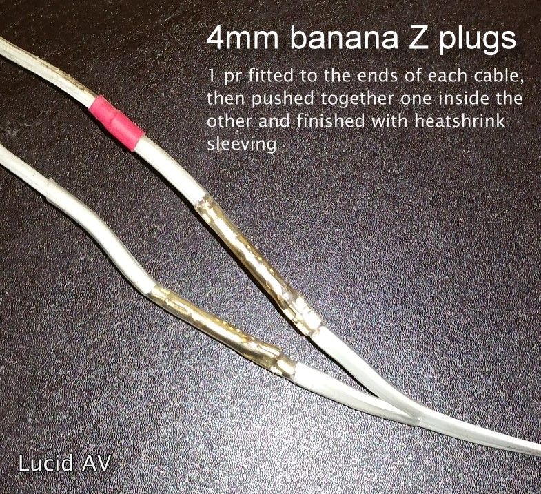

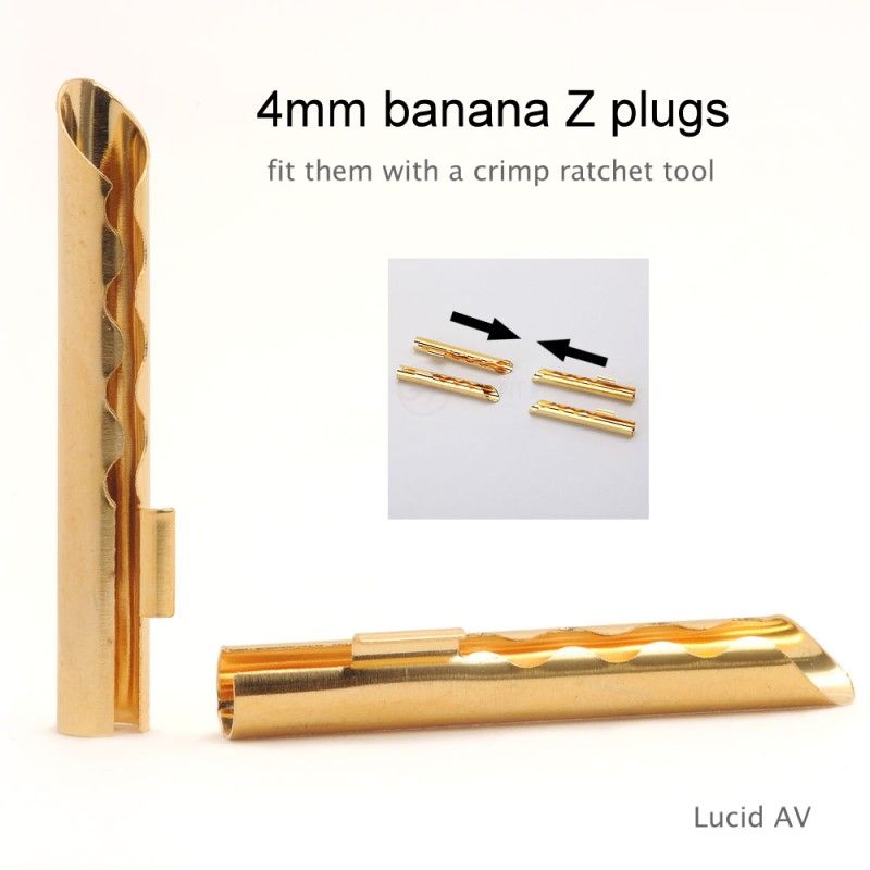

Following a shift around in the living room I had to extend the cables for the surround speakers by a metre or so. Since there's some possibility that gear might move again in the future I thought it best in my case to have something where the extension could be removed easily. I use Z plugs (A.K.A. BFA plugs) for installation work: They're a hollow tube with a slit down one side which allows them to flex. This also allows one plug to slide in to another which makes a decent way to extend a cable with a good surface contact area and minimal bulk.
Z plugs are a bare metal connection, so the outside of the mated plugs must be insulated. In my case I chose clear heat-shrink tube and slipped that on before making the connection. Once the heat is applied then it both insulates and acts as an additional grip to hold the joint securely. The plugs themselves are fitted using a ratchet crimp tool for electrical wiring. Something like this would do. The cables being joined here are some QED Performance to some 79 strand flat.
Here's the plugs and my cable joints at home.
