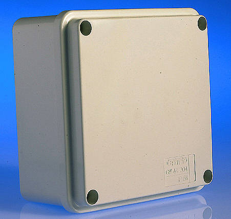

Extending ring mains from summerhouse to pergola area.
I was thinking of using this for the 2.5mm2 T&E cable in the PVC box, then SWA cable on the opposite side with glands/nut.Is this okay ?
No problem with that, if the box is likely to be exposed at any time, it might be an idea to fill the ends of the cable glands, where the cable enters, with a smear of weather proof silicone sealer. This makes a lovely water-tight seal in case the worst happens, and it is also easy to relove the cable if required.

Blimey Breezer, you must be a mind reader :!: That's exactly the same box and size I've bought from TLC yesterday :!: I got a feeling you lot are watching me very closely just round the corner somewhere :LOL:
