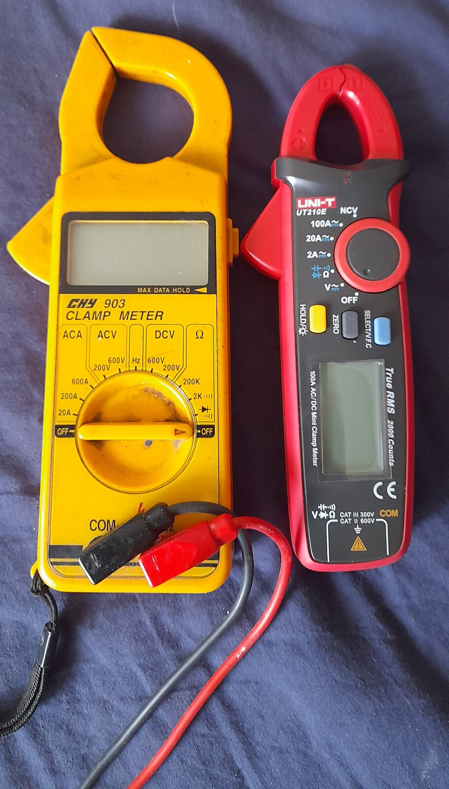

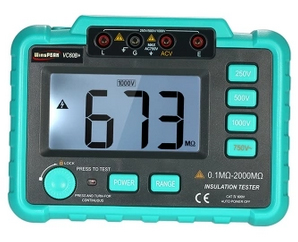

There are three test instruments, the RCD tester tests the RCD, we will assume the RCD is OK, so we have the insulation tester VC60B.jpg and the clamp on ammeter Clamp-meters.jpg the insulation tester used 500 volt DC the problem is it uses DC so will not pick up leakage due to capacitive or inductive leakage, and the clamp on will only measure if the RCD has not tripped, so both have their place. The problem is the yellow tester to left (my old one) measures is 0.01 increments, this was good enough when I bought it working in Hong Kong before take over, but today we need to measure in 0.001 increments to show what the leakage is in mA. I had to hunt hard even today to find one that measures in 0.001 amp increments, I also wanted DC so likely paid more than needed, cost me £35 the UT210 comes in a few versions, I have the UT210E which will measure DC there is a better one which also measures frequency, and some cheaper ones which don't measure DC.
But without some test equipment there is a lot of guess work, the insulation tester also cost me £35, you don't really need both, but you do need some thing to narrow down what is faulty, to hire will likely cost more than to buy, the reason is to hire they need a calibration certificate, and it is the testing after each hire that costs, since your not filling in a test certificate you don't need it calibrating.
The question is which is cheaper, buy test equipment which you may never use again, or get an electrician who has the test equipment? I love my clamp on, it is so easy to see how close to the wind one is sailing, we for years used RCD's and MCB's and it may just be the small amount of leakage on each circuit is just adding up so too close to the limit, my own house total shows around 24 mA leakage, so with a single RCD it would not take much more to trip them, they will normally trip between 24 - 28 mA but my house split between 14 RCBO's (MCB and RCD combined) so each RCBO is well within the 9 mA limit suggested as the limit for a 30 mA circuit.
We would expect well over the 1MΩ minium for each circuit, more likely 10 - 100MΩ, but capacitive and inductive leaking is not tested with DC, so with an AC supply there is always some leakage. I would find in old house I would get a batch of trips, then not trip for years, never did find why, but did not have the red and black clamp on then. So this house one of the first things was swap to all RCBO, OK it was expensive, but likely only the same as loosing my freezers when a RCD trips, living 8 miles from main shops I keep a lot in stock, so would think around a £600 bill to re-stock. Not sure if insurance would cover that bill?
