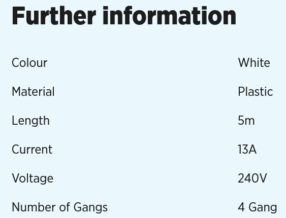

and looking at the advert yes this is a worry 1730119024511.png no where does it say what size of cable used. It just says 13 amp.

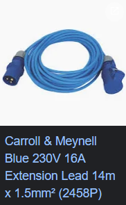

The caravan hook up cable BS 7671 says minimum of 2.5 mm² and 25 meters (±2 m) so google it and 1730119465732.png this is only 1.5 mm² and too short, but it does tell you the size, and why should we have to have such a hefty lead if not required?
