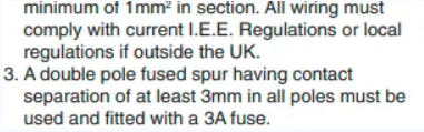

It amazes me too how many installers have the attitude of "that's what the instructions say so that's what it'll have", thereby unncessarily complicating the installation. For me, the tenuous nature of 'invalidating warranties' just doesn't cut it.
You will find that if there is one single defining characteristic shared by all tradesmen in the UK it is an inability, verging on a perverse refusal, to think for themselves

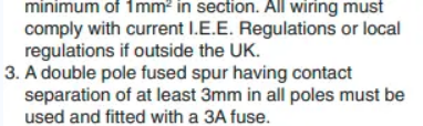

I disagree with your reading of this. You seem to be omitting the full stop, and new paragraph number 3.
Eh? I'm not missing anything.

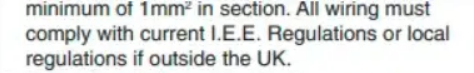

I included the last couple of lines of Instruction (2) merely to indicate that it presumably is acknowledging that the product may be installed in a country other than the UK ..
... and then, as a totally different issue, Instruction (3) says that there must be a 3A fuse - so, as I asked, if someone outside of the UK (like yourself) were reading those instructions, how would they bee expected to implement the requirement for a 3A fuse in their country ?
Kind Regards, John
Would this be clearer?

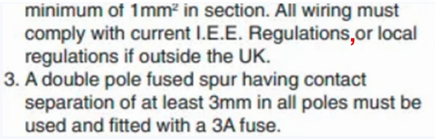

All it needs is a comma here:
That's even better - but, as I wrote, I was already assuming that, and only included a small bit of Instruction (2) to indicate the expectation that the instructions would/could be read by people outside of the UK (which, as I went on to say, makes practical nonsense of the subsequent 'requirement' for a '3A fuse').
Yes but it says to follow local regulations as the instructions are written in English for the UK.

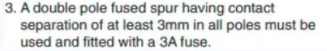

Not totally different; continuing their instructions for the UK.
Well, they wouldn't be reading them, would they?
how would they be expected to implement the requirement for a 3A fuse in their country ?
Even if they were reading them, they would read the instruction to follow the local regulations and do so.

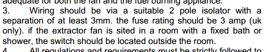

It would be interesting to know the instructions given for the same item in Europe.
This is getting to be hard work :)
As I said, although the instruction are written in English, they contain the phrase "if outside UK" - which surely indicates that they acknowledge that the instructions may be read by, and 'implemented' by, someone outside of the UK, doesn't it?
(3) is a "totally different" instruction from (3), relating to "totally different" things, and nothing in (3) says that it is an instruction which only applies to the UK - that's surely the whole point of what I am saying.
If the instructions had not been written on the basis that they might be read by someone outside of the UK, why would they contain the phrase "if outside UK"?
Again as above, the reference to following local regulations i part of instruction (2). There is nothing in instruction (3) which indicates, or even suggests, that the 'requirements' of (3) don't apply (and one should, instead, follow relevant locally regulations)
I'm more than a little surprised that you appear to be 'defending' them!!
Leaving aside the "fused spur" (surely that proves they don't know what they are talking about) - any competent person should immediately realise that by following the local regulations, even in the UK, neither local isolation nor a 3A fuse is required for a fan.
I see no claim that the explicit requirements of the instructions [e.g. Instruction (3)]have anything to do with regulatory requirements - that are simply ones that the manufacturer themselves are trying to impose, aren't they?
, in any country.(in addition
Surely, the so-called manufacturer's instructions are just "wot sumwun rote" thinking they were the UK regulations.
As above, I don't think so. They seem to be (themselves) requiring things in addition to the regulatory requirements of the country concerned- since they also say that "All wiring must comply with current I.E.E Regulations or local regulations if outside of UK"

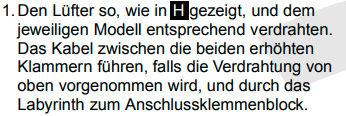

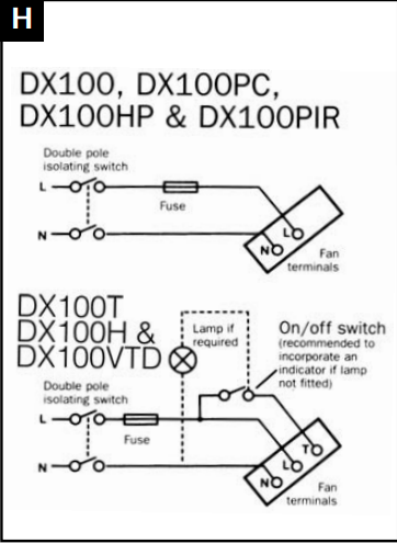

... It would be interesting to know the instructions given for the same item in Europe.....
I've found some Xpelair MIs which come in 10 laguages (perhaps surprisingly, not including Spanish or Portugese). There is a single set of diagrams at the start (i.e. common to all languages), which inclues this one:
... note that it includes a 'DP isolator' and a "fuse" (on unspecified rating!).

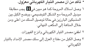

That diagram is referred to in every language text, such as (in languages I know at least something about!) ...
... and even in Arabic,although I'm not certain as regards what it's saying about the diagram :) ) ....
...so, it would seem to be that if one is reading it in any of those 10 languages (most probably because one is in a country where it is the most common language), one is being told to include a DP isolator and a "Fuse" (of unspecified rating - although I have to wonder how one is expected to implement the latter (even after deciding which fuse to use!) in non-UK countries.
