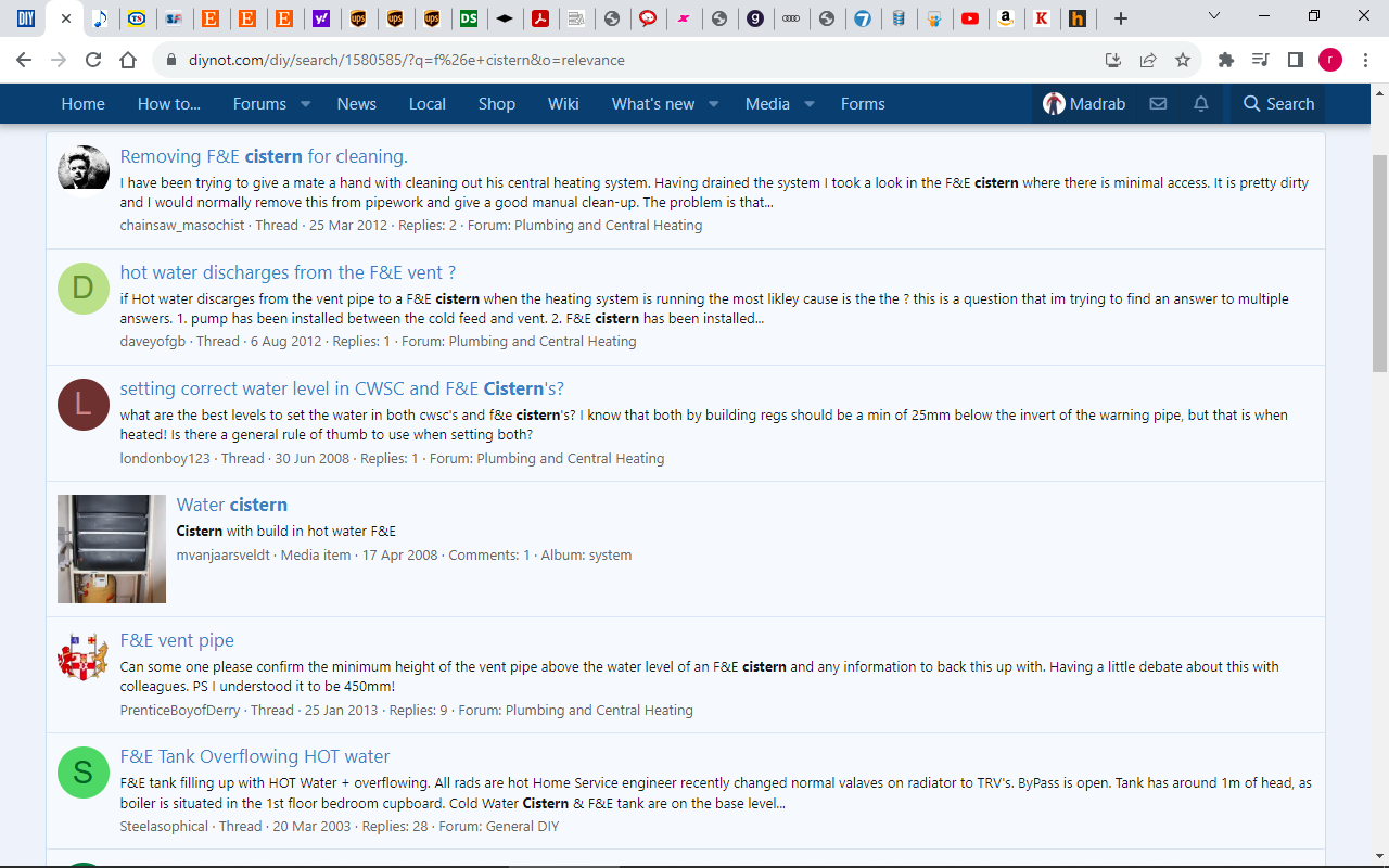

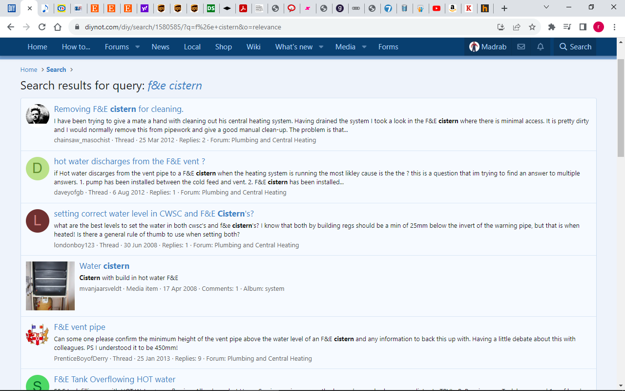

I wouldn't disagree with that, but what I do find difficult to grasp is the "constant" overflowing, if the ballcock was tied up then surely there is a limit to the overflowing?, I also can't grasp the fact that the system alone can provide even enough to fill the F&E even once except that air is being drawn in and on heating is displacing the water, the cause of air being drawn in through the vent can obviously be a partial blockage or far more unlikely, circ pump installed wrong way round.
oh and just for a balanced view ;)
