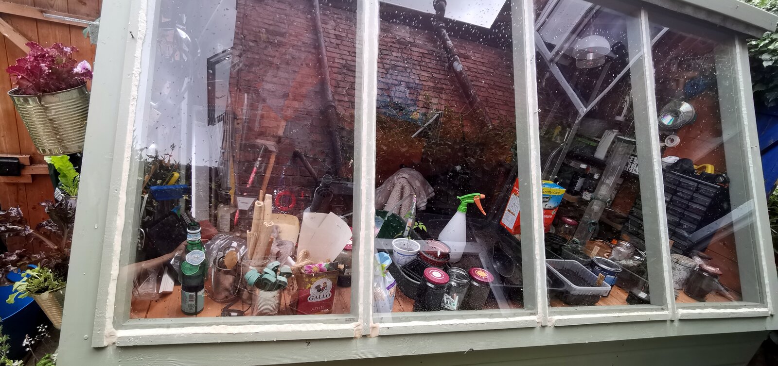

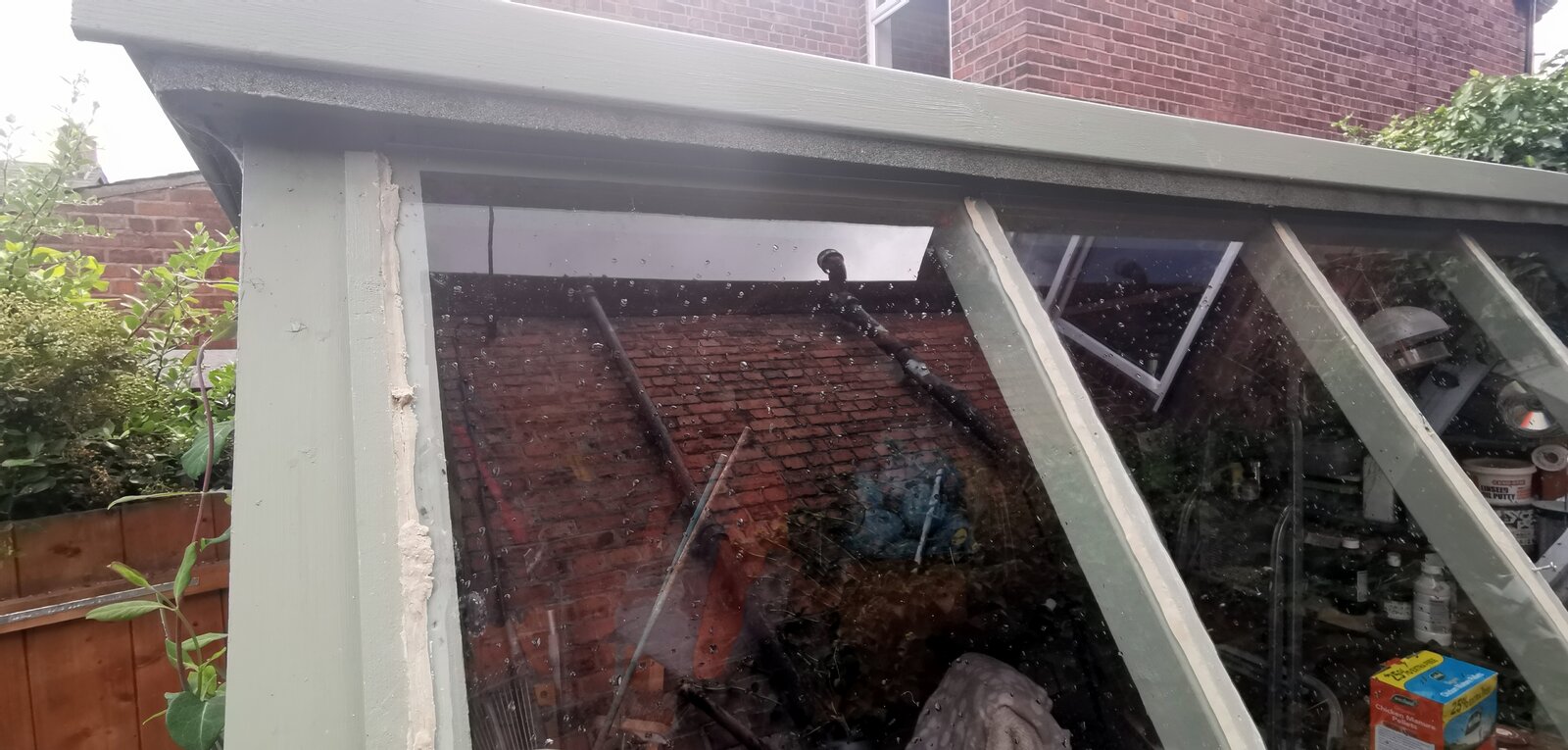

I have taken these images to show the layout of the shed as best I can with a phone. Please ignore the mess, I am in the middle of a sort out.
As you can see the roof overhang stops rain getting into the vey top of the glass which is why I didn't (under the advise of Tiger) putty the top. The rain was getting in about halfway up the very left pane's edge, which is where you can see my botched attempt to temp fix it by adding putty over the top of already set which turned out a dog's dinner. The glass sits on recessed wooden frames and an outside ledge. I haven't used tacks as the putty and gravity hold the glass in.

I'm still not following, are you going to remove the glass, clean off any existing putty from the glass/frames and then reseal the glass in with sealant underneath/alonfg the edges of the glass to completely encapsulate the edge of the glass or are you still planning on just applying sealant to the outside?
I am guessing that the roof is mineral felt and the upper moulding is tacked to the felt. If so some water will leak past that upper moulding.
I cannot say if it is enough to leak behind the upper glass beading.
Thinking aloud, you could tape some kitchen paper to the inner side of the window, very high up, and see if it gets wet when it rains next.
I can understand your hesitancy to remove the beading, risk of snapping etc. A bead of caulk (read: ms polymer) may suffice, but if you cannot get the nozzle in properly, it may be advisable to at a minimum, remove the top one and bed it back using a ms polymer.
My gut feeling is that the water is entering from the top of the glass but I admit that I am guessing.
Perhaps, stand on your step ladder with hose and try to replicate the typical direction of rainfall. Make a note of what happens, Then the following day, use some gaffer tape to cover the top moulding, and see if things are different.
I have to agree that the advice offered by the other members to remove the glass and seal both sides is the best option, but you may be able to sort it without doing so.
