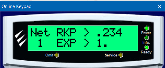

Today I performed a walk test - all ok, Zone test - All ok Tried to arm the system with two users nothing happened - no exit tones nor being set. I have used Wintex V7.2 to save the log which I list todays activity here. I have also attached a file with screen dumps that may also assist in determining the problem, I am confused by the different conditions of the keypads.

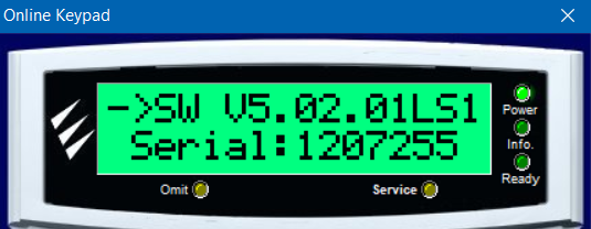

How old is this system ? What firmware ? Press menu 4 on keypad …what version is wintex ?

what does it show in confirmed devices in engineer utils?
The system is new put in the begining of this month, it's my next door neighbours. Wintex version is 7.2 System version

There are only three keypads in use, I'll change the address to 4 and try again.
Or there are 3 keypads addressed wrong and you are trying to set it from keypad 4 which doesn’t have an area assigned according to your wintex
I think then that keypad 1 is addressed as 4 , check keypad 1 dill switches and set to 1
