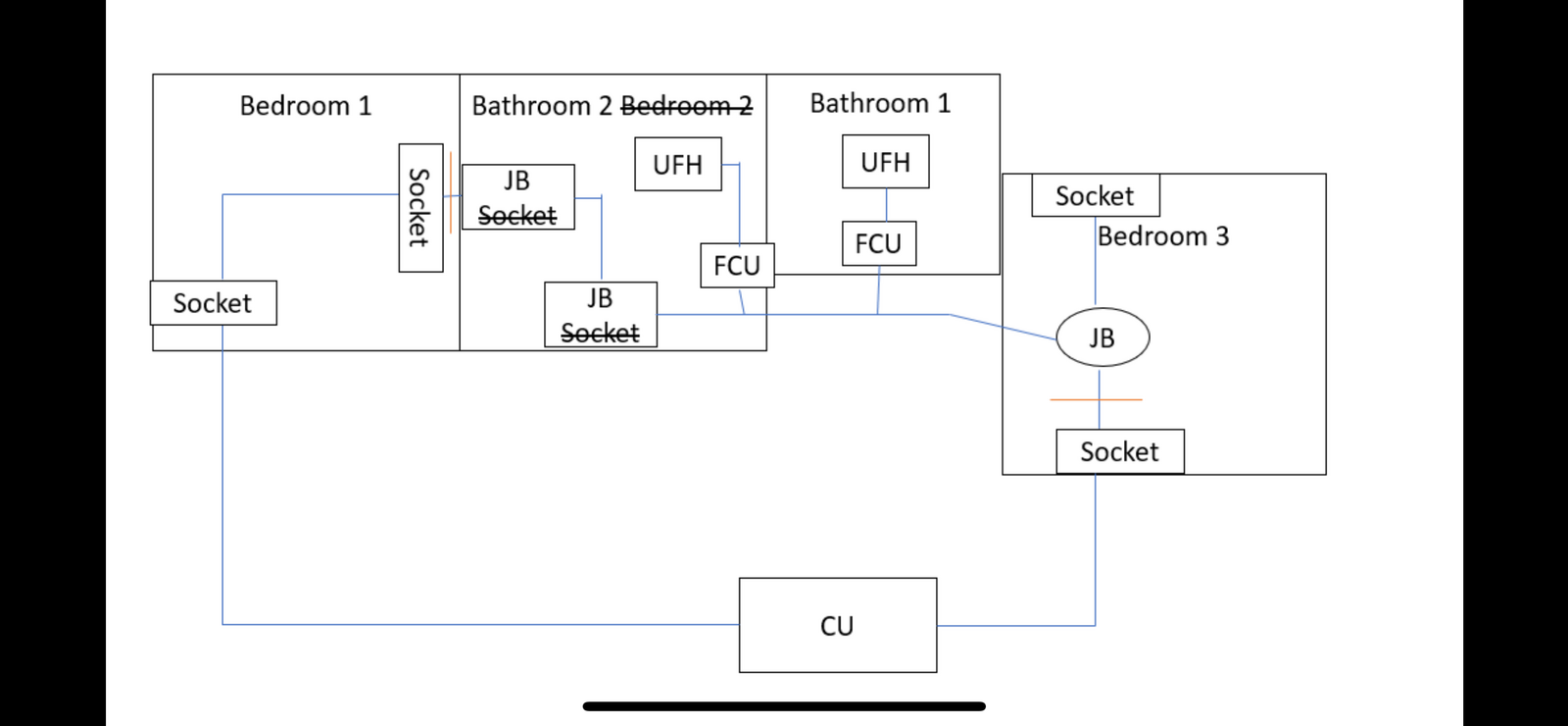

Here is a quick n dirty sketch of what I believe the circuit looks like. Bedroom2 was one of the projects where we converted it into a Bathroom. This is where I suspect the fault will be. The bathroom obviously now does not have the two sockets anymore so the bathroom fitter will have just closed the ring via JB. My DIY was only a replacement of sockets in Bedroom3 and I am quite confident and already checked for loose connections. Bedroom1 so far untouched. Where I drew the amber lines is where I can break the circuit and test both sides...and my guess is I will have full continuity over the "long" way via CU, but not between the rooms. Unfortunately most of that cable is under a new bathroom floor, but as both sockets were in the skirting board I might have access opening the skirting board from the other side... let's see
Have you done as I suggested as in looking at the connections behind sockets and fused spurs ?
And a bathroom fitter made changes ?
Not yet, but will do this after work today or tomorrow. Was just hoping I could investigate w/out taking out all the sockets, but I guess it is not actually that much effort and a more secure way of excluding a few sources of faults.
I will check all accessible sockets and FCU and provided that the fault is not there, will temporarily split the ring and confirm that the fault is indeed in the bathroom section. Will report back.

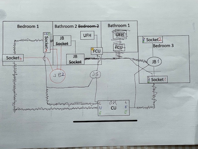

So I did follow the pen and paper method and while it took forever, it seems to have been the only way. For some reason the sparky put a large JB just above the CU, which only had the two largest ring finals passing though. But this actually was very useful, as I could fully disconnect the ring in question without opening the CU. I opened up all reachable sockets and both FCUs and ended up with quite a few changes to my initial assumption of how the circuit runs. I must've run up and down from the cellar to the first floor about 30 times, each time reconnecting leads and testing. And then there are these moments when you think you got it all figured out, only to find continuity on two ends which just can't be possible...
After many iterations, I came up with below circuit.
I've tested separately L/N/E continuity from CU to JB1 (and therefore Socket 1&2) and from CU going the other way to JB to Socket 3 to JB2 (which is somewhere under the floorboard), but could confirm continuity of L/N/E to socket 3&4. I also found out the FCU/UFH of Bathroom1 is on another circuit.
So the fault is definitely somewhere from JB2, going under bathroom 2 along where there used to be 2 sockets and then to Socket1. I am not sure how to proceed from here, as Bathroom 2 is fully tiled with underfloor heating. I might be able to get to the lower JB/Socket in Bathroom2 via the hallway but I would need to lift some carpet and cut into floorboards. Technically possible and can be easily repaired, but if it's the other JB/Socket then I probably will never have access. In absence if this, I assume my only way out is to make two radials? One going from CU to the right to JB1 serving just socket 1 and socket 2 and then the other going from CU to the left to JB (serving the UFH) and then to socket 3 and 4.

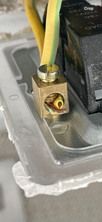

Along the way I also found this exceptional wiring at the FCU... unfortunately unrelated to my CPC continuity problem...

In case anyone was wondering.... I finally managed to resolve this!
But FFS I was looking at the wrong area...
I actually went ahead and lifted the hallway carpet and opened a few floorboards to trace cable routes. Took an entire day, as I wanted to be careful to not break any of the carpet, carpet grippers, insulation mat, plywood underlay etc... In the end, most cables just went somewhere else through joists so there was no JB or anything in sight for me to inspect. I did however see one set of cables following into an an unexpected direction and... lo and behold, I did uncover another unused socket in bedroom 1 hidden in the skirtingboard behind a wardrobe wall...when I managed to get access to it I could already see it was missing a screw and was not even held in place properly. CPC indeed was loose and after re-fixing and testing, I did have full continuity on all three measured at the CU... Phew!
A healthy mix relief and frustration at the same time after spending so much time investigating. I did manage to fix some squeaky floorboards and found a small patch of wood worm damage, onto which I applied treatment straight away. So at least it was not a complete waste of time going though all the effort of opening the floorboards. And I now know a lot more about cable routes in my house...
