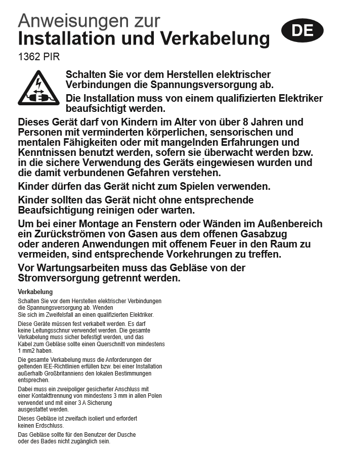

Nope they didn't explain how, but they did sound like they knew what they were talking about, and they sent me a PDF.
This is German.
This is the French
Just been chatting to Manrose Technical.
Their euro installation instructions advise a 3A fuse and DP isolator with 3mm contact gap.
As the fuse is to protect the cable, not the fan on the end of it, do they use such thin cable that a 3a fuse is required?
Are those not just straight translations of the English?
Indeed. They are almost certainly aimed at non English speakers in the UK rather than European installations.
In answer to my question "As the fuse is to protect the cable, not the fan on the end of it, do they use such thin cable that a 3a fuse is required?"
NO. They ask for a minimum of 1mm sq cable which does not need 3a protection.
In answer to "Did they sound as if they knew what they were talking about?"
It would appear the answer is also NO.
On the basis of my very limited linguistic abilities, they certainly appear to be translations of a set of 'multi-national' instructions. For example, both the German and French versions say something along the lines of "All the cables must comply with the IEE regulations or, outside the UK, the local regulations". However, as has been implied, regardless of the language (hence, one assumes, target market) they cal for a DP isolator and a 3A fuse.

Indeed. They are almost certainly aimed at non English speakers in the UK rather than European installations..
It would be simple enough to ask them if those are the instructions provided when the products are sold in countries outside the UK (which I suspect is the case).

However, as has been implied, regardless of the language (hence, one assumes, target market) they call for a DP isolator and a 3A fuse.
Kind Regards, John
And as we all know the 3a fuse (FCU) is not available or compliant in most of Europe. Also why 3a when the cable is 1mm sq or greater? They clearly don't know what they are talking about.
Perhaps you may like to talk to them to find out what's what?
Or merely a translation of British instructions with no regard to foreign ones.
The British version also says that.
It is clearly just a straight translation with no consideration of other standards.
What exactly does "all cables must comply..." mean?
So, we cannot just employ the local regulations, then, nor, indeed just IEE ones?
The British version also says that. ... It is clearly just a straight translation with no consideration of other standards.
Fair enough, I hadn't got around to looking at the UK/English version. In that case, as you say, it seems that we are just talking about translations.
I also wondered that, but didn't talk about it since my point was that they were referring to 'local regulations' for use outside of the UK. I suspect that they are trying to say that not only must the cable be compliant with relevant regulations (e.g. of an adequate CCC, not bare conductors, or single-insulated ones {not in conduit} etc.!) but also that 'the wiring' etc. (i.e. how it was installed) should be compliant with local regulations - which would be fair enough.
It's odd. If it can be confirmed that what we're seeing really are the instructions provided when the product is sold outside of the UK, they appear to be requiring/demanding ("muss", "doit être") fusing that would be difficult/impossible to provide outside of the UK. If that were the case, then there surely would be people "like us" in those other countries who would be making a fuss about wat their MIs were requiring?
