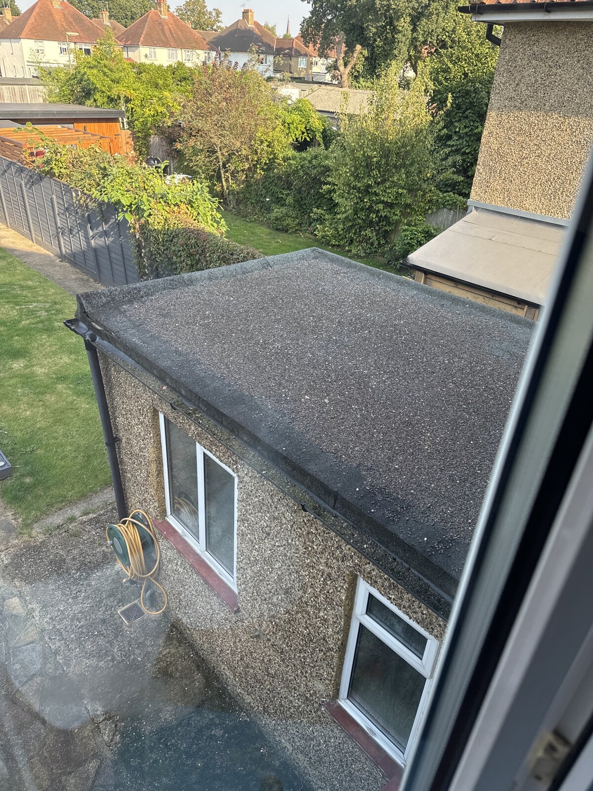

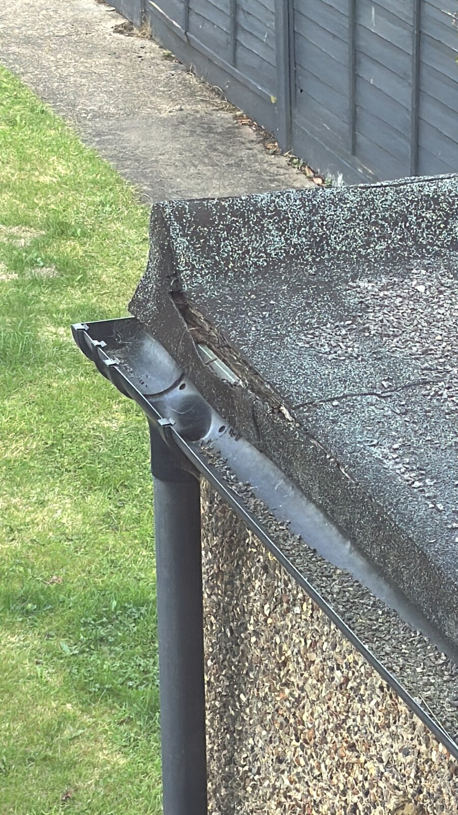

Hi all,
We moved in to our first house a couple of weeks ago and I've just noticed this out of the spare bedroom window. We have a half width, single storey extension which contains the downstairs bathroom and toilet. The survey did say the roof would eventually need replacing but didn't mention this damage, which I'm incredibly surprised they missed.
Is this a DIY repair job, or do I need to get someone in to replace the whole roof? The timber appears to be exposed which is a little concerning.

It’s rotted where it’s been bent over and the sun / frost cycles have shortened its life
You could probably do a local repair, but have a close look and see how far the roof deck and joists have got damaged.
A repair would make it weathertight for a few years perhaps but you will eventually need to get it done….the rest actually looks quite good from the pic
Thanks @Notch7, yeah it's in surprisingly good nick other than some of the grit having come loose. I'll have to get up on a ladder and see how the wood is looking. I'm hoping this is a relatively new thing as I'd be baffled if the surveyor hadn't caught it a few months ago.
In terms of doing a local repair, how would I go about that? Some basic research has told me to buy some new felt like this from B&Q and join it up with some sealant like this. However not sure how I should navigate the fact this is at the roof/wall junction. It looks like it's (or at least was!) attached to the timber with nails

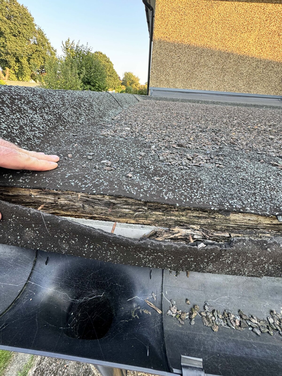

I've just been up a ladder and the joist isn't looking great, definitely seems like dry rot to me.

Its the drip flashing and would have been pinned to the drip edge with felt nails etc. That roof looks about 5 years passed its sell by date. Bear in mind that you'll need to upgrade the insulation (+BC application) when you do strip it out. A warm roof is the most logical way, but increases the overall height somewhat.

OP,
Your joists appear to be running from the other side of the roof, falling towards the gutter - where they end in a fascia board.
Good practice has the Drip Batten (thats the batten you show wet rotting) "wrapped" in the Drip Edge felt strip - the wrapped batten is nailed to the fascia - the Drip Edge strip is then flipped up on to the main roof and, typically, torched or cold fixed on to the main roof.
No joist should need replacing or sistering.
Poor installation of the stones has resulted in bare patches and gutter debris.
The two raised edges are losing adhesion.
Any damp signs in the room(s) below?
Thanks for the thorough explanation @ree . I hadn’t considered that the joists would be running the other way due to the fall. That’s slightly less concerning then!
If I’ve understood you correctly, the drip batten can’t have been wrapped given the felt is resting inside the gutter? Or perhaps there is another layer of felt on top?
It also looks as though it’s nailed to the joists rather than the fascia, which appears to sit below it?

You dont solve it - you strip and, as above, build a warm roof. Use a professional.
I'm well experienced in the building game, & my experience says do it right first time or you will lose more money, and have more worry until you finally have to go for it - just saying.
FWIW: the drip felt strip was installed totally wrong.
