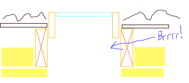

I think we're all talking at crossed purposes because of what I understand 'below the rafter' to mean. I can now see that what's meant (in my world) is 'it overlaps the rafter by an inch or two'.
Going back to my original question, this time with the aid of an excellent diagram... is the primary reason for the 40-60mm recommended gap to avoid this cold bridge where the rafter cheeks are exposed. If so then that's something I'm happy to live with for a little 55 x 78 velux:
full
Are you using the proper velux insulated collar?
If not, you can use expanding foam to fill the 'gap' then use celotex sheet at the side of the rafter (reveal) before you plasterboard.
I know it's a diagram, are your your rafters are really deep, and extend that much below the velux frame.
I didn't think I'd have room for the collar in this scenario, so would probably foam it in a as you suggest.
The rafters are 170, and I'll have 100mm of PIR on the other side of the reveal. I'm not sure how much they will extend below really. I'm happy to risk some condensation anyway, and the main reason for the original question was to check that there wasn't some other reason that velux say there should be a 40nm gap?
