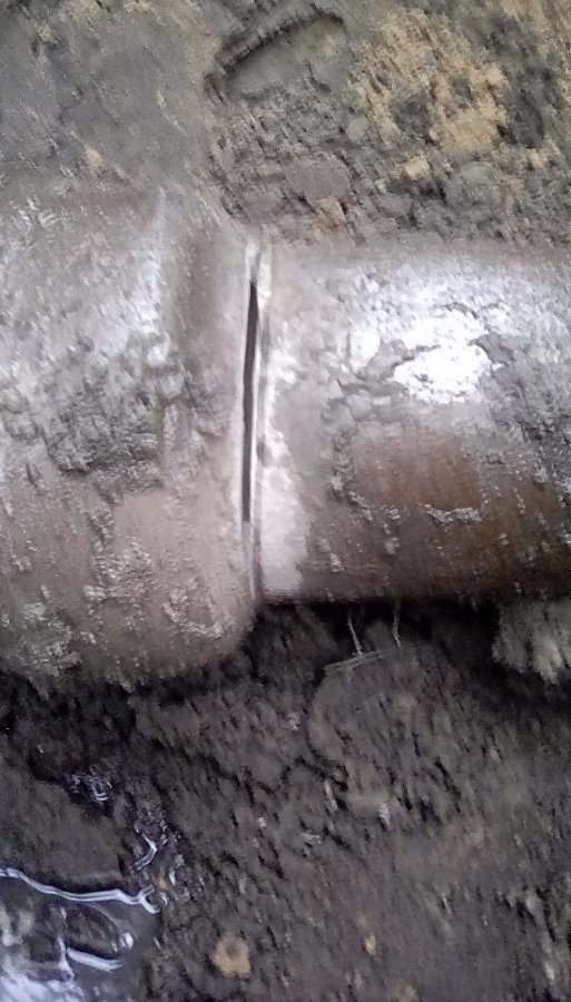

Fitting a gulley riser, new problems found.
That adaptor with the rubber fins (S464 or something) isn't realy the right fitting but it would push inside the clay and do the job. You would need a piece of plastic between that and the gully that's just 13cm long.
A guy I work with just slits the top half of the pipe with his grinder, sticks his spade in the crack and severs it off. It does come off neatish but a bit rough for me.
An angle grinder with a diamond blade.
If I were you I'd carefully break the gully first and you should be able to pull the gully outlet from inside the mortar, before you remove the mortar.
I don't have any of those tools, sounds expensive. Can I do it with a hacksaw, and do the spade trick?
You could try. The clay on the inside is quite soft.
It would be better to cut all the way through if the hacksaw does it.
I would seriously doubt a hacksaw will work. Do you know anyone who has an angle grinder you could borrow?
As 1990 says you could break up the gulley with a hammer and once in pieces you may be able to get it out of the collar but as mentioned but the risk here is breaking the collar (not a big deal) or cracking the remaining pipe in the ground and that is a major pain in the ass. Using the right tool will cost you maybe £30 but will make it risk free. Trying to chip and break it may work but has the risk of having to dig and expose more and replace it too.
A passing builder, road work gang etc will all have a stihl saw in the van and for a fiver would i'm sure slice it for you.
the gulley and the pipe are probably mortared together at the socket. You could experimentally try scraping at the mortar with an old screwdriver. If it is cement mortar, though, it will be very hard and strong due to being wet and curing for 100 years.
Try very hard not to crack or damage the socket or pipe. The gulley is rather heavy so don't let it hang on the pipe.

I can't see. Has the old one fractured at the bend?
Bought a cheap angle grinder.why would I use it without the guard?
I cut a square in the top of the pipe and then sink the grinder through to make a neat cut. With the guard on I couldn't sink it through.
Your hole is nice and big so you should be able to work round with the guard on.
Reckon that's enough to do the spade trick?
Well the spade trick worked. Was putting the adapter in and the next not of pipe was wobbly, had a dig, and the mortar was loose. All other parts are intact, mortar come off easy enough. Shall I remortar it on with the adapter, then start putting a bed down for the gully? Going to lay a square base with bricks, then fill it with sharp sand?
is the ground soft mud now? If so it will probably move as it dries out. Dig out the mud and consolidate (bash) the base.
