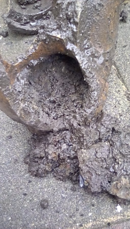

Anyway here is the beautiful piece of pottery that has had me buying angle grinders and putting my hands in crevices.
The bottom hadn't collapsed, but there was a chunk of metal and bricks and only come loose when I lifted it out and it fell apart. Even then I had to smash it with a hammer to free it. As you can see, the vertical part was completely fragmented and seperate from the main part.

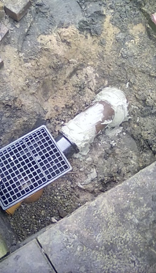

About this black pipe then? Got a couple of 20-30cm lengths, reckon I get away with that?

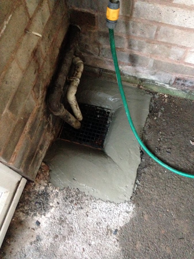

Mortar applied, just waiting for it to dry. Says quick drying, 15 to 30 minutes. Been longer than that. Mortar is certainly firming up, reckon I can just fill it in? I've seen grids with gravel around them, is this for appearance or does it have a practical use? My concern would be gravels dropping down drain.
As long as the black pipe is the right size it will be ok.
I'd mortar around the gully. As well as gravel falling in the gully you could get water passing the gravel into the ground.
The mortar will be slower because it's cold.
So, its functional now. I had nothing to complete the surround. I'm thinking dig soil out, bed some 10mm gravel, then mortar/concrete a bed for the nice concrete square surround I saw?
You could just mortar on the soil and put a slope down to the gully top. A bit like this:
