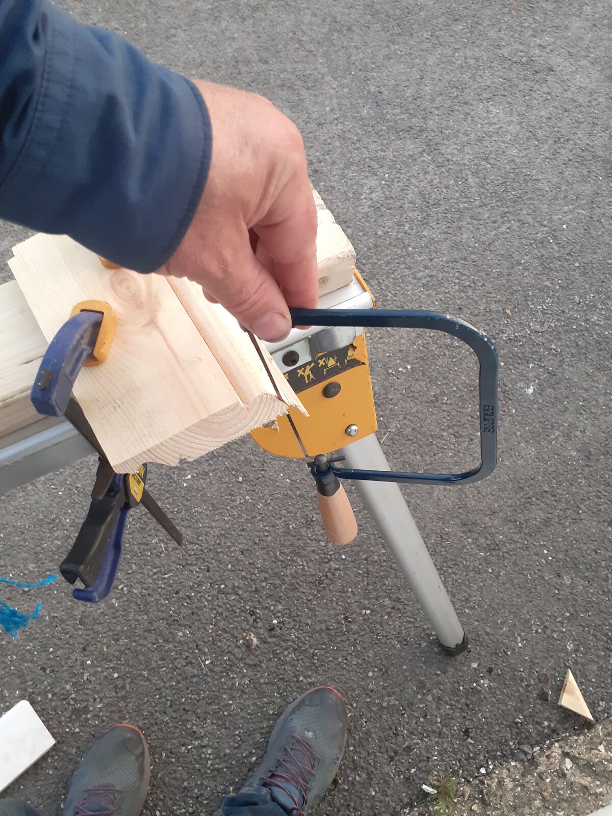

When cutting out the scribe at the top of a bull nose or whatever I seem to chip the thin top corner off. Shall I cut outwards or start from the top or just be more careful?
Set your coping saw blade so that the teeth point towards the handle - this makes the saw cut on the pull stroke. (I am now going to be told by loads of people that I am wrong - those people have obviously never used a fret saw or a Japanese saw, that's for sure) Doing this means that the blade is in tension when cutting (i.e it is stiffer) and will therefore run straighter/cut truer on a pull stroke. If you learn to use it like a fretsaw, with the finished surface uppermost and clamped to something sturdy, and with the handle below the material, making a downward cut, you won't get as many blow outs - and if you do get a few they will be on the underside (i.e at the back of the material) where they can't be seen. Only downside is that it takes a bit of practice to master this technique. I also use a similar technique with a jigsaw and a Collins coping foot
Start your vutd at the top snd limit your cutscto just past the start of.the straight bit. Remember to put a small bit of undercut on it. A rat tail rasp csn be useful.if doing largd numbers to clean up cuts that are slightly out
Cut the straight bit with a fine handsaw, again with a few degrees of undercut (or if really proficient a portable curcular saw, mitre saw or jigsaw can be used). This is the section you may need to recut to handle out of plumb skirtings

I had a go at cutting on pull in photo.

How did you find the down cut approach? Slightly more awkward to do, but more controllable cut and less breakouts?
On the issue if coping saws and blades, cheap Chinese coping saw frames are carp. A good frame costs relatively little. Yours looks like an Eclipse (Spear and Jackson) but other good makes include Bahco, Ohlsen (American), Stanley and Irwin. All these manufacturers make decent quality blades - avoid cheap Chinese ones because many just don't work well. Best blades I've ever found are Pegas

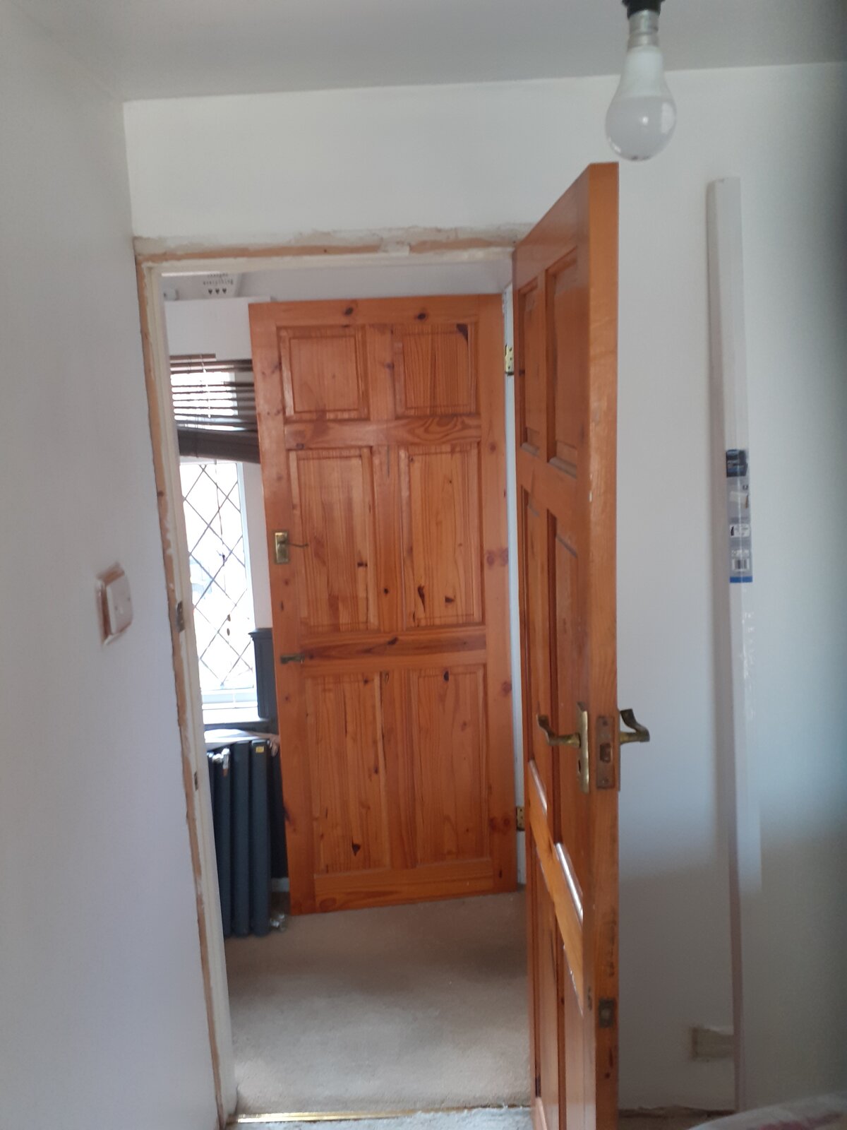

The architrave on the right isn't on a flat surface. Should I chip it back level? Cand butt it up to hinge? On left I guess need to cut it thinner to fit
