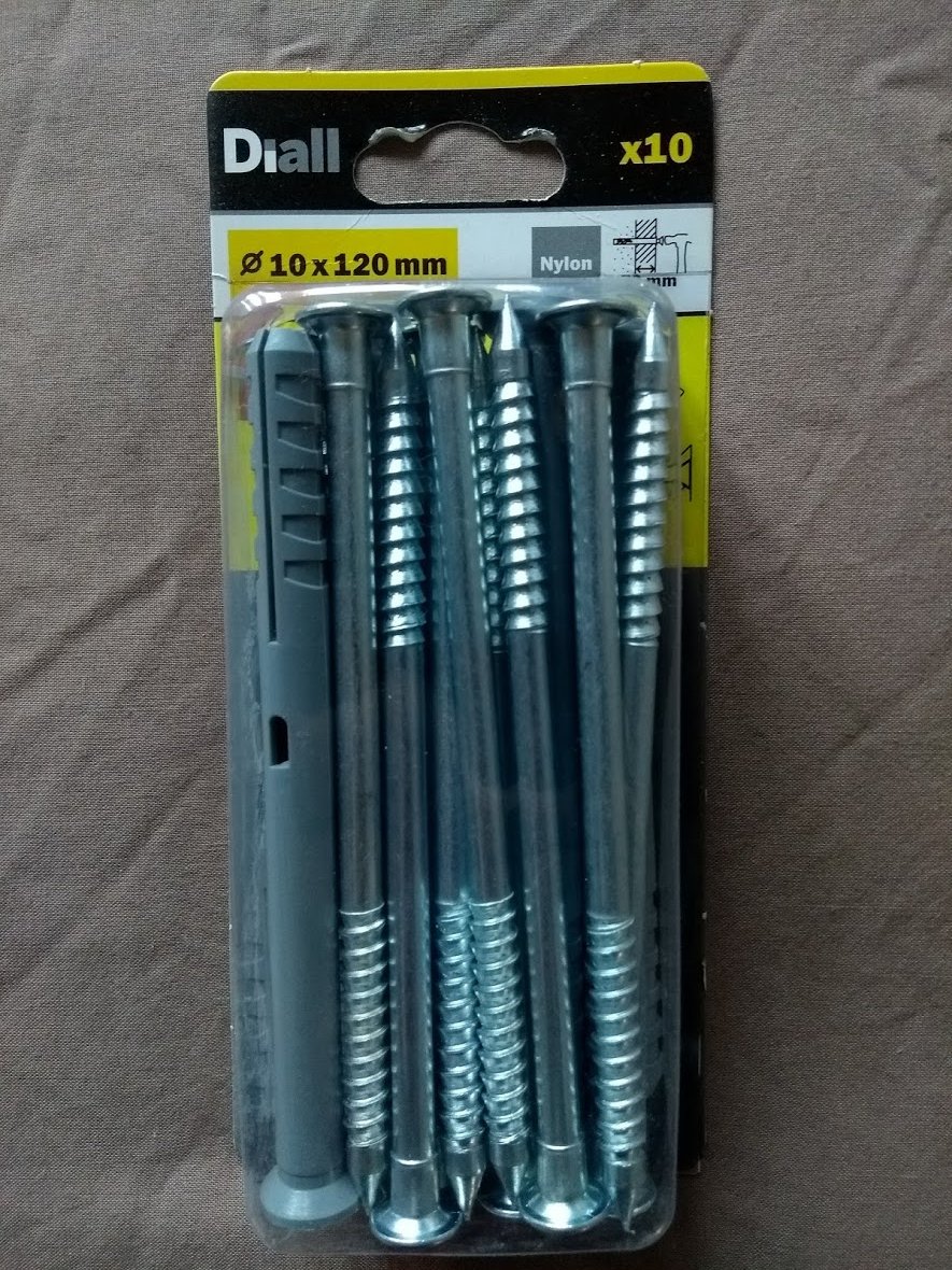

Fixing insulated plasterboard - general advice
Yes you just hammer them in. Screw head is only for unscrewing if necessary.
Re depth into wall - if it were 40mm into brick I'd be reasonably happy, but I suspect your wall is 25mm of old plaster and then 15mm of brick, or actually mortar if you hit the wrong spot...
Personally I'd be happy with that head shape to fix plasterboard, after all plasterboard screws have a countersunk ("bugle") head. Some care is required not to over-tighten (over-hammer!) and damage the surface of the board. If you go for a head that's flatter then the screw head will sit above the surface of the board. Are you planning on skimming? How much head thickness will that hide?
You can get special fixings with a huge flat washer head, possibly plastic. (Do a google image search for "mechanical fixings for insulated plasterboard"). I think they're mainly used for (a) holding just insulation boards without PB, (b) when there's no adhesive and you're using many fixings and the heat conduction through the fixing is a concern. I think they need to be skimmed over. I suspect that the plastic ones will not survive a fire, and remember that's the only purpose of these fixings.
Well, Toolstation had none I wanted, Screwfix did not have those Fischer ones (they were remarkably unhelpful), so got these from B&Q. More expensive per screw, but I don't need many.
My plan is to fix them along the line where I'll put a new picture rail, so it should not matter too much if it looks a bit messy, or if they stick out a little as I can always shave a little off the back of the rail where the screws are, if needed.
Screwfix, unbelievable.

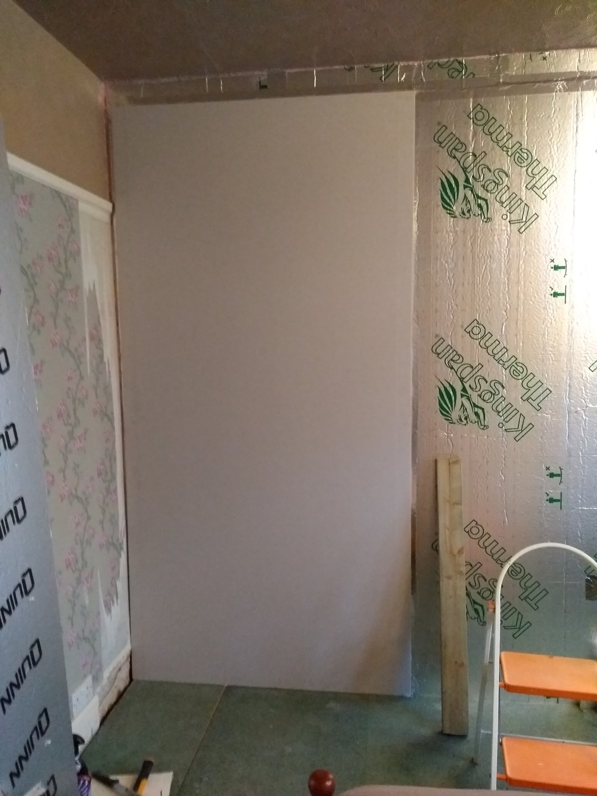

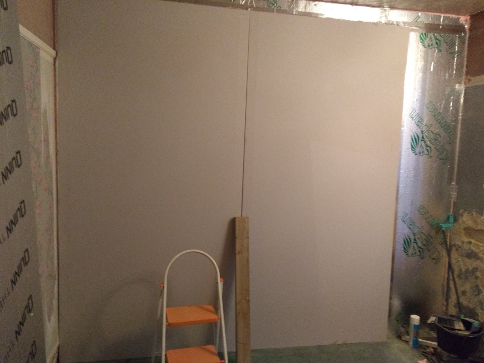

First bit of plasterboard is in the wall! Either wall or floor not straight, so there's a gap. Do I just cut bits it board to fill in?
Use bonding. I'd stagger the boards, and fit the next one towards the top - or at least put it up there and check the levels first.
Ah, too late!
I'll keep it simple. Next time, if there's a next time, I'll stagger a bit!

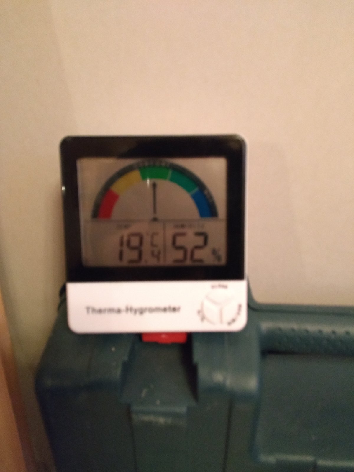

Room staying warm and dry. Window on latch for ventilation too, thermostat on 19, so operation seems to have been successful. Mostly cosmetic finishes to do.

I'm guessing it's too late but you can foil tape all the joints in the insulation after foaming as a belly and braces on the vcl/airbarrier. We did that on the floor insulation and it worked a treat, although don't but screw fix version of the tape.
Yeah, just foiled a bit more actually. If there's a join, it gets foiled.
