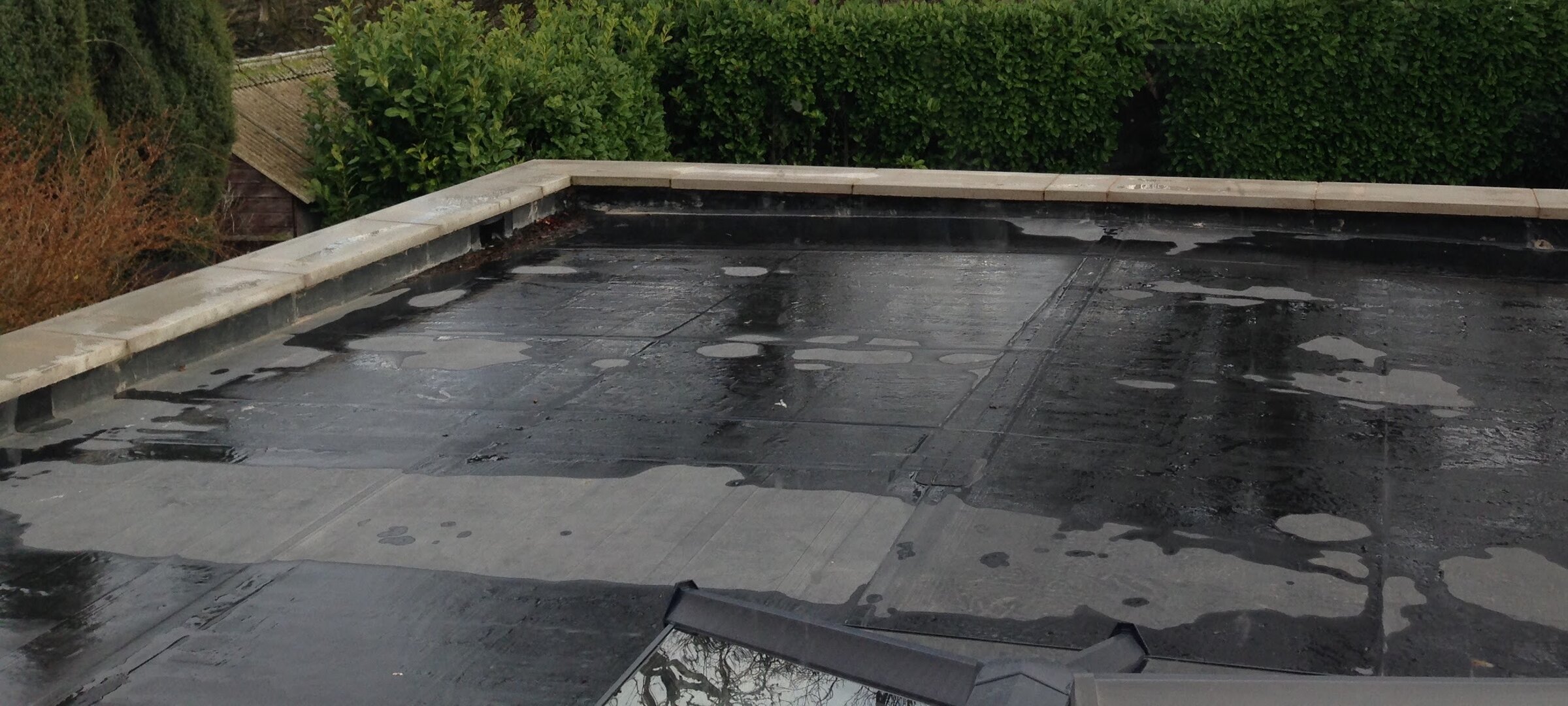

Flat roof fail
@sxturbo thanks I get it, as I said, clearly we've been far too trusting and accommodating but have been on their case repeatedly but maybe not forcefully enough. This is not some cowboy builder though, they have been trading under the same company name, his own name in fact, for over 20+ years with seemingly a good reputation and is quite well known in the area and done work on several minor celebs homes. The chance of him folding up shop only to open up with another name strikes me as remote. They might very well do amazing work 99% of the time, maybe its just my bad luck he cocked it up this time, but cocked it up he clearly did and for whatever reason is shirking his responsibility to correct the mistake. Getting the roof fixed properly and not just a temporary botch will require a proper independent inspection/survey as you suggest, which we're looking into. I imagine converting it to a proper warm roof is going to cost several thousands.
Yes it does have a parapet perimeter around the roof. In fact the roofer keeps complaining that the reason for the leaks is because the boss man refused to remove the coping stones as he asked so he could lay the felt underneath them so he had just to felt up to them.
Ah ha, bingo.
It's a parapet wall, no wonder your having so many issues.
The parapet is built and detailed all wrong and the roof has been installed wrong.

Parapet walls are expensive to do right and cheap to do wrong.

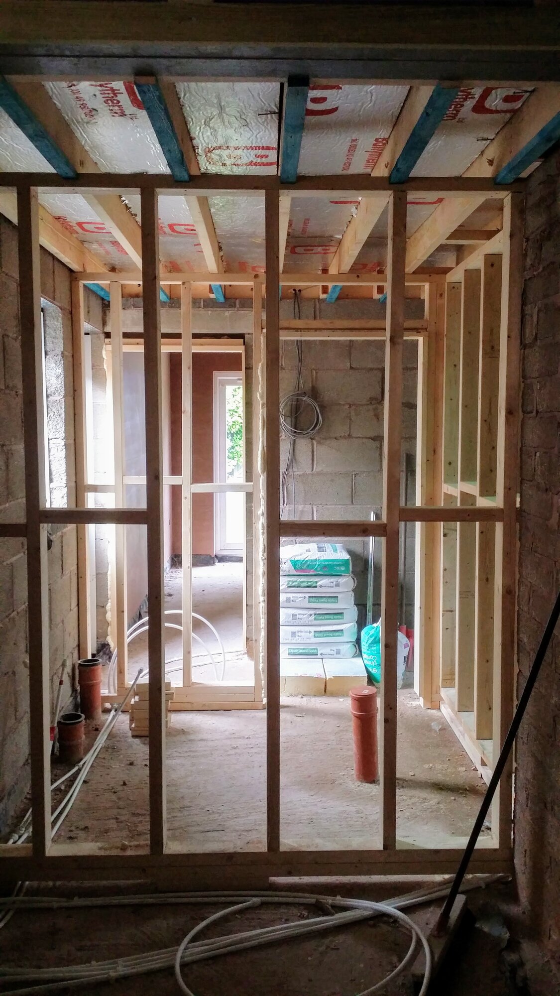

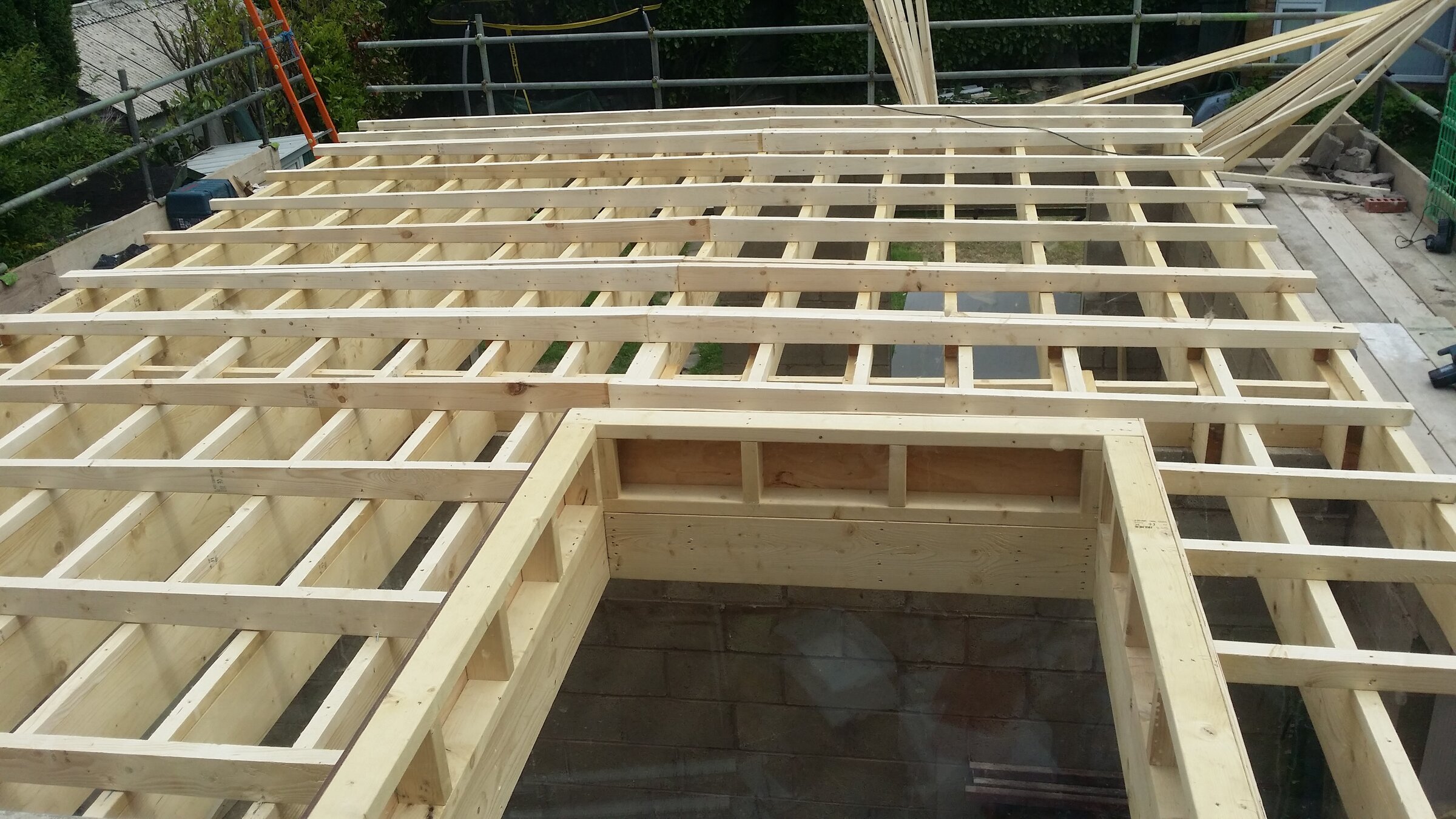

Funnily enough I watched that video about an hour ago! My understanding is that with a hybrid roof you have some insulation above the main deck which there isn't in this case. What we have above the plasterboard ceiling is no vapour barrier then an air gap of 100-150mm, the insulation layer then another air gap of around 50mm, then the deck and felt. Here's a couple pics (if they show up), can provide more if requested.

exactly what I feared - insulation has been done in between the joists flush to the top, then the firrings above.
What is sad is the carpentry is lovely and neat….and about as wrong as is possible.

To create a warm roof, we used small joists, then firrings, then 11mm OSB, then insulation, the deck - it’s tricky to work out because the firrings are below the insulation.
For your roof which has a small lantern and biggish span of joists, a cold roof is needed to keep the roof build up to a minimum. However cold roofs need insulation below the joists and make downlighters an issue.
Unfortunately your roof is going to have to be stripped and rebuilt, I see no other option for a permanent fix.
As it is it will continue to suffer interstitial condensation and a leaky wall cavity.

I can see the roof falls have been created using counter batten firrings.
If all the firrings were removed (including those sitting on the joists), then new firrings setout diagonally to the joists and thinner so they go down to say 10mm around the edge, then 18mm OSG, then a bonded 120mm insulation, it may be possible to keep the roof low enough for the parapet and have a warm roof.
That way you could have a new roof without affecting the internal ceiling.

One other thing worth mentioning, the roofer who came out the other day also pointed out which I hadn't so far noticed was that the paintwork all along on the outside render at the top of the wall in the area just below the coping stones was becoming powdery. He was a little sheepish pointing it out, probably concerned if he was giving me more ammunition to use against his employer. But clearly another sign that something was very wrong up there.
