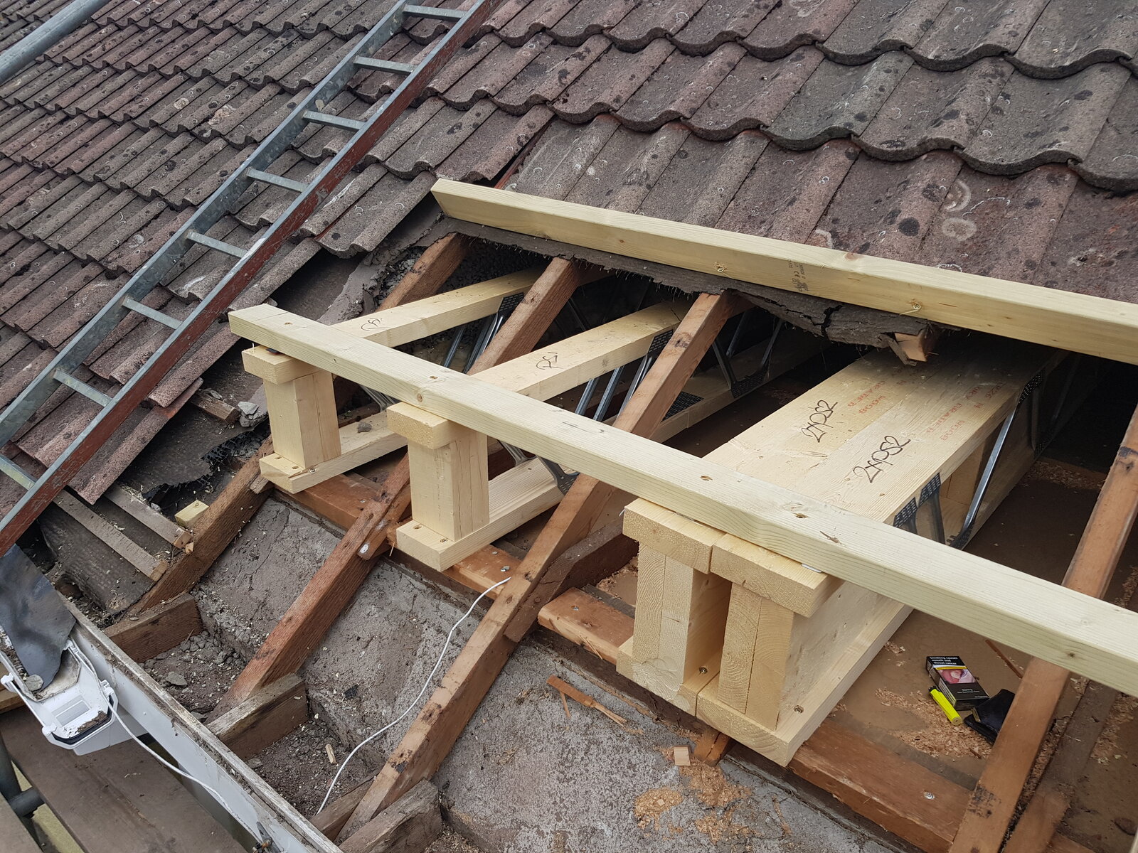

How about these monsters;
Not sure what they'll spec', but we once used these monsters on a 7m+ span...
440mm deep with 125mm top and bottom chords!
We use Posis on all our floors.
Out of curiosity, why are the 'monsters' sat on little block pad? instead of say a wall plate?

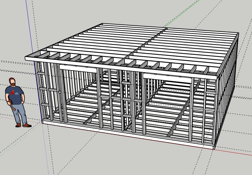

Here a quick update.
Struktural Engineer wants £1200 to calculate, but that would include walls as well and technical drawings.
I got a calculation from a Posi Joist manufacturer near by, 600 center would be £1224, I guess 400 center would work out as £1632
I have now remodeled the shed a little, i was putting in a dividing wall half way through the building in joist direction, so i make that a load bearing wall and run the joists the other way. The span is now only 3.1m so 45x170 would be enough and the cost will only be about £440 with 400 center.
Thanks for all your suggestions.
