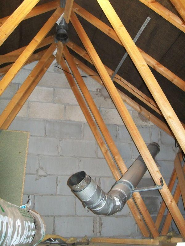

Resurrecting a thread from the past, I have a new twist.

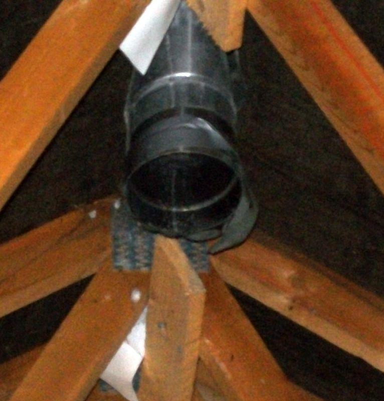

So it came round to gas safety checks time again, and this year the flue for the gas fire just wasn't working right. The smoke went up the flue, but didn't appear outside. Even after a second smoke bomb.

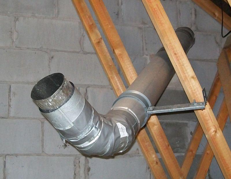

Looked in the attic, and it looks like it's had a smoke bomb let off in it. See if you can spot why :rolleyes:
And as a reminder, this is what it looked like 3 years ago :
So next week I'll be having "a conversation" with the people who did the work 3 years ago, and I suspect the manager there might be feeling a tad uncomfortable when I've finished. Luckily the tenant hasn't actually been using the gas fire, and if she had been, it's a fairly well ventilated loft so it's unlikely that anything serious would have happened.
Inadequate fixings, always needs a minimum of two or more fixings for flue pipework (fulcrum come to mind). Difficult to see fittings are correct from photo though. The fittings and pipework should have the makers stickers on and usually not interchangeable with other makes.
If its an approved twin wall throughout, the tape is not needed unless the manufactures state in their instructions however some put this on and rely on it to hold the pipework together as it seems in this case.
It is ID as you may well be aware, riddor if you like. If installation company drag their heels or you are really ****ed off get Gas Safe involved as soon as possible they like evidence "as is".
This situation shows the importance of having every gas appliance checked yearly and the occupier upstairs was very lucky.
Just to add to the above comment this is untrue, everyone has been very very lucky that's why most gas appliance have flues that directly terminate outside to atmosphere.
OK, I'll clarify what I meant. There's a large space in the attic, the gas fire would only have been used intermittently if it had been used, and the attic is well vented - there's a continuous soffit vent along both sides (vary large total vent area). There's aren't any significant gaps in the ceiling, so any POCs would have to permeate through the plasterboard to get into the living space.
So while it's clearly a very unsatisfactory situation, it's a very far cry from something venting into a closed (unvented) space (where it would accumulate and/or restrict the draught up the flue), and with lots of gaps and cracks to allow the POCs to leak into the bedrooms - or even worse, a non-flued appliance with the vents blocked up (see other threads about that here).
