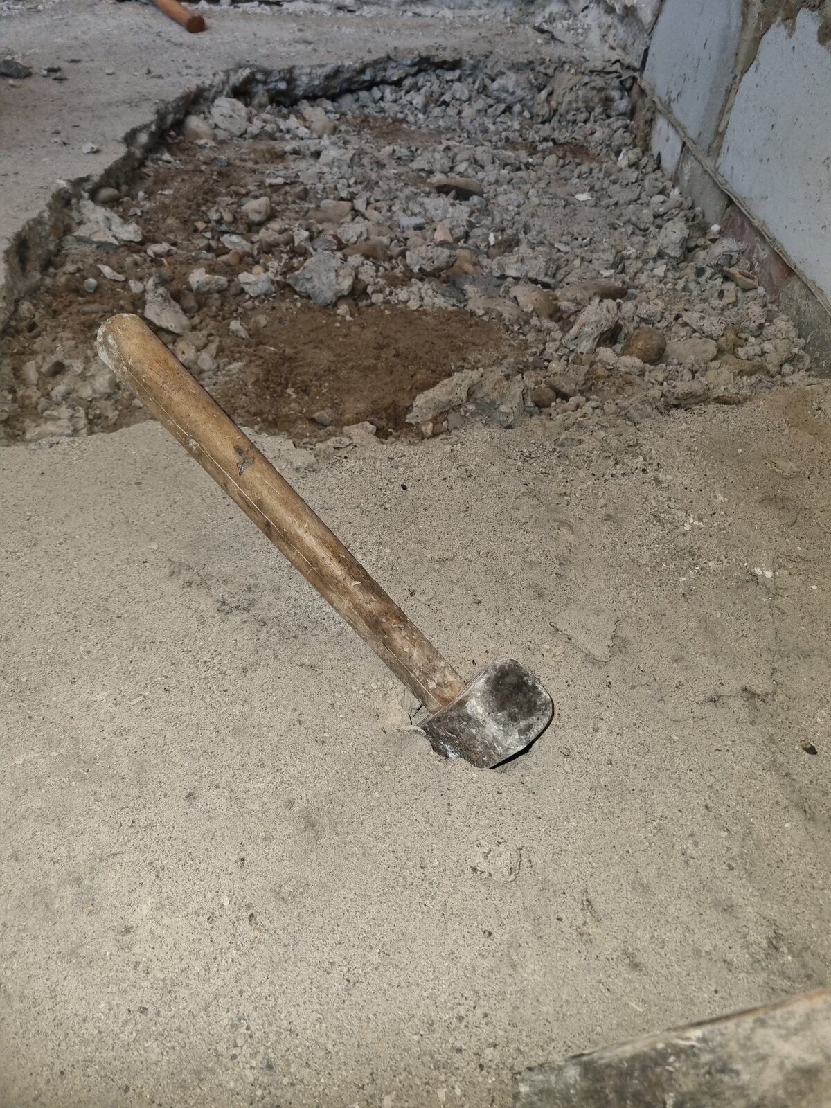

Well, I decided to remove the screed, (it's going to provide hardcore for a driveway)
This is the concrete below, it's a bit thin!
This was a kitchen with a back door, with a very heavy concrete lintel above. When I removed the lintel, I just broke the bricks supporting it & levered it out, allowing it to fall onto the "concrete " floor, where it punched straight through the screed and the concrete.
I'll decide what to replace it with once the skim of concrete is removed.

That floor looks like complete junk to me. The way that hammer punched through suggests they probably used one bag of cement for the whole room. Get it all out, dig down and do it right, have no issues or worries in the future.
