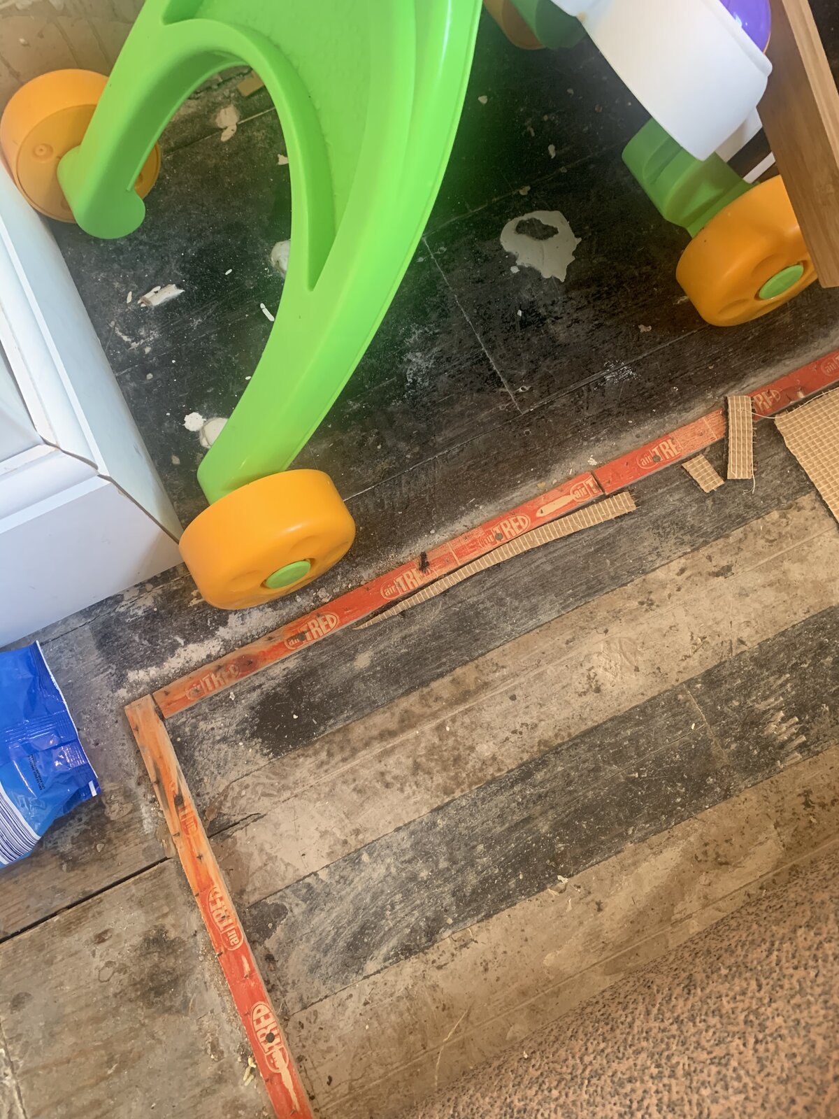

- I have a kind of stained but around the outside of the rooms. See the darker wood (it then turns into stripes of stain). I am confused what this is, I thought these homes in the 30s would have been carpeted - was this decorative wood stain? Anyway, can this be sanded out? Can it be taken off with solvent? Can I just turn the boards over? Or, can I just put new boards in? How do I get this looking neat when the eventual sand and varnish is done? Or should I just use the paint stain stuff so it all looks the same?

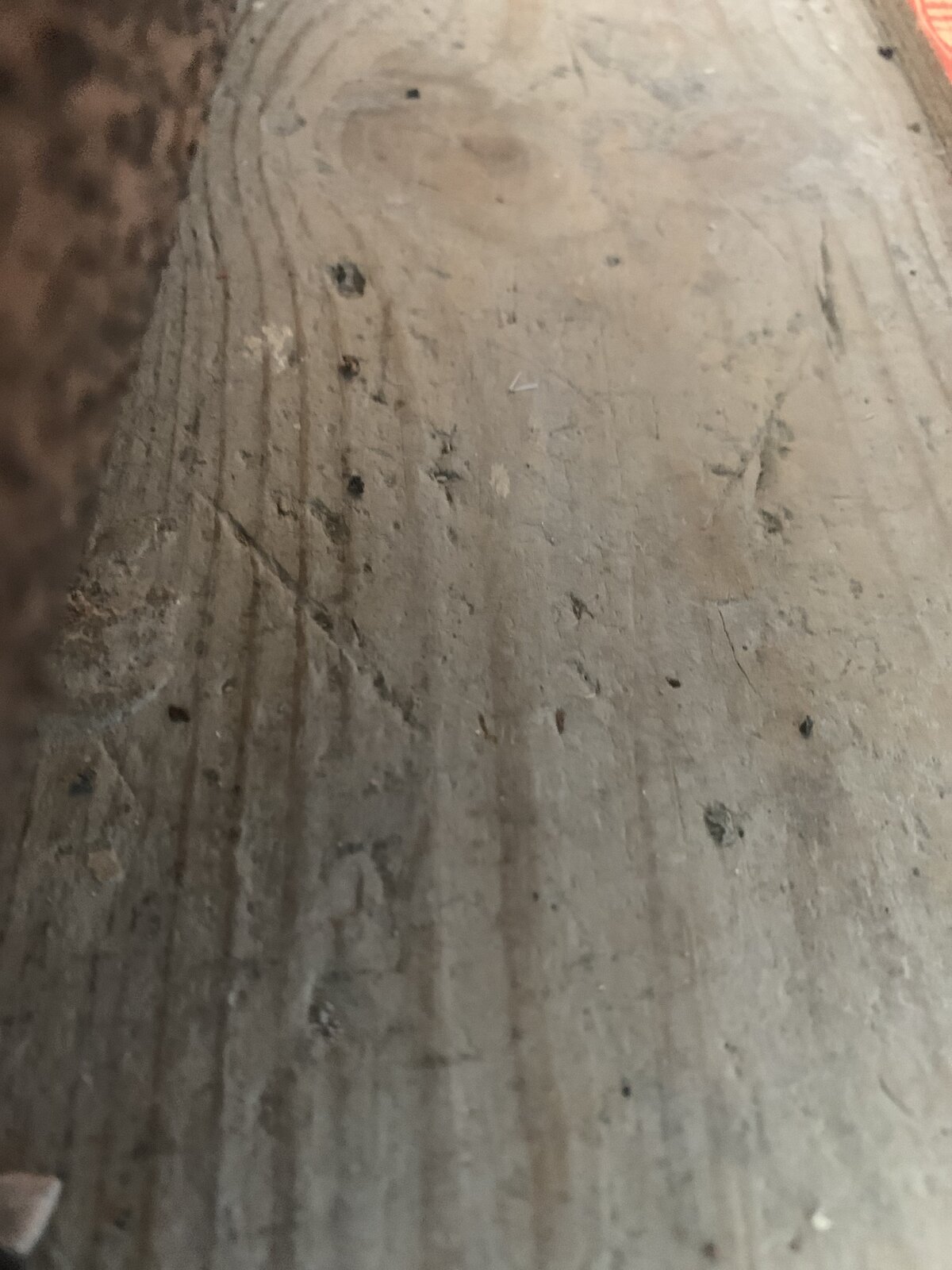

sexind question - do you know what type of wood my boards are? I think the joists are oak. Any ideas?
Some of the boards have some holes and damage so I need to know wood type so I can put a bit of wood filla and stain in there.
In the 1930s you'd have possibly had lino in the "working" rooms, like kitchens and toilets, and rugs which didn't reach to the edges of the room in other rooms. The resulting margins around the edges of the rooms were often either stained and lacquered or painted. This stuff can be difficult to sand out. AFAIK fitted carpets really only came in in the 1960s
If you want to take out the staining and sanding hasn't worked you may be better off looking at a 2-part wood bleach which will completely remove colour (to the point where you may feel the need to put a light stain on to get some colour back). As ever with this sort of material take all the recommended precautions and treat an unobtrusive test area before going "hog wild"
Your floorboards are pine. In the 1930s I'd suspect Canadian in origin. I very much doubt that your joists are oak - it was simply too expensive, even then. More than likely the joists are redwood (pine). Even in imposing Victorian buildings such as banks the beams and joists are generally some type of softwood (or at least all the ones I've worked on have)
