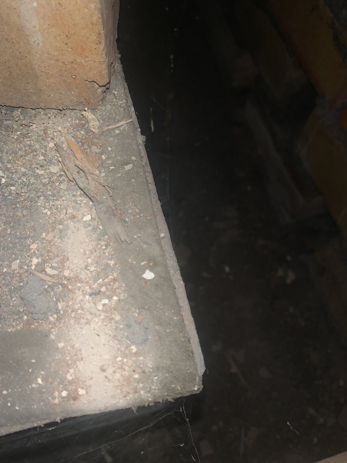

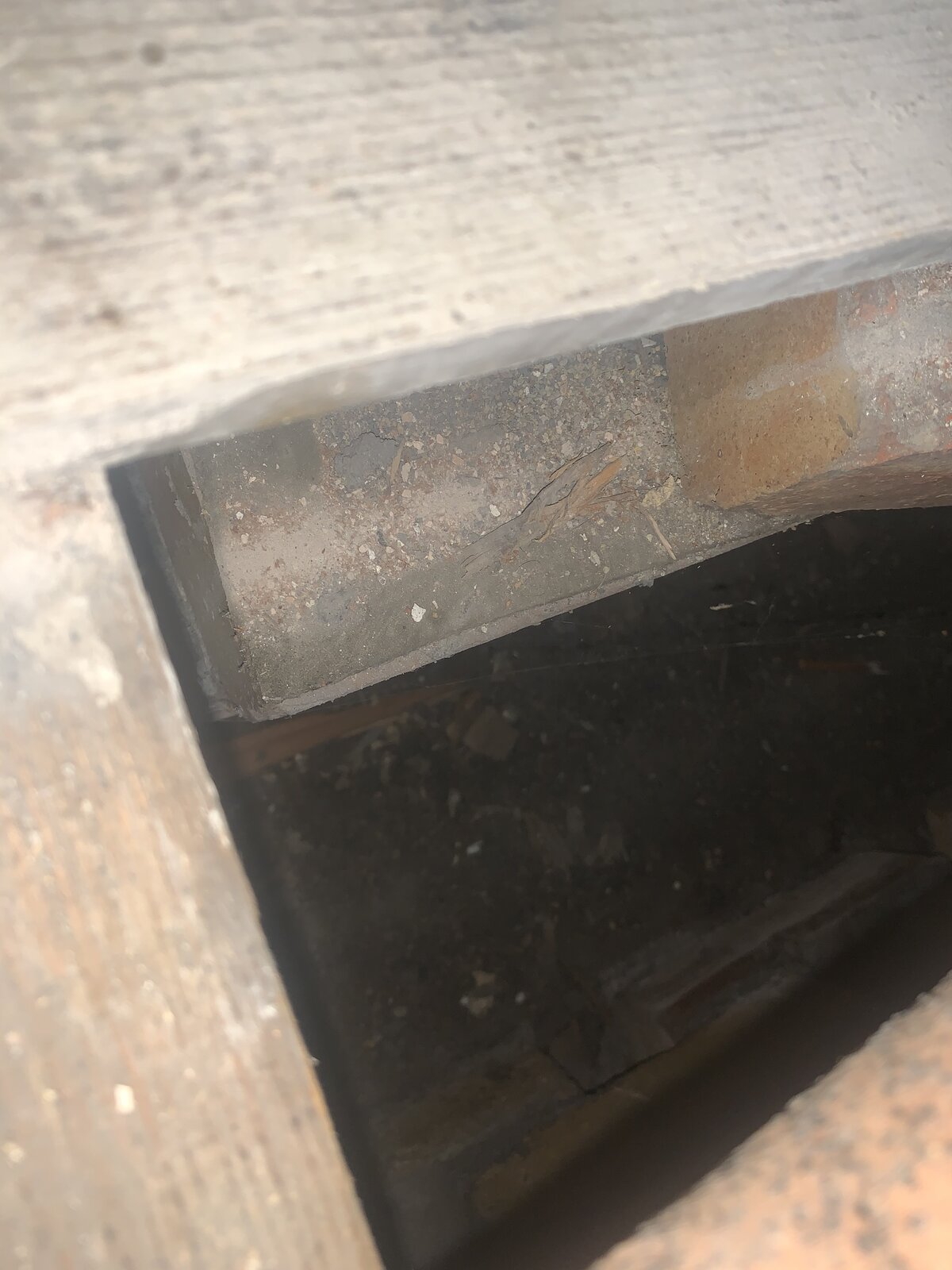

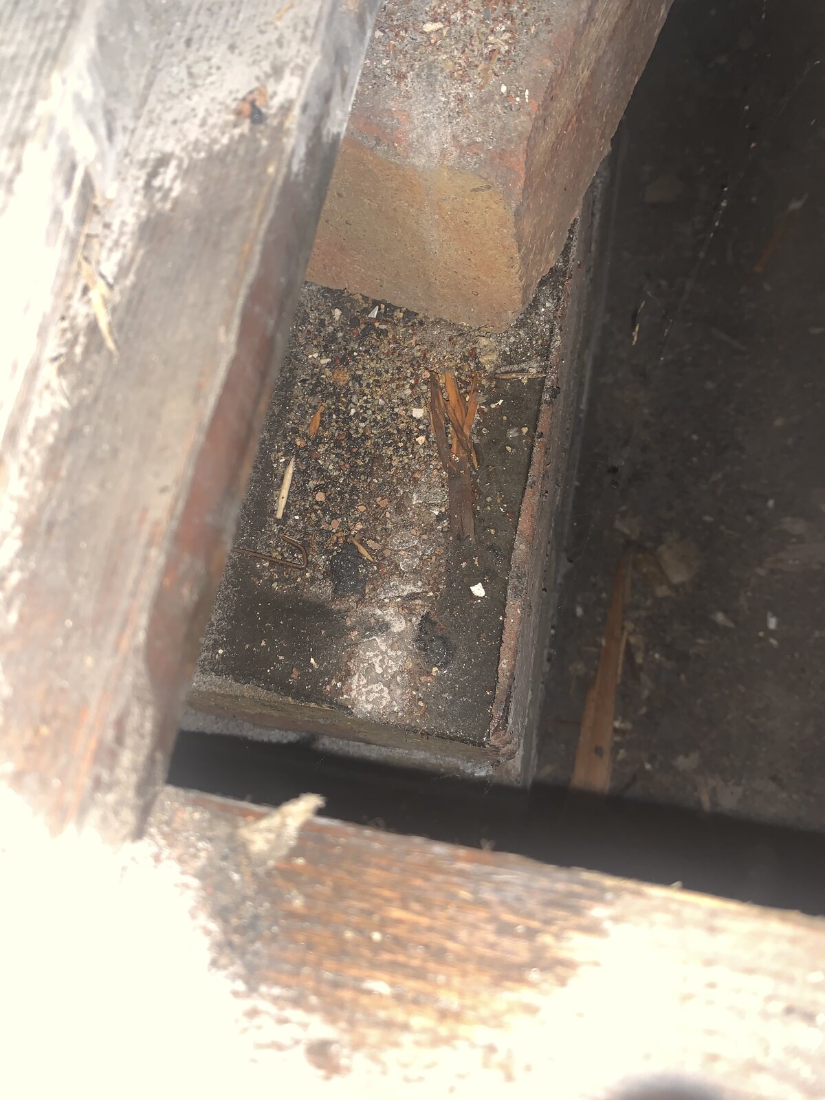

It’s not quite how I remembered. This is it.
I just don’t think really know what it is and what it’s there for and if it’s not asbestos or a fire retardant, what is it?
doesn’t look like the typical asbestos board I’ve seen in pics.
I can see them, but I don't know what it is.

Maybe they used it as shuttering to cast the concrete slab.

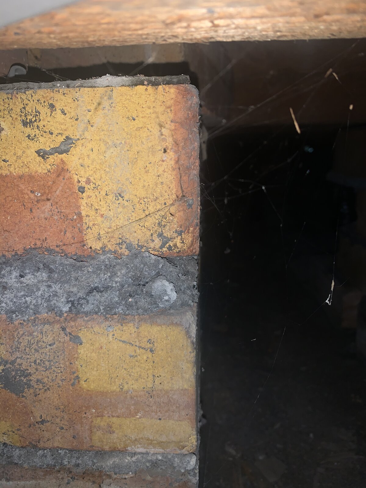

spray some water on it and see what colour it goes.
slate is very smooth on the split faces, but the edges are sawn.
here’s a pic. I sprayed a LOT of water on it, seems like it is slate.
against my better judgement (it’s so wet I can’t see how fibres could get airborne anyway) I tapped it lightly with a screwdriver. It’s hard, I would say the same as tapping brick.
not asbestos board right? That would be softer and wouldn’t make a tapping sound from a screwdriver?

Asbestolux in 1939? Earlier than I'd have thought.
photos would be useful.
They started using asbestos sheet in construction about the end of the 19th century, commonly used in council buildings (houses, schools, offices es, etc) from the early 1930s onwards. Was widely regarded at the time as a miracle material - but then the Edwardians put radium in makeup and drinks....
Lot of Asbestolux was put in as retrofit in the 50s and on. Just because the house was built in 1939 doesn't make everything original
OP: asbestos is fairly soft, cement asbestos is hard and brittle

well, see pic, it went slate coloured when wet and tapped like slate would....think it’s safe to say it’s slate? It’s almost black when wet, I thought AIB is white, I had it in parent home and it’s like a kind Half plasterboard half mineral fibre look to it....

is it safe to pull up the floorboard to look with my child in the house? It won’t disturb it but I am worried it may pull a cloud of dust up or let fibres in.
Yes. In a house which had coal fires you'll possibly disturb a bit of soot and lime plaster/mortar dust, that's all.
You don't get much asbestos used in mortar, nor in plaster, fortunately. If it were common I'm sure I'd be dead by now! Asbestos cement was made in sheets (flat and corrugated) and pipe form - grey to white in colour. Pure asbestos sheet is generally white - it was often found as boiler lagging and in airing cupboards in older council properties, although these days most of it has been removed
