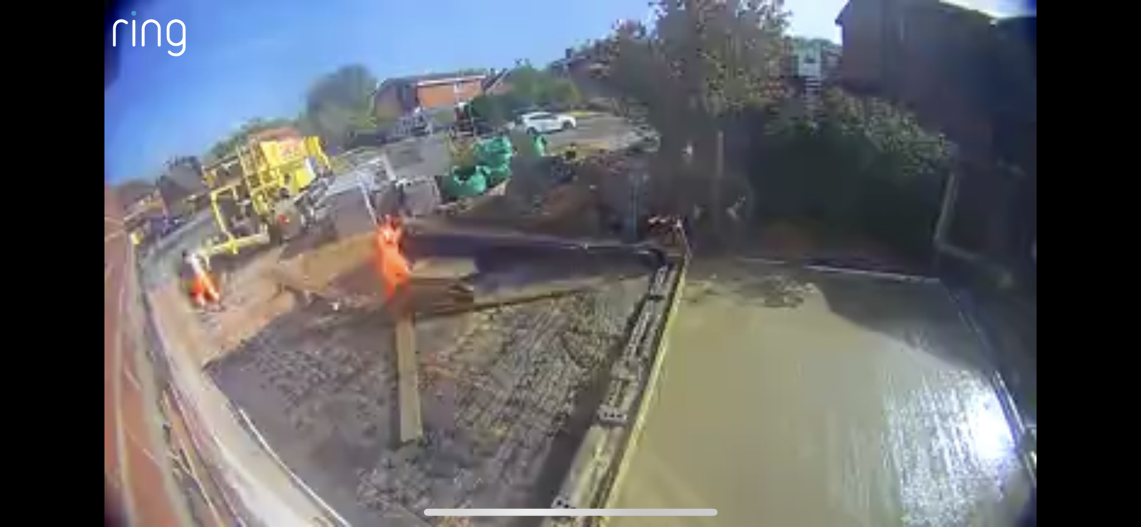

Do concrete wagons back onto a residential driveway or is that a no no. It would be nice if they could shoot straight into the footing. We need just under 3.5m3 so i would rather not have to wheelbarrow.
I had my concrete delivered a couple of weeks ago and the guy did park his fully loaded volumetric wagon on the drive - but only after I gave him repeated assurances it was ok to do so as the driveway was getting replaced.
It did make a mess of the driveway to be fair, and having dug some of it up before I know my old drive is really solid to start with - lines of thick council path pavers surrounded by concrete with a thick hardcore base.
I think you’ve got block pavers from your other threads - I guess it depends how good the base is, whether you’re planning on keeping any of the drive afterwards, and how contentious the wagon driver is.
ps - the firm I used supplied a barrow boy and between him and the driver they did all the barrowing :)
