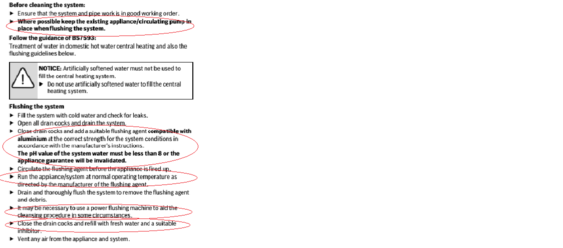

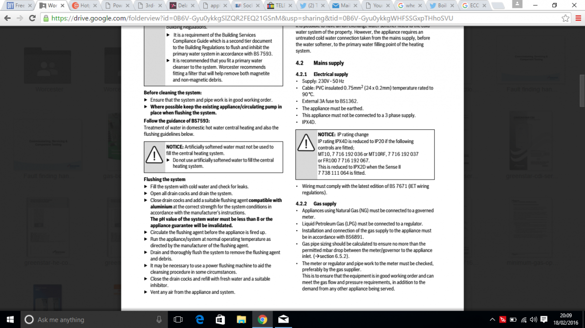

From the Worcester Install manual. Note that the requirement pre install from Worcester is to comply with BS7593.
I agree that he shouldn't fit to a dirty system but this could be checked at survey and should be carried out at the cost of those wanting the boiler.
Are you purposely being dense? it clearly states in the page you've posted that the system must be chemically flushed pre-installation in accordance with manufacturers instructions. You're obviously a cowboy yourself if you think its a good install.
Please highlight the specific point where it states that it MUST be done before fitting the appliance. I can point out two points straight away that let you fit the appliance first.
I'll give you a bit of time to read it through properly. I'm just popping out to feed the horse :whistle:

I paste the relevant bits of the page (you didnt post the top bit)
4 PRE-INSTALLATION
NOTICE: All the following pre-installation sections must
be read and requirements met before starting the boiler
or flue installations.
Close drain cocks and add a suitable flushing agent compatible with
aluminium at the correct strength for the system conditions in
accordance with the manufacturer‘s instructions.
The pH value of the system water must be less than 8 or the
appliance guarantee will be invalidated.
If the canvassers told the poor old OAP they would have to pay for a powerflush and a mag filter before they got their "free" boiler, how many fewer OAPs would sign up? I suspect the installers don't expect the OAPs to recognise a poor installation or to be alive when it all goes wrong. The doorstep canvassers are probably only on commission for every gullible OAP they get to sign on the dotted line so they won't care. I have a 92 yo mother who signs up for things like this because she hasn't got what it takes to say "no" . Companies and charities etc who exploit the elderly and vulnerable really p*ss me off.
My mother got signed up with BG for a new boiler because "parts aren't available " for the old one. Top money but amazingly a RGI who serviced it a few weeks ago thought they'd done a good job on the install
1. Where possible. Does not say that it MUST be used
2. Why would it have to be compatible with aluminium unless they want to ensure their aluminium hex is OK
3. If you had a broken down appliance how would you achieve this?
4. Can still use a machine after all that and you still can't get pH level right you can then power flush!
5. Why add an inhibitor if the boiler wasn't fitted and you were doing all of this on the old boiler.
As long as all the above are complied with then you have achieved this:
Now again,please tell me where it states that it MUST be done before fitting the boiler.
I'm not arguing that it isn't best practice and I personally wouldn't but the M.I's do not demand it be done. They caution you of possible damage and say you MUST read the sections and ensure that they are followed.
Now answer my questions that I asked previously that you have skirted around.
