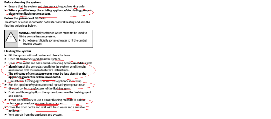

1. Where possible. Does not say that it MUST be used
Sorry pal, but you are plain wrong. Quite embarrassingly wrong at that. The whole section is titled in capitals PRE-INSTALATION (which you conveniently keep omitting from your screen dumps) . And now you're inventing the hypothetical situation that the old boiler had broken down?? well it hadn't.
How do you explain the fact that installer didn't even leave the chemical flush in for the minimum amount of time as recommended by the manufacturer? Or is that alright too because it was 'free'??
No again where did I say that? You have this habit of hearing whatever you want to hear without actually listening to any facts.
M.I's are written covering all situations. How many boilers are changed because they are faulty? or do you believe that the M.I's are somehow specific to your situation?

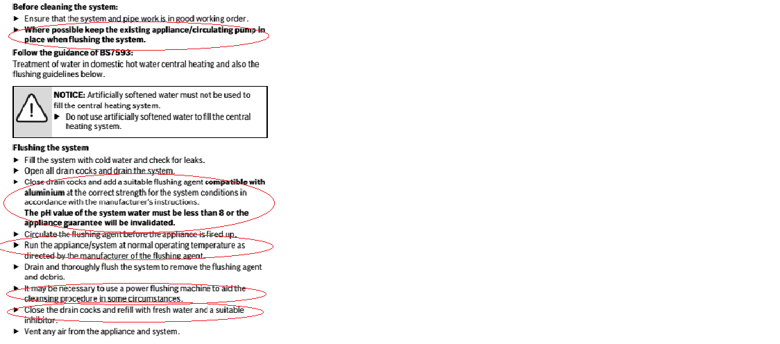

Nothing omitted just that PDF pages in that are larger than the screen so I showed the actual relevant parts that you need to do to comply with M.I's
I've never said that or commented on the length of time it was ran for. I couldn't comment as firstly it sounds like the wrong chmical for the job and secondly I don't have TDS readings for your mains incoming water and TDS readings and pH readings for system water.

Not going anywhere. Not saying any of the above is best practice and I always would but M.I's don't demand it.
If boiler faults in the warranty period and the system hasn't been flushed but TDS falls within 10% and pH levels are right will they warranty it? They only ask for a clean system.
Sounds like the OP's isn't clean but thats not the point I'm arguing

The whole idea of properly cleaning out an old system prior to a new boiler install is to ensure to minimise the risk of the shiny boiler becoming contaminated, that includes cleaning out the rads. As Muggles mentioned - this is a manufacturer and BS standard that should be followed. If it is bad enough then it would also need powerflushed.
Using a mallet has only loosened the sludge and allowed it to move around the system, it will reappear, hopefully not in the H/E (s). That is not a fix!!
I hate to think how many systems have been fitted where they haven't prepped it correctly and the owners now have issues that the manufacturers wont warranty.
Again, as D_H mentioned, if they aren't forthcoming I'd be getting in touch with WB and see if they would be prepared to help with a site visit.
