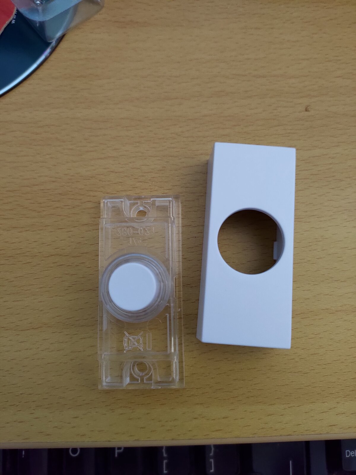

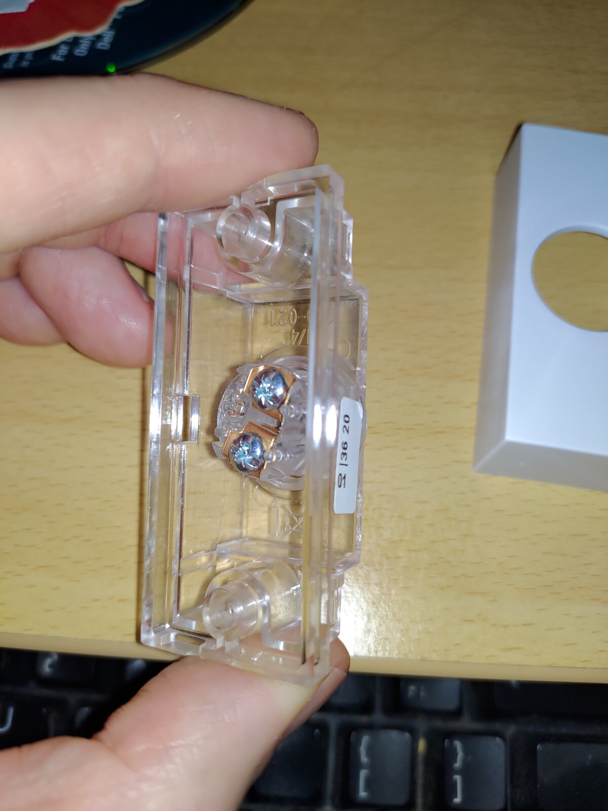

This is the Bell Push I have
It's just a dinky little bulb. The packaging says 8v, so I guess having an 18v transformer is gonna cause issues right?
Yup. I seem to remember replacing mine with an led and a series resistor, but I can't remember whether I finished the job or not. It's very fiddly.
