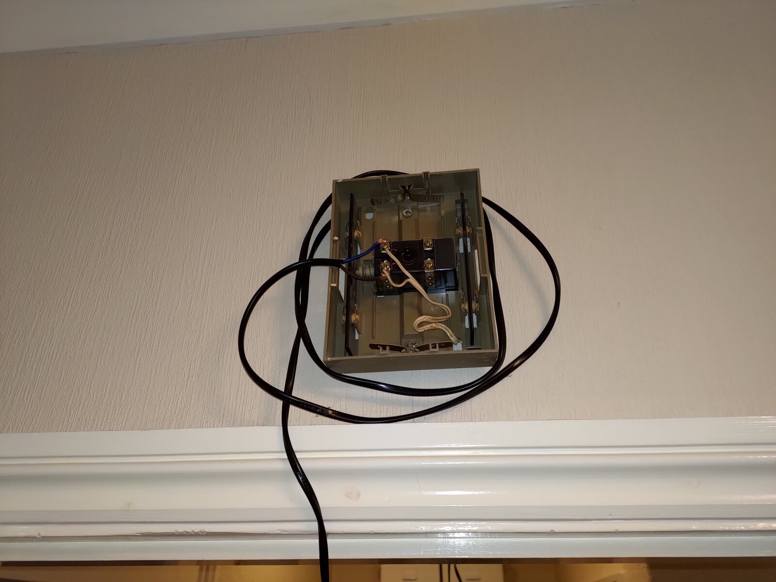

So I have temp connected the 2nd Bell Chime from the terminals within the 1st Bell Chime, and I can now get the 2nd Chime to quietly Dong (it doesn't Ding!).
Am I right in saying that is due to the length of temp cable I am using (and a 2amp Transformer would fix that problem as you suggest?).
Of course, the above is superceeded by the fact I cannot get to the wiring that goes from the 1st Bell Chime to the Bell Push, as it is all buried under plaster and within the frame of my new Porch! Bugger!
Is there any way around this?

Yes it is wired as in that diagram, and as requested I disconnected one wire in the new 2nd Bell Chime and with that wire disconnected, the 1st Bell Chime doesn't work. Connect it back up again and the 1st Bell Chime works again.
Does that imply amps then? Or something else?
Do you need it to be a Ding Dong, I believe its the load of the clunky solenoid thats draining the power, not sure how you get A Ding without a Dong:), as the Dong is usually the Bolt springing back past its parked position, unless the bolts not powering out hard enough, i wonder if the spring can be tweaked without ruining the bell unit
Another option is fit batteries in and use the wiring to switch a small relay
