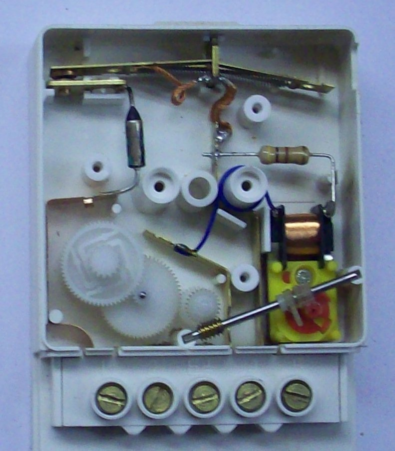

I've often looked, but have very rarely found :) (admittedly, I'm not familiar with Grasslin ones). As the pic below shows, it's certainly not possible with the ubiquitous 'bog standard' Smiths/ Timeguard/ variants/ copies - the L feed to the motor comes from close to the contacts, deep inside the device. Indeed, even if one was prepared to undertaken surgery which went well beyond what one could expect of an average DIYer, there would be some bodging necessary, since they usually don't even have enough terminals for 'volt-free' use. There's usually just five - an L&N in, an L&N (L switched) out (the two N's being 'hard linked') and an earth. If one wanted to convert it (or most others I've seen) for 'volt-free' use, one would either have to try (assuming both motor supply and load were on same circuit) to unlink the two N's, and then use one of them for the required additional terminal, or else sacrifice the earth terminal, and use something else to terminate the CPCs in. ... certainly not just a question of 'removing a link :)
Trivial but IMO not professional. There us little excuse to not get a volt free type, and let the photocell stay powered (how it is intended).
