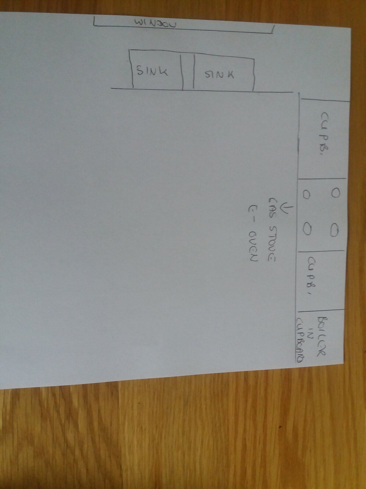

Can you show us the outside of the wall behind the sink please
And a pic of the cooker from the front
I think you may need to look behind the cooker to find out how big the gap REALLY is.

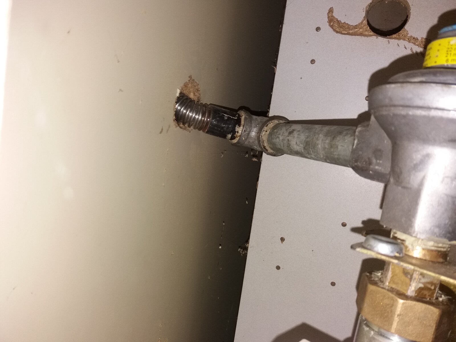

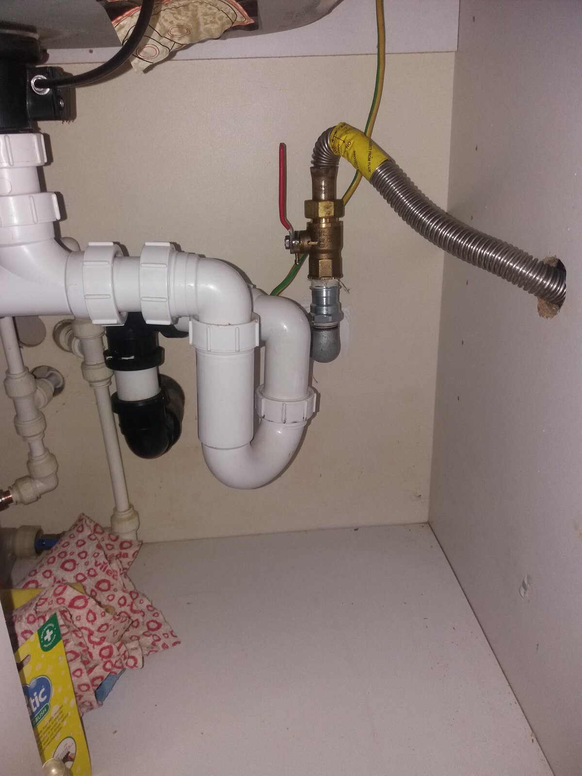

Where's that anaconda (Stainless Steel Ribbed pipe) heading to from under the sink and what does it connect to?
The pipe goes to the smart meter in the corner cupboard.

Just an idea: Could one run the pipe underneath the kitchen units and oven?
Thanks again for your help. Enjoy the rest of Sunday
