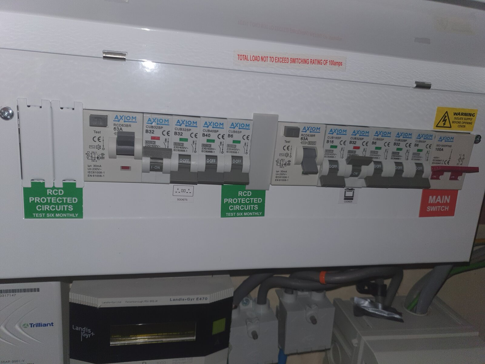

About 3 weeks ago I wanted to update my fuse box as its 1970s and everytime It tripped I had to wire the fuse , so an electrician came out to check to see if my electrics were OK to fit a new board, and he said it was fine. A few days later he came out and he took 4 hours and then after all that he couldn't get my lights working , only sockets , so I payed him 400 and he came back a week later to fault find and still couldn't get it back on, so he told me I need a full rewire even after paying 400 plus 25 quid to fault find. He told me he could do the rewire in 1 day with a team of 4 lads.
Anyone know what to make of this ?

Why can't he get the lights working?
Sounds like he doesn't know what he's doing.
At this distance I'll predict a borrowed neutral.
Taking bets...

Hi thanx . I get that I may need a rewire at some point as the house is 1972 and never had one. I got the fella from my builder as he had decent reviews. I've been left with 3 sockets hanging out and no lights for the past week or so , I've just had to use lamps.
the fact that the fuse kept blowing probably meant something wasn't right before he started.
post a picutre of the new CU with the lid open.
how many light circuits do you have ?
Why are so many MCB's in the OFF position ? Are they all unused ,no circuits wired into them ? Do you know which breakers are for your lighting circuits ?
I would also suspect borrowed neutrals are the reason the lighting circuits don't work ,does an RCD trip when lighting circuits are used ?
Yes he's said because this new board is sensitive and the wiring is old , the RCD keeps tripping . I'm not entirely sure what switch is for lightning but probably be one of which is off ( sorry bad joke) . It's come at a bad time for us as we've struggled to save for the new board and now it's going to cost is 3500 +
