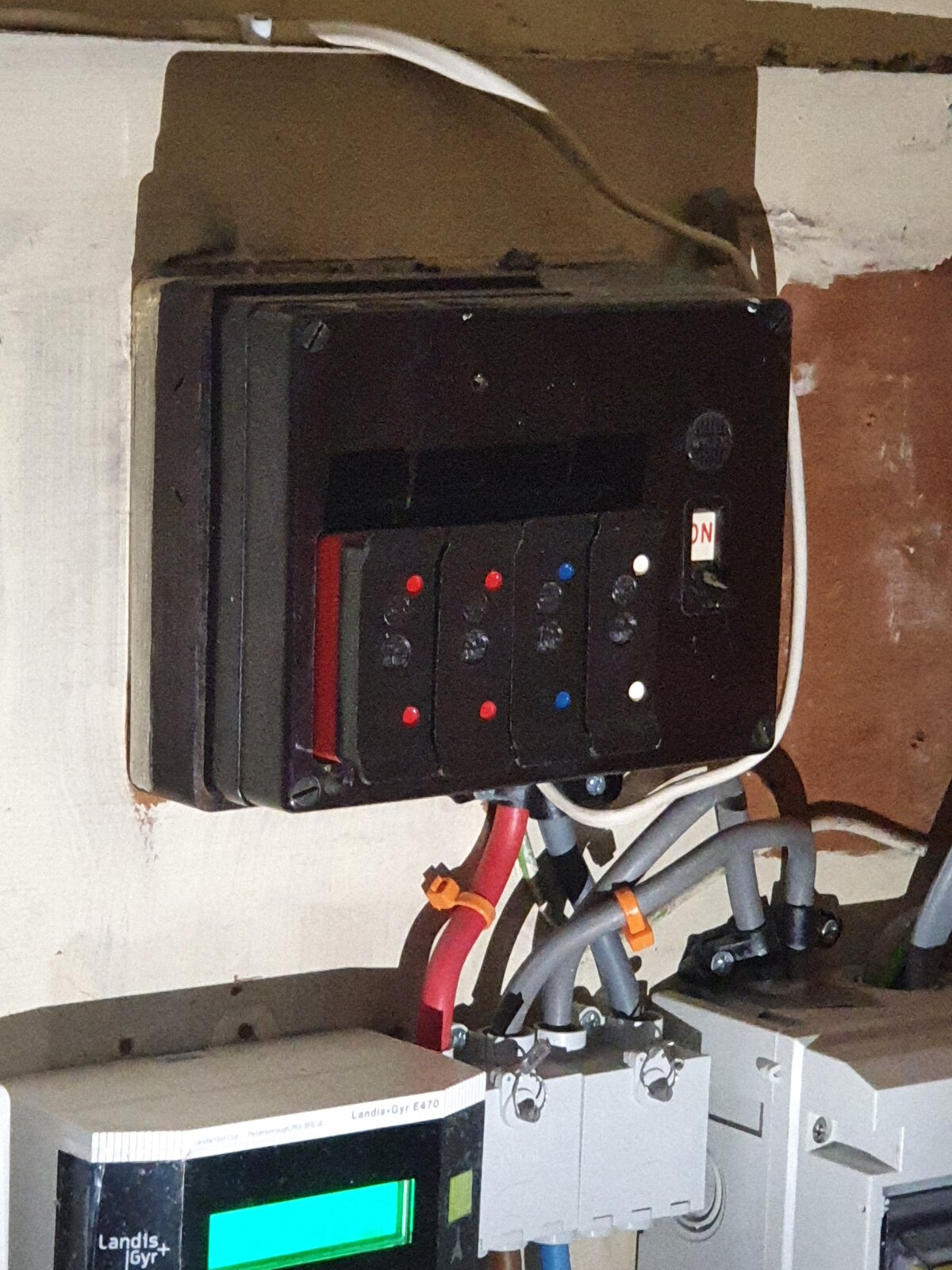

Surely you can't change for a consumer unit change if it's not working properly.
The unskilled guy probably expected he could make a fast buck, just swapping a CU, then found he was out of his depth when it went wrong. I think the OP may find the guy doesn't have a brother able to sort it out at all, it was just and excuse to get out of the house with the money.
20210418_174841.jpgthis is my old fuse box . Yes very old
Old 4 circuits. New 9, very likely most are not connected to anything.
Cheapo non-compliant dual RCD effort , which is next to useless.
Most likely you do have a fault on the light circuit.
Get an electrican with proper test equipment to investigate
or you may find disconnecting the light circuit in the middle may get some of them working.
