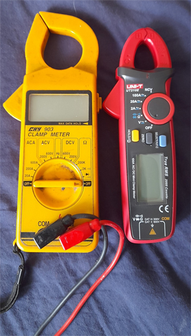

this is a problem with a new installation as we really have no idea of what equipment will be used, so down to experience, and common practice. But with an existing house it is reasonably easy to measure the back ground leakage, two basic methods, this meter VC60B.jpgmeasures DC leakage with circuit isolated, and these Clamp-meter-small.jpg meters can measure the AC leakage with the circuits live, we are allowed 1/3 of the rating of the RCD to leak under normal operation so limited to 9 mA with a 30 mA RCD, however over 3.5 mA we need to take special precisions which increases after 10 mA, so really don't want to see over 3.5 mA leakage.
My whole house everything running as normal has around 19 mA leakage, but since this is spread over 14 RCBO's it is not a problem, but if using just two RCD's it could result in a problem, so we are required to sign that we have designed rather than just thrown it together, the answer of because we always do it that way, is not acceptable when asked why have you done that. However it is often why things are done.
