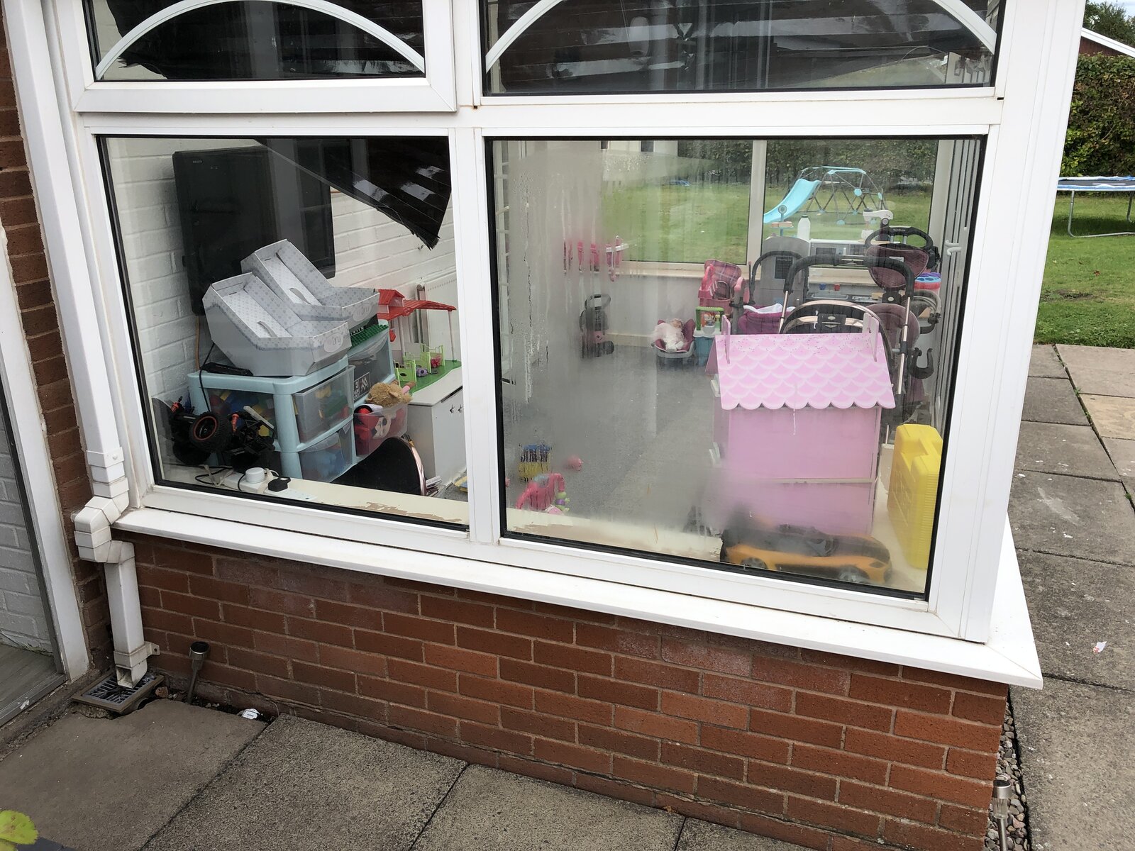

Hi, need some advice really, we have a conservatory to which we would like to take down and build a timber extension, would it require planning or would it come under a tempary building as such, would it need footings a meter deep or concrete slab for it to sit on.? Any help is greatly accepted

The conservatory was built over a man hole by the looks of it. And has a damp course and bricks 1/3 of the way up.
What we wanted to do was very similar to the SIP style construction with osb and insulation with osb the other side. Flat roof. And timber cladding on the outside with weather proof membrane on it.
Your water authority wont allow an extension over a manhole - you will need to move the manhole.

This assumes its on a public sewer, if its a private drain this is OK providing it is fitted with a sealed cover, further investigation will be required to establish if it is private or a public sewer.
Oh yes, good point. Although I can't imagine why there would be a manhole if its just a private section of drain - more common is the house connection to the shared run, but you never know.
It’s already got a sealed cover on it inside the conservatory. The property had planning for a 2 bedroom bungalow to be built in the garden. It’s not going to be close to a neighbour. It is a shared line between three bungalows.

Where the pink play house is where the man hole is that’s been covered. Where the toilet joins the run from next door.
In that case its a public sewer, you will need to contact the water co.
I just wondered what happens as it’s already built over?
The conservatory would have been exempt from B regs at the time of construction, in any case the drain/IC at the time of construction would almost certainly have been a private drain, however the legislation has subsequently changed. The present construction has no bearing on any replacement extension.
