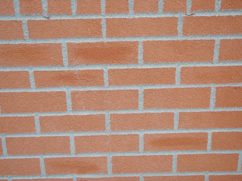

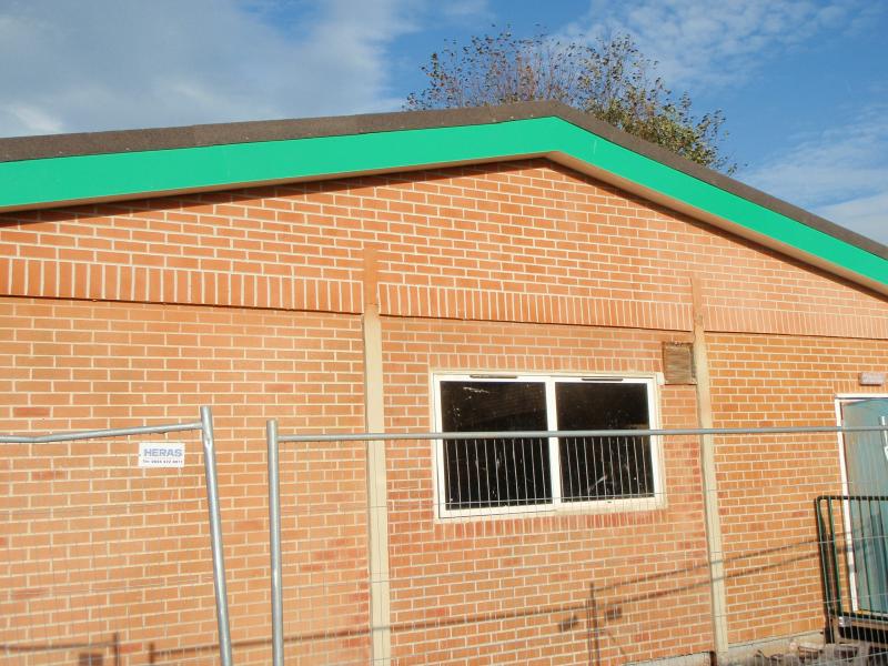

Why not look at StoneFXwalls for re-brick facing. Looks like a new wall, its not a concrete layer like render or pebbledash so damp will breath through it. AND it will retain the value of your home.
