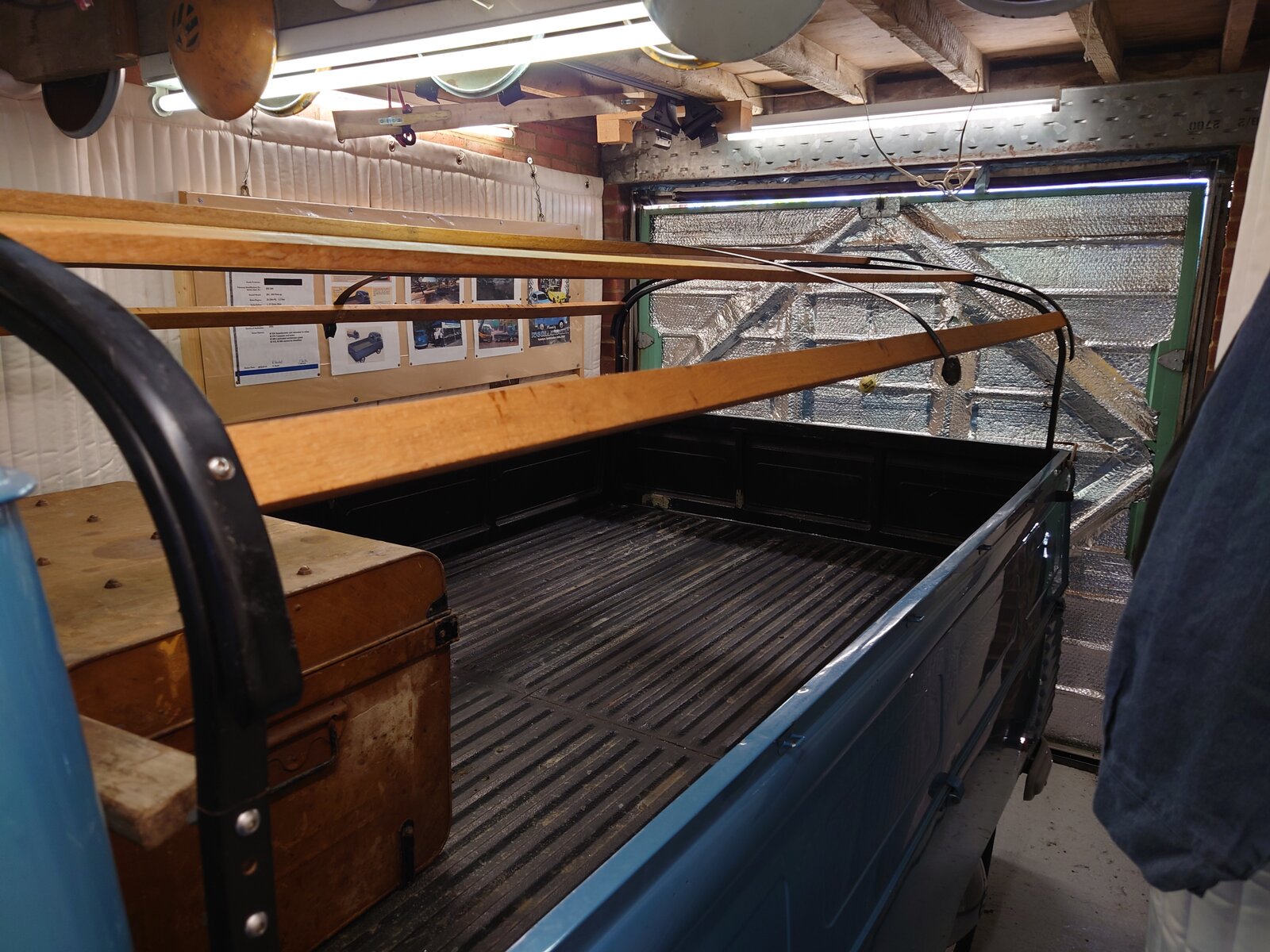

Hopefully this will give an idea of what I'm working with.
This is an older picture. The garage door has been changed since I took it. There is now an insulated electric roller door. Its mechanism hides the catnic. I'd forgotten the beams rest on it.

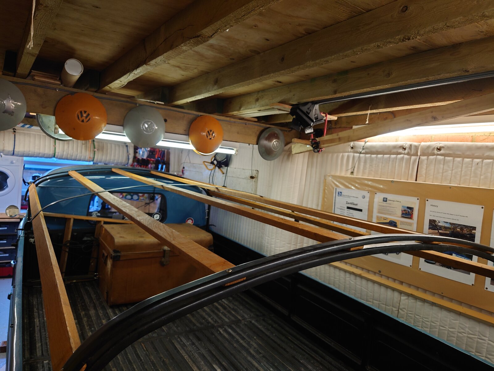

The longitudinal joists divide the roof in to seven sections (two small ones at each edge and five wider ones). If I need ventilation to avoid condensation in the void above the planned insulation, I'll need to make a point of entry to each of those sections (?)...
And looking in the other direction. The garage extends about eight feet beyond the end of the truck. That is my workspace. Ventillation at that end isn't an issue because the longitudinals rest on the end wall, with a soffit that I can make holes through. There are two of the transverse supporting timbers like the one visible in this picture. They bear on brick columns.

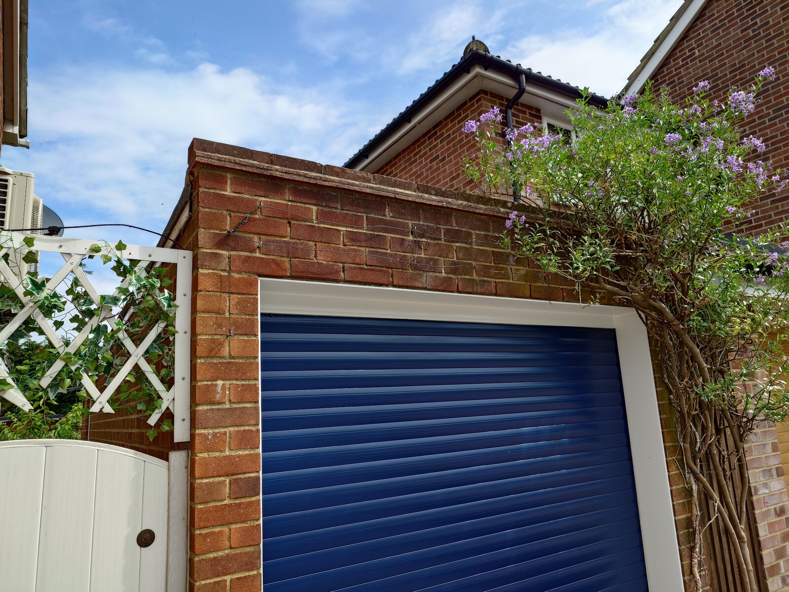

This is the front elevation of the garage. I doubt I'd even be able to get airbricks in without damaging the roof or the parapet.

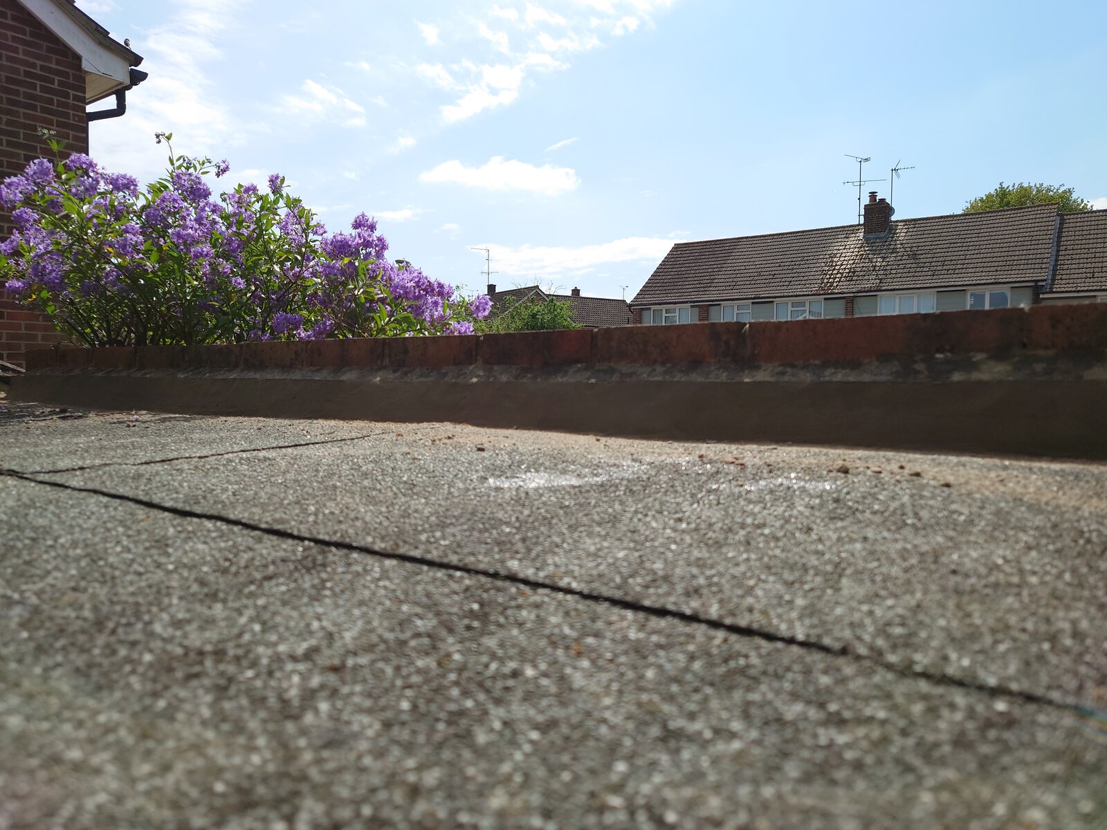

Top of the roof, looking toward that parapet.
