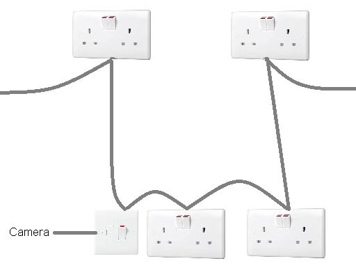

Hi all. Around a year ago I got a sparky in to 'extend my upstairs ringmain into the garage connected to the adjoining wall'. He completed the work and put in two working double sockets and light spur (fused), so to my knowledge at this time I was happy with what he had done.
Now a year on I have more electrical knowledge I see that he didn't extend the ring, but instead put in a fused spur from an upstairs socket. I've also noticed that the fuse he put in only isolated my ring camera and not the sockets themselves.. My issue is I run 2000w mitre and table saws alongside vacuums on these sockets so if it were wired up right surely the 13A fuse would be triggered?
I'm brainstorming the best way to overcome this issue and would appreciate feedback. Do i:
1. Pull another 2.5mm wire into the garage from another socket in the upstairs ring and just change the spur into a ring extension.
2. Pull another 2.5mm from another socket and have this supply the one double socket I use for the saws, and let the current spur feed everything else.
3. Fix the wiring of the fuse so it covers all the sockets and just hope that it doesn't melt it when I use the heavy power tools.
Thanks in advance!

Are you saying that he fed just your camera via a fused spur (which, in itself, would be fair enough) but that the two double sockets were fed as an unfused spur (which is 'all wrong')?
If so, are you asking about the situation if you corrected that situation by also feeding the sockets from the fused spur/ As you imply, if you then had two of the sort of loads you mention running simultaneously (perhaps unlikely?), the current demand would exceed 13A. If you think such loading (for significant periods of time) is 'likely', then you shouldn't really deliberately create such a situation - although, in reality is takes around 22A (about 5,000W) to blow a 13A fuse, the fuse could overheat and the cable could theoretically become overloaded.

Yes so he ran a 2.5mm cable from a socket in the upstairs ring into a 13A fuse, which then exited into the camera, and a radial circuit of two double sockets and then a fused switch for the lights, but I had an earth fault about a month ago requiring me to open up all the boxes and at this point I realised only the camera was on the other and of the 13A fuse. So although he signed off the work because of the radial being on the wrong side of the fuse its not meeting regs.

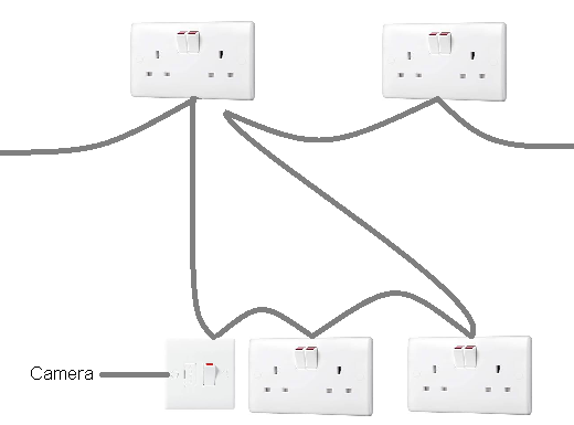

Yes so when I say extend the ring I mean to route a second 2.5mm wire from the same ring as before from the next socket along the ring, and then disconnect the two sockets from each other so the ring instead travels around the garage and then back up. It wouldn't add much cable to the ring as the house is only a small floor plan.

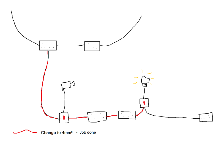

Yes but only because the 13A fuse is the maximum that will fit in an FCU. 2.5mm² T&E can carry 27A so a 25A fuse would do if there were one - or he could have fitted a different overcurrent device - or he could have used 4mm² cable.
My only concern prompting this is that when I use my mitre saw (2000w) and my Henry hoover for dust collection (1200w) I am concerned that this along with the camera and the lights will be significant enough to melt the 13A fuse.
3200W is 13.33A (plus a little for camera and lights) so not likely - and as for exceeding the 27A of the cable....
Fair enough. That would, indeed, be the correct way to extend the ring. As I said, what some people might call the 'ideal' solution, but probably not really necessary in your situation - but it obviously would be more 'flexible' if your needs increased in the future..

As EFLI has said, even one saw plus the Henry is only fractionally over 13A (and camera+lights would be negligible), so really not a problem if you changed things so that the sockets (as well as camera) were protected by the fuse. As I implied, you're presumably never going to use both saws at once.

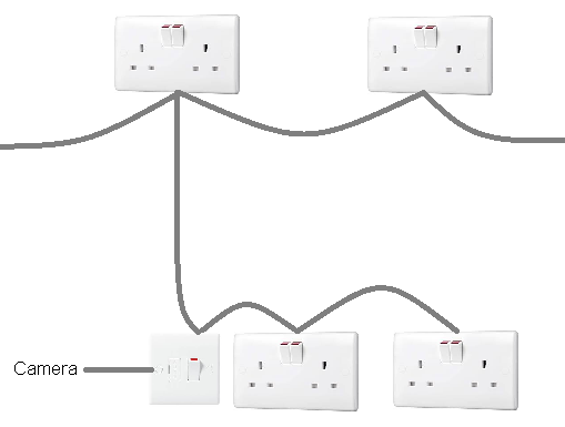

Number one point... Don't panic.

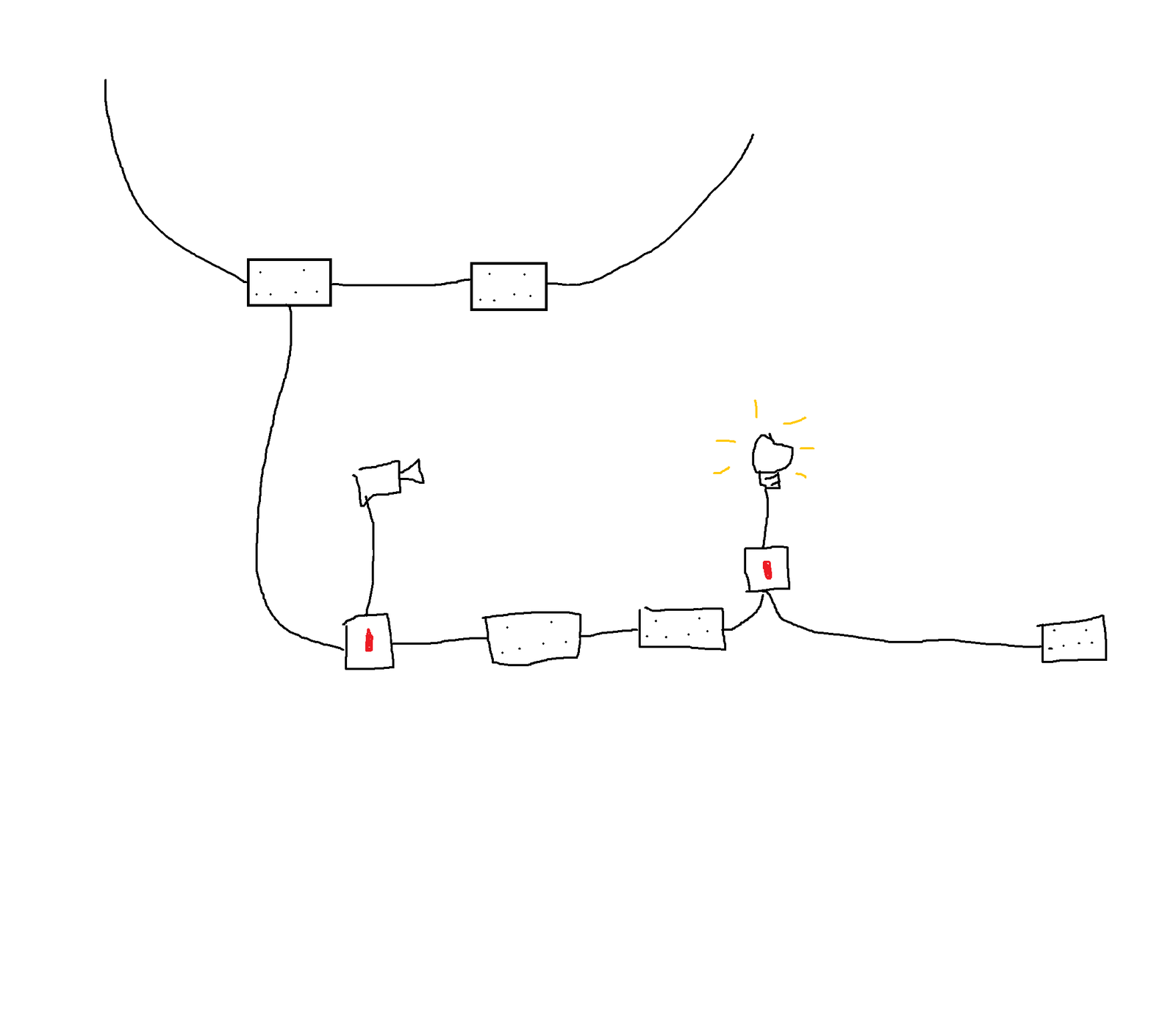

As I understand it you currently have this:
The existing house ring at the top and garage at bottom.
In my view the useage of your garage warrants improving the supply. The current set-up does not conform to regs. However I wouldn't be panicking to make changes.
2 suggestions:
Run a cable from another socket as you have already offered and make part of the existing ring redundant.
Run a cable to the existing source of the spur and add a connector in the backbox if there is space

Fantastic, thanks for all the replies!
I think ill just trial connecting the fuse up properly and seeing if the saws melt the fuse. I want to add a socket on the other side of the garage but for low wattage stuff, so itl look like this:
If this fails and the fuse blows then ill extend the ring. Im just concerned how ill identify which of the wires in the upstairs sockets is the redundant one to remove... But ill cross that bridge when i come to it. The extended ring will look as follows:
