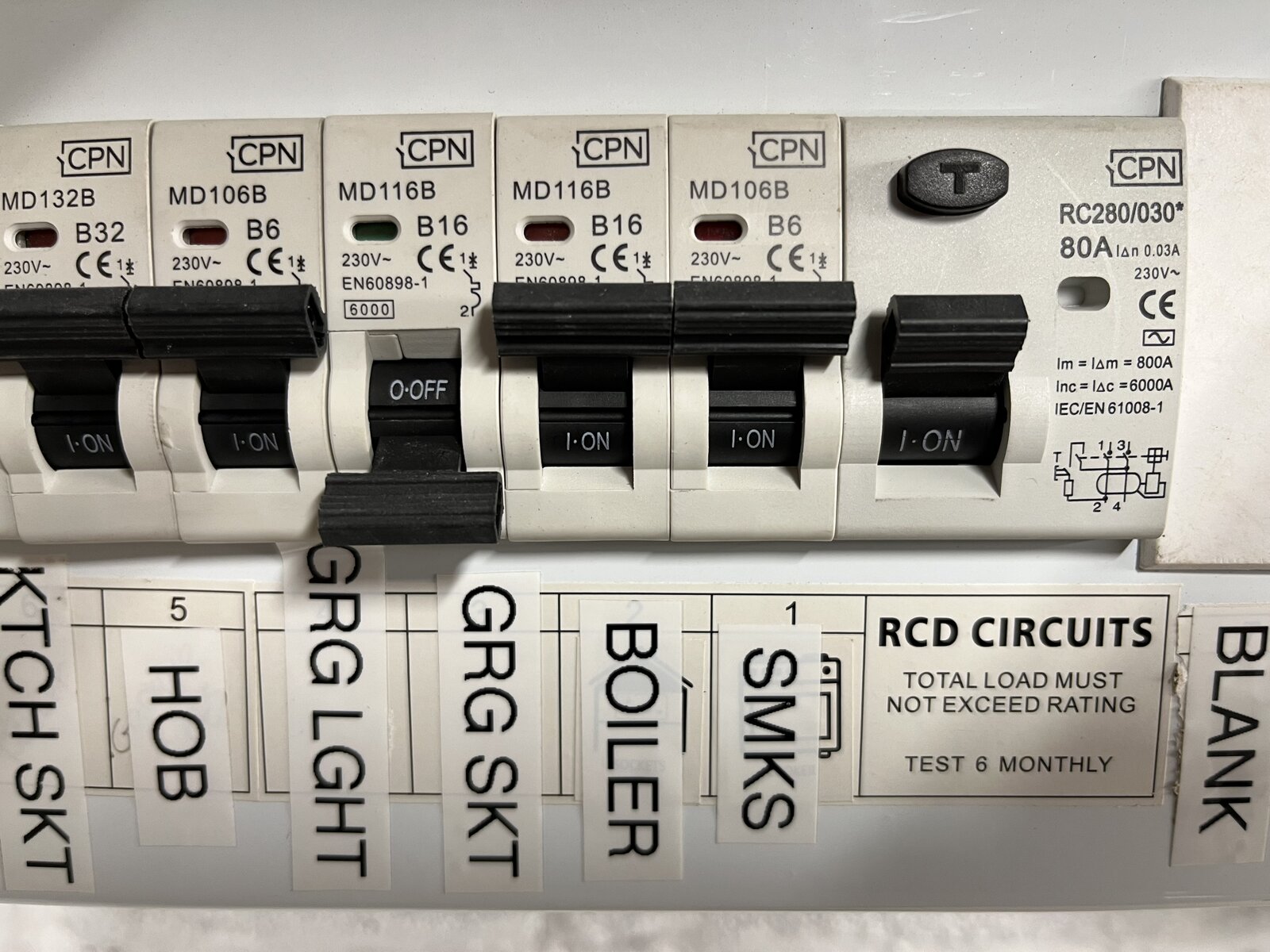

Attached is a pic of the circuit breaker in off position

The first one is certainly not a spur. What the OP has drawn is simply a radial. However, whether or not it's OK depends entirely on the rating of the circuit's OPD in the 'fuse box' and the size of cable.
Point taken. And it looks like the OP is on a 16 amp MCB, which means, that yes, it is permissible, but it is far from ideal if the OP plans to run two devices running at 13 amps simultaneously.
That said, yes, I was incorrect.
Can you be @rsed to briefly explain a “radial” please, and how it’s ok in this situation ??
Noi problem. A radial circuit is simply what you have drawn - a circuit which starts at a fuse or breaker in the fuse box/CU and which goes 'fromsocket to socket. Unlike a 'ring' ('ring final circuit') there is not a connection from the last socket back to the CU. Radial circuits can also 'branch'.
Rings appeared, virtually only in the UK, just after WWII, allegedly due to a shortage of copper, and have persisted (only in UK). Almost everone else uses just radial circuits, and they are very much coming back into vogue even in the UK.
Your circuit is protected by a 16A MCB. That being the case, everything is fine, with any credible size of cable used to wire the sockets. 2.5mm is certainly fine..
And how, if everything is rated ok, another spur can be added ?? (All wires are standard ring main 2.5mm)
Yep, you can add as many extra sockets you like, originating them at any one of the existing sockets, and even having a 'string'; of them idf you want. However, be aware that the total load across all of your sockets will be limited to 16A (about 4kW) by the 16A MCB in your CU.
I think it’s more my non electrician explanation of things that confused the matter, not you being incorrect :giggle: . I appreciate the reply (y)
And just for info, the washing machine and tumble drier are in use on one of the double sockets, but are never used at the same time, and would not be in use at all if I was using the other sockets for DIY, etc, now I know they’re on a radial circuit.
One of the machines at a time would certainly be fine. In practice, so would having both of them on simultaneously, even though that is pushing things a bit for a 16A circuit. It's the dryer which is the energy-guzzler - a WM only draws high current for a pretty short period of time (whilst it's heating water), not long enough to be a problem
