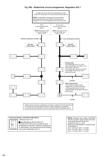

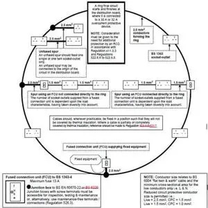

I was more looking at lack of earth bonding, but yes we use rings a lot so that sections can be isolated, but with domestic we are talking about ring finals which are not the same thing, but the word final does cause a problem, as English does not allow things like very end, or the final final, so we have used different names like spur and fused spur. The regulations show examples of rings finals and radial finals. Ring final.jpgRing and radial circuits.png

If you want to beef up the radial circuit, replace the 16A MCB with a 20A one.
Indeed - I should have said that.
In fact, assuming that the 2.5mm² cable is installed Method C (very likely in a garage) then, if one is available for his CU, even a 25A MCB would be OK.

I had an extension done a couple of years ago, and part of that was a new garage. The qualified electrician did all the wiring, including a new fuse box which lives in the garage. There are 3 x 240v double sockets and I wanted to add a new double socket, so I was checking the the wiring the electrician did. To me, the three double 240v sockets don't look to be a ring main. To me it looks like they are all spurs (see attached diagram) ??
It's probably a radial circuit, and dependant on the MCB protecting the ciruit - yes, you can just add another socket, or sockets, using the same size cable as the other sockets.

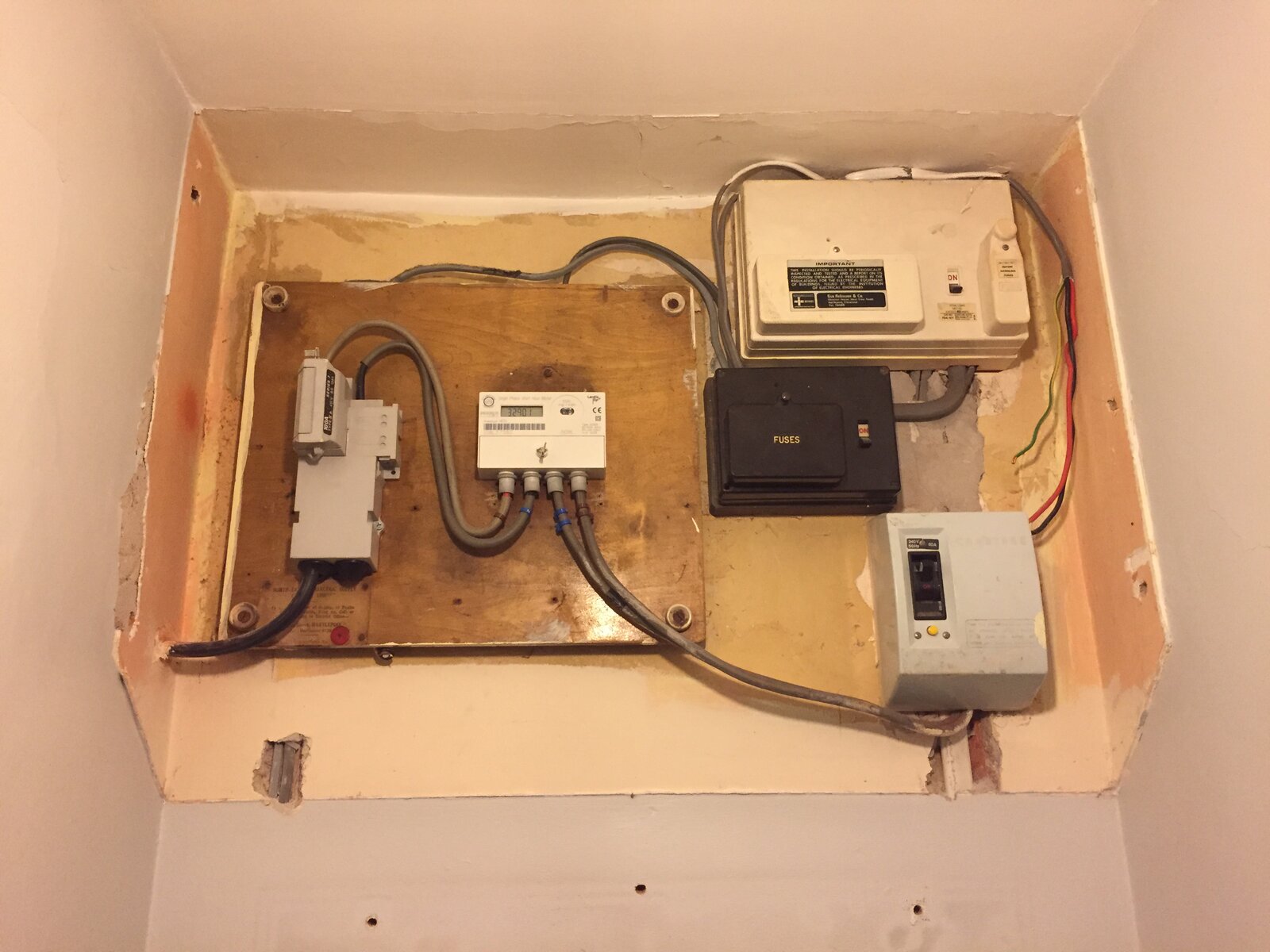

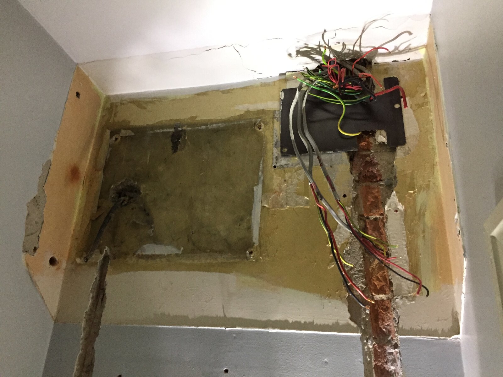

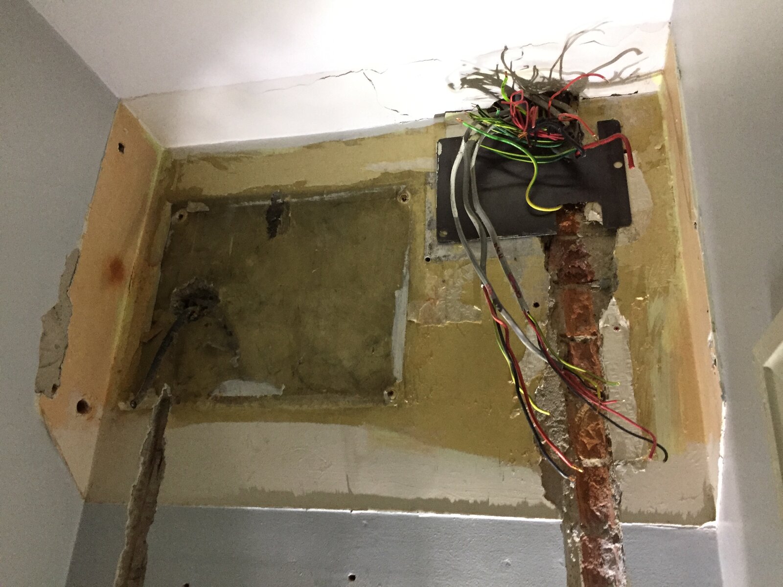

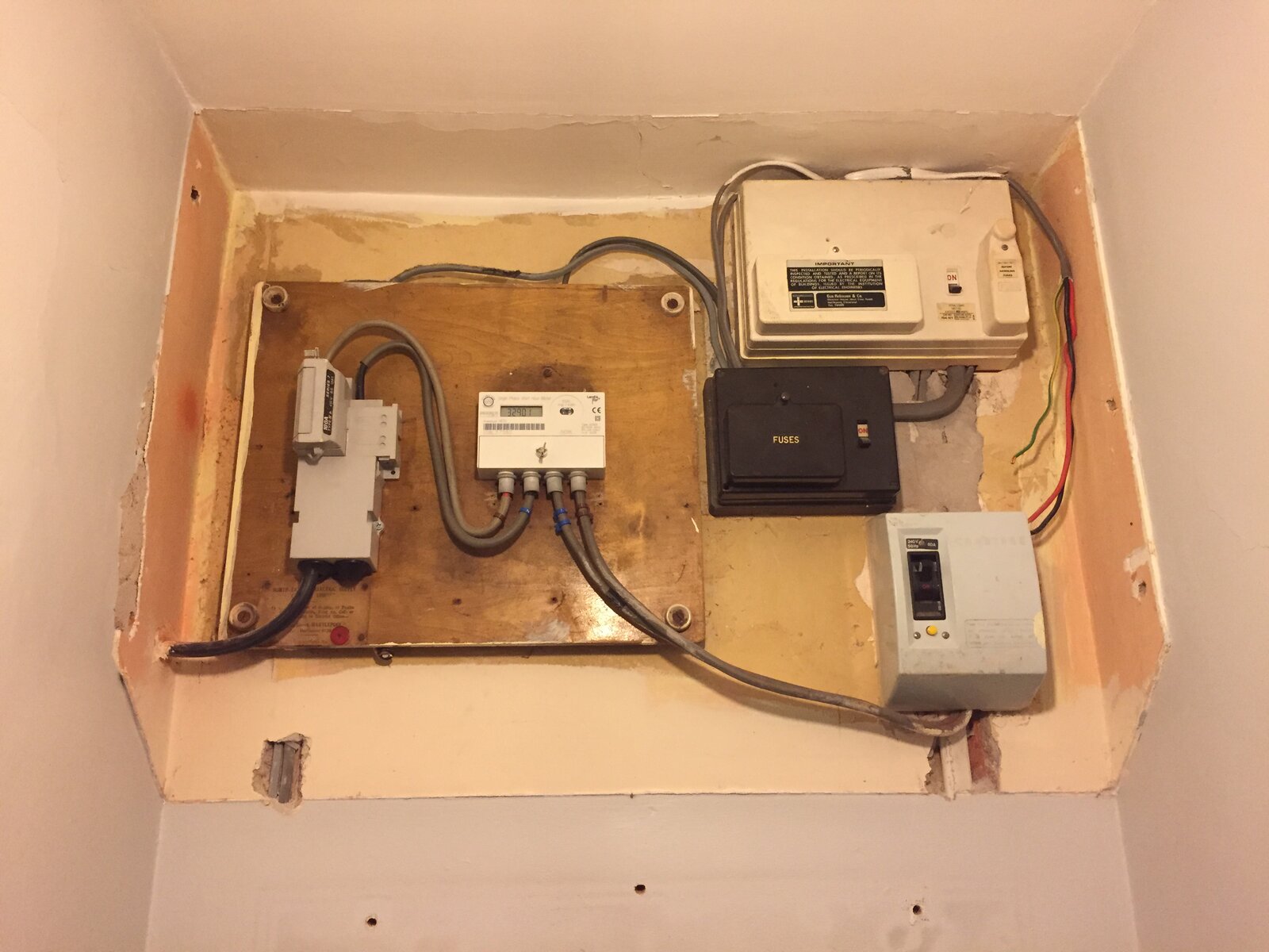

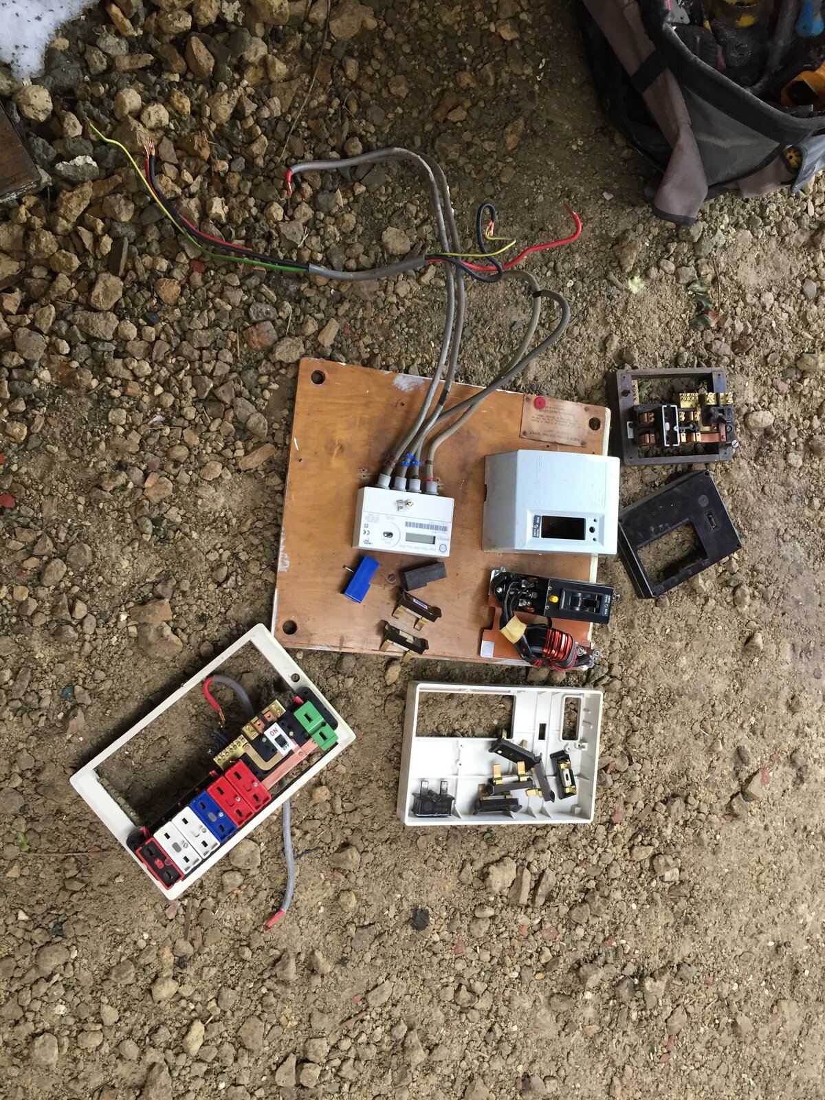

My house is an old 1948 semi detached ex Council house. When I moved in 23 years ago I completely rewired it myself (I know, very naughty :cry:), adding many double sockets that it lacked both upstairs and downstairs. Both upstairs and downstairs were on what I assume is a bog standard ring main. That’s why I thought my new garage should have been on a ring, it’s all I’ve ever dealt with, and I just thought that was standard practice. Obviously not, and I’ve learned something new :)
I’ll try and dig out some pics of the old fuse box arrangement…..you're in for a treat !! :p
The old fuse box…..
My house is an old 1948 semi detached ex Council house. When I moved in 23 years ago I completely rewired it myself (I know, very naughty :cry:), ...
There was nothing naughty about that, at least as far as the law was concerned, 23 years ago, but one hopes that you were 'competent' to do what you did ;)
