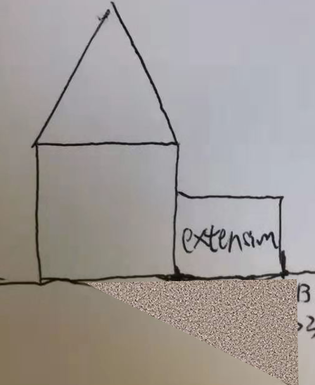

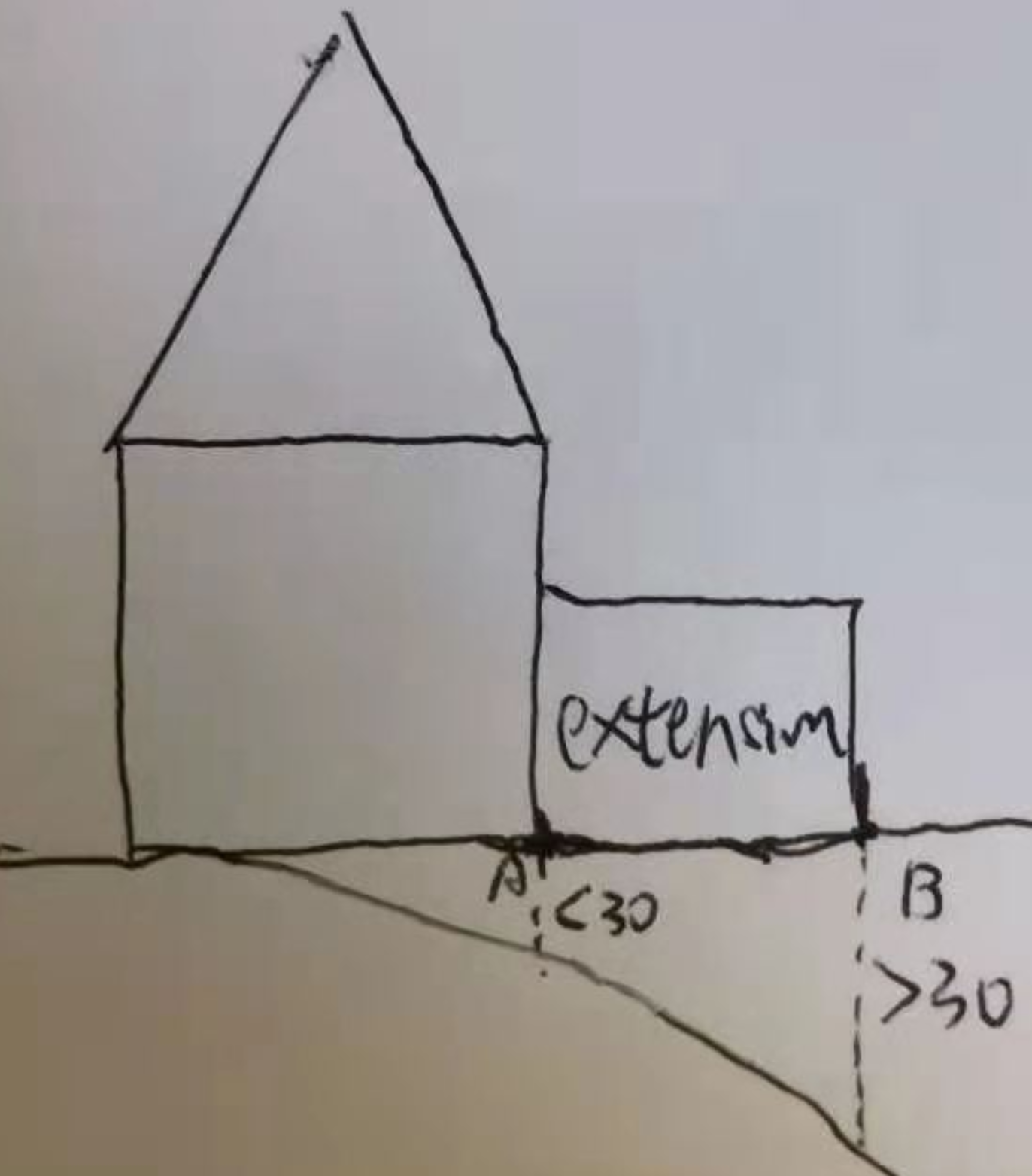

Many thanks, guys, in this case, I should apply for planning permission. How likely it could be granted? Thank you.

Ground level
"ground level is the surface of the ground immediately adjacent to the building in question, and would not include any addition laid on top of the ground such as decking. Where ground level is not uniform (for example if the ground is sloping), then the ground level is the highest part of the surface of the ground"
from tech.guide
It does not mean you can add to or build up the existing ground.
I can see how youd not be allowed to gratuitously raise the level, but in the OPs situation, the level was not raised by "an addition laid on top such as decking". The fill between A and B was clearly done to facilitate building the extension:
So allowing for footings being wider than the wall, the ground level would be that at the back of the extension....
The rules as stated earlier in the thread are quite clear and have been for many years.
So it looks like the OP made a mistake in not raising the ground level to build his extension on, instead of building well below floor level.
The ground would then have been at the right height for him to have his decking
