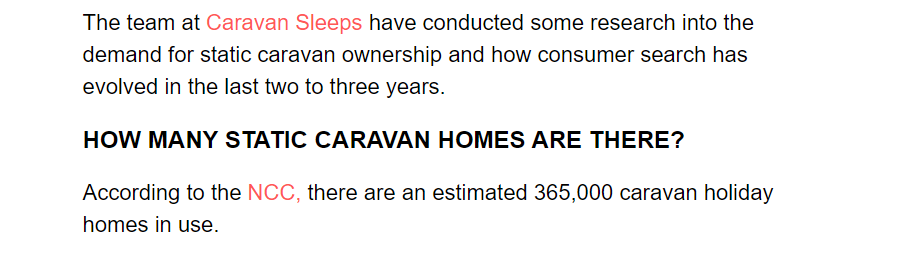

That's interesting cos all the statics on my site are mains gassed
That's pretty unusual.
There's two new estates of houses in this village fed from large bulk LPG tanks buried in the ground and all have gas meters outside. Looks just like mains gas to the unwary/uninitiated. Builders sold them as "gas central heating" no mention of LPG.
