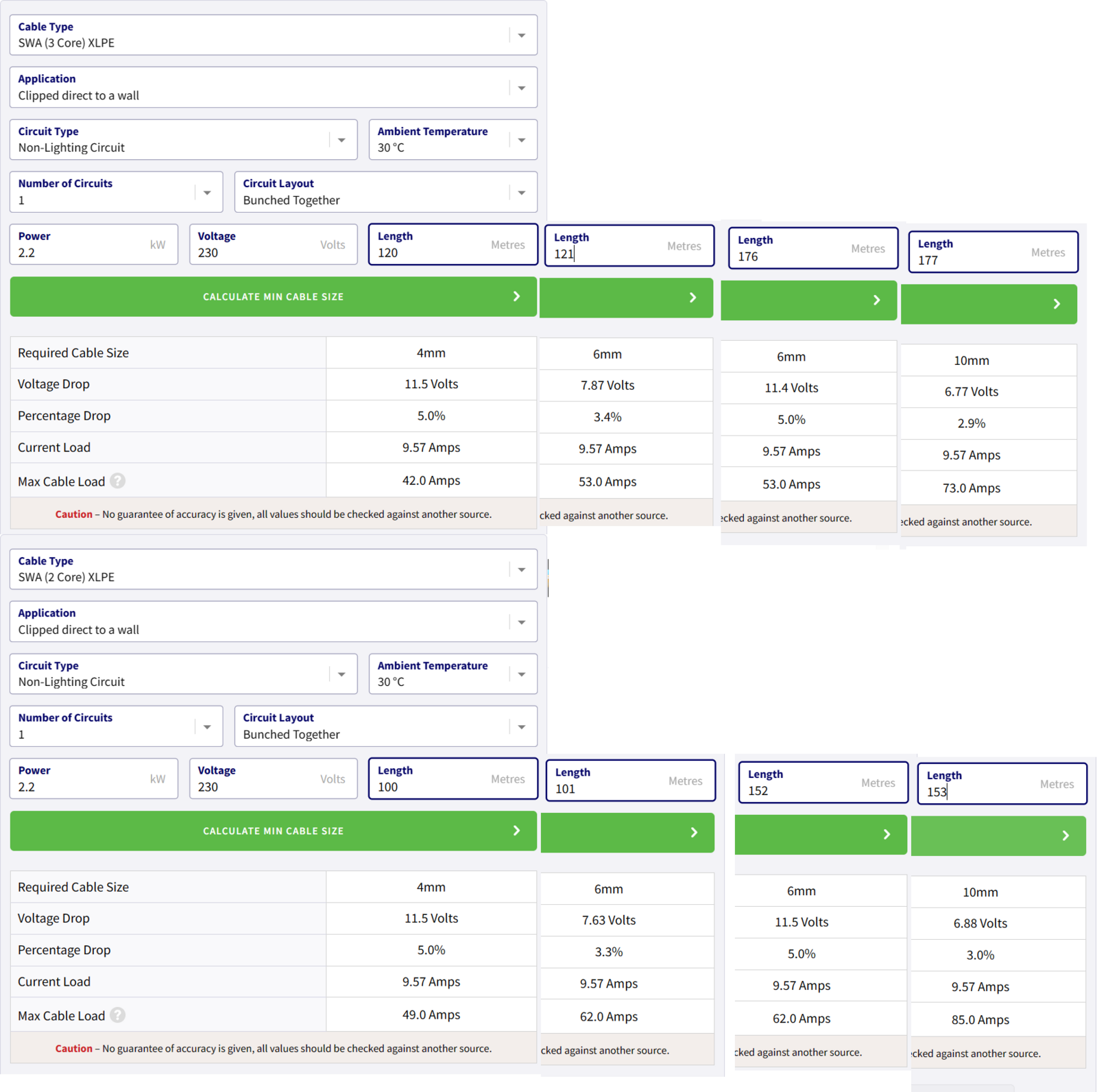

My calculations allowing for corrected mV/A/m 4 mm² would just be within the permitted volt drop of 11.5 volt at 10 amp which is the max output of the generator for 118 meters, but I have not seen motor rating, and with an inverter drive likely you could get away with a larger volt drop.
Again looking at different on-line calculators for 118m: one says 4mm² another says 6mm², it also depends on choice of cable.
Showing the max length of 4mm² and 6mm² 3C and 2C by TLC
I don't know if it's trying to do a 3ph calculation but right through it calculates 2.2KW as 9.57A

4mm² is a no brainer over 2.5mm² and 6mm² is about double. In the great scheme of the whole job is it worth the quibble of the larger size?
Prices are for 100m of 3 core (2 core), directly off the first hit on Google which happens to be TLC.
