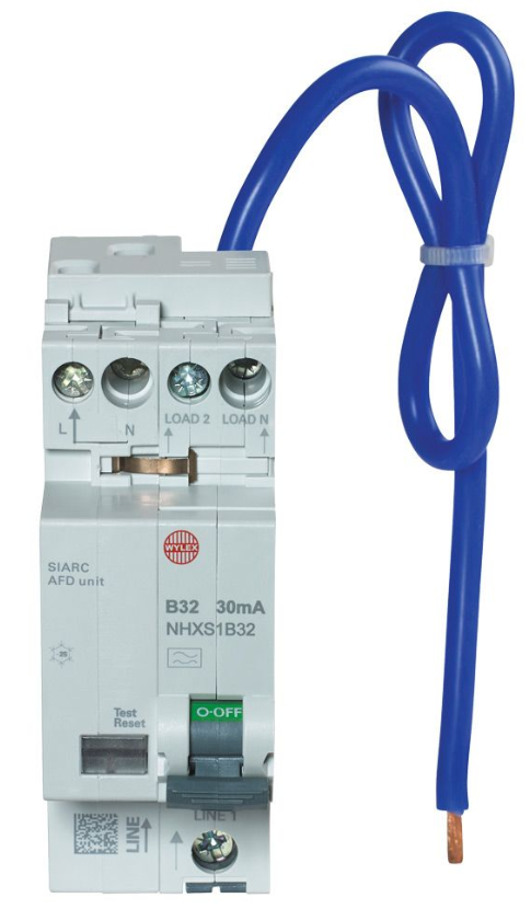

If the miniature ones have an led light on the front they probably include arc detection which is fairly new.

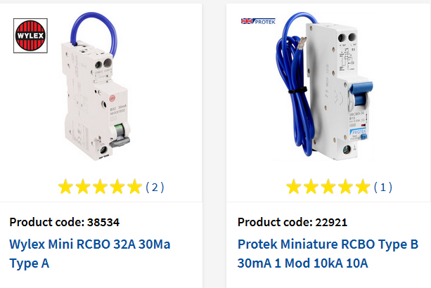

But had I made the same error with some one else's house do you really think I would return to them and say sorry I fitted wrong type, I want you to pay £15 each for the correct type? Fact that when I phoned my supplier he said he only has type B in stock which were actually type AC does not help, look at this advert it clearly says B type, but look at picture and it shows the logo for type A, yes curve B but not type B.
Try doing a google for a type B RCBO and see how many are curve B not type B. This is typical
the one to right is type AC if you look at the picture and curve B, and on left type A and curve B.

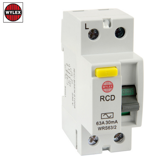

In an existing CU a Wylex WRS63/2 is installed, this is a AC type, the lights have all been changed to LED, some with dimmers ... and note that this could cause issues for the AC type RCD, an A type is recommended - but so far though there has been no tripping.
Am I right to say the above RCD is known as a Residual Current Circuit-Breaker (RCCB) without protection against overload.

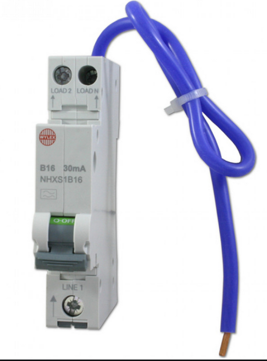

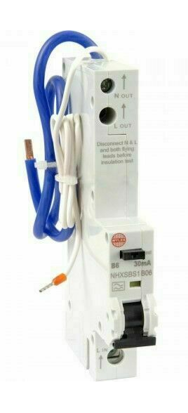

Also installed are several Wylex NHXSBS1B16's, these are B Curve full height RCBO's, I note the test button and additional white wire that I understand connects to earth:

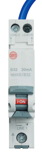

Back to one of my original questions, full height vs Miniature RCBO's, the Wylex NHXS1B16 is also a B Curve, miniature RCBO, but lacks the test button and earth wire.
Although the miniature RCBO provides more space in the CU for dressing cables etc, how do you test it without the test button ? and why no earth wire ?
In trying to understand the differences between types for RCD and RCBO's, the labelling for an RCBO is a little confusing as stated.
So, to try get this clear in my mind - the Type letter for an RCD refers to the 'curve', but an RCBO has both RCD and MCB functions, but I only see the Curve Type in the Wylex catalogue being B or C, no mention of A, D or F type for an RCBO part, is that simply because you cant buy an RCBO with these Type characteristics, only B or C, ... and so to get RCD Types A, D or F, you would need separate MCB and RCD's to provide the right type of coverage.
And lastly 'poles' (not the hard working variety), I note the full height RCBO above is single pole, but the miniature is 2 pole ... is the lack of earth wire and test buttion on the latter something to do with it being double pole ?

The wylex RCDs with yellow test buttons are type AC (note symbol ~) which don’t trip when they should if a DC fault is present.

the test button on the RCBO is under the lever in the pic.

The RCBOs you listed are all type A, as far as I can tell expanding the image on my iPad which does blur the image.
Rcbo with arc detection
I note that in Germany these are standard ... considering the hotchpotch of electrics sometimes found in our aging housing stock - surprised that this wasn't specified before ... the price would lower once adopted, though currently your average CU would be quite expensive in comparison.
