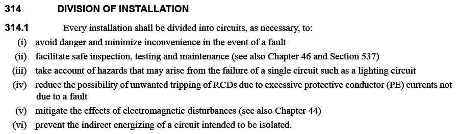

None of the editions specify any particular arrangement of devices, things like '18th edition consumer unit' are terms invented by the marketing departments of various manufacturers.
However:
  • 314 Division Of Installation requires that 'every installation shall be divided into circuits as necessary ... ' for various reasons, and shoving half of the installation onto a single RCD is in no way complying with that. No one ever wanted the upstairs lighting to fail because someone shoved a knife into the toaster, or their home office to be disconnected because rain got into an outside light.
  • Much modern equipment has a certain amount of residual / leakage / protective conductor current in normal operation, and the maximum permitted is 30% of the RCD rating, which is only 9mA for a 30mA RCD. As a single filter in an appliance could result in 1-2mA, it's very easy to be way over the 9mA when multiple circuits are combined onto a single device. This will result in the RCD tripping in normal operation.
  • Adding another circuit to a dual RCD consumer unit is likely to compound that problem further.
  • The inverter for a solar panel installation cannot be connected to a circuit which is supplied from an RCD which covers multiple circuits, as disconnection times will not be met.
  • Certain types of equipment require certain types of RCD - with a dual RCD consumer unit, there is no option to install non-RCD circuits or other types of RCD as required. Not possible to install certain types of RCD downstream of others either.
  • When AFDDs are mandatory for some/all circuits, installation of those is just a matter of replacing an RCBO with an AFDD. With a dual RCD consumer unit, the only option is a new consumer unit.

Thanks Mr Port for your explanation.
So does the 18th edition require amost all RCBO's now in a CU.
Where there is more than one circuit on an RCD there will always be an inconvenience to the other circuits if one of them trips. I see pre 18 edition CU's with exactly that arrangement, often with just one RCD for all circuits, that seems the norm. I have that configuration at another location, and to my knowledge it has only tripped once in 4 years.
Am I right in suggesting that a dual split CU went some way to dividing up the inconvenience, but now the 18th Edition requires it to be all split, so you can't now have a single RCD that protects both a house lighting circuit and say an outbuilding, as an example, which is not the arrangement I see being sold by CU manufacturers, they still have several MCB's under an RCD in there CU offerings.
