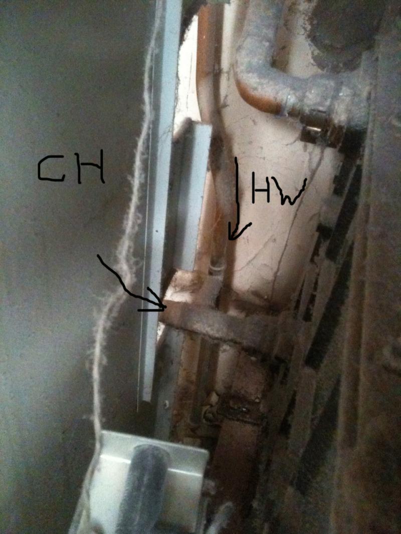

Also in the middle pic of the left side of the boiler there are two 22mm pipes entering the boiler. The rads and cylinder seem to return to the bottom one. The flow comes out of the right side. What's the top left.pipe?
The bathroom rad gets hot when only ch is on also but if there is a path from to the rest of the system I guess that would happen also.

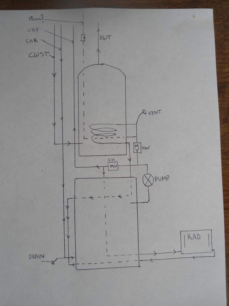

Where is the mystery pipe in your latest drawing?
It's the one between the HW MV and the cylinder vent that runs behind the centre of the cylinder and up the top on the right. I've labelled it "15mm?"
But you said it came out of the boiler on the left top - as in your pic.
Ahh sorry, I thought you meant the 15mm pipe that feeds the towel rail.
The 22mm one that I wasn't sure about in the photo isn't in the drawing but it does come out of the top left of the boiler and head straight up into the ceiling with nothing else connecting to it. As the other two 22mm pipes going up seem to to be CHF and CHR it must be the vent? There is a 22mm pipe with a U bend over the feeder tank in the loft.
I've added it to your drawing.
It now raises another question: where is the feed from the feeder tank?
One possible answer is that you have a "combined vent and feed". If so there will be a 15mm pipe from the bottom of the tank which will join the 22mm vent pipe between the tank and boiler.
