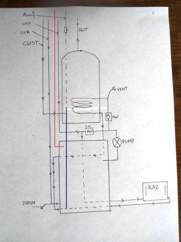

I did the test on other rads. I can't find one rad where the opposite valve heats up when HW or CH is selected. Do you think the return from the bathroom rad could be plumbed into the CH flow rather than the return?
I was beginning to think that myself; it's the only logical explanation.
Another test is on the cards to see CH ON heats up the return of the bathroom rad. I think it does.
Oh no. CH only on HW off makes the left bathroom rad valve heat up first. HW only on makes the right bathroom rad valve heat up first. The fact that HW only always heats the same side rad valves as CH only suggest that the return of the bathroom rad is plumbed into the CH flow not return :(

The problem now is: what to do next?
It all depends on how important it is to have the bathroom rad working all year round.
One thought.
Are you able to check the return from the cylinder back to the boiler?
It should be plumbed like this:
View media item 73253
There should be no connections between the cylinder connection and the boiler.
Yeah that diagram looks right and matches the photo at the top of page two.
I know I am now at a point where nothing can be done without ripping things up. If I close the 15mm isolation valve on the pipe to the bathroom rad in the summer, that will stop HW heating the rads but will also mean I lose that rad in the summer which isn't really a problem. HW only heating up other rads in the winter isn't much of a problem as it normally co-incides with CH being on anyway.

One possible solution is to disconnect the 15mm pipe from just after the HW valve and connect it to the CH return just before it connects to the boiler. The bathroom rad would then be part of the CH circuit only. The rad "return", currently connected to the CH flow, would then become the "flow"; and the "flow" would become the "return".
