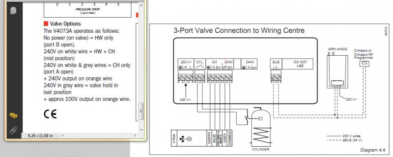

the swc runs on the same basics as the vaillant vr65
Ah, I see. It assumes that, if the cylinder stat is not calling for heat, then it must be satisfied. But what about a wire from the Programmer HW OFF to the valve grey? Where has that gone to?
Useful link, by the way.:cool: ;)
the position of the 3 port is controlled by the programmer through the ebus connection, the swc needs its own 240v supply so I assume the electronics in the swc control the switching and movement of the valve.

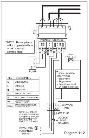

Having just fitted some Vaillant controls, I think I may know what the problem is! :D
The Smart Wiring Centre needs a "link wire" between L & R on the boiler, it's shown in the installation instructions in Diagram 4.3 / Page 6. Have you fitted this link cable?
On a Vaillant boiler (which seems to be using similar electronics (same codes)), "S.30 = No heating demand from external controls (clamp 3-4 open)" 3-4 is the location of the link cable on a Vaillant! ;)

That makes sense, R is the switched live that would normally be used to start and stop the boiler. By making this permanently live all control of the boiler is handed over to the Ebus.

What would happen if the Grey wire from the valve (=DHW off) was connected to terminal 2 of the cylinder stat instead of the smart wiring centre? Is it worth a try?
This would not be a good idea. As has been already said the valve is fully controlled by the 'smart wiring centre/boiler/Ebus system'. I wouldn't cross connect inputs and outputs and there is no logic to doing this anyway.

I don't see why the orange wire is used at all in this setup.
You could try setting d.70 to '0' and wiring the white and grey wires to 'CH on'. Disconnect the orange wire. This will set the valve up as a diverter valve.
This should set the boiler to either CH or DHW, but not both at the same time. With no power to the valve it is setup for HW flow. Power to white and grey gives CH flow. This would be a hybrid of the setup shown in fig 4.5 for two zone valves, but using the sprung return on the diverter valve to give you HW flow.

I cant see the point of moving the wiring in the swc, the op has said there is no power on ch demand terminal when stat calls for heat, he would be better to find out why, the fact that the hot water works suggests that the clima pro is connected properly, I would check that all the wires in the swc are actually making contact and that the polarity is correct.
I can't see where he said he was getting 240V on the 'CH on' terminal? My suggestion is a way of eliminating any input from the orange 'hold' wire and any interaction of the 'd.70' DHW priority or mid position setting
Have the 3-4 terminals been checked yet?
It would be normal for the boiler to be supplied with a link on these already in place.
If it were not then someone would have intentionally removed them.

agile this isint a vaillant and would the boiler fire for hot water if a link was required ?
I do know that its not a Vaillant.
But I dont know if it would fire for DHW if that link is removed when its under the Ebus control.
In the absence of any other good suggestions I am surprised that the OP has not already checked if there is a link or not.
