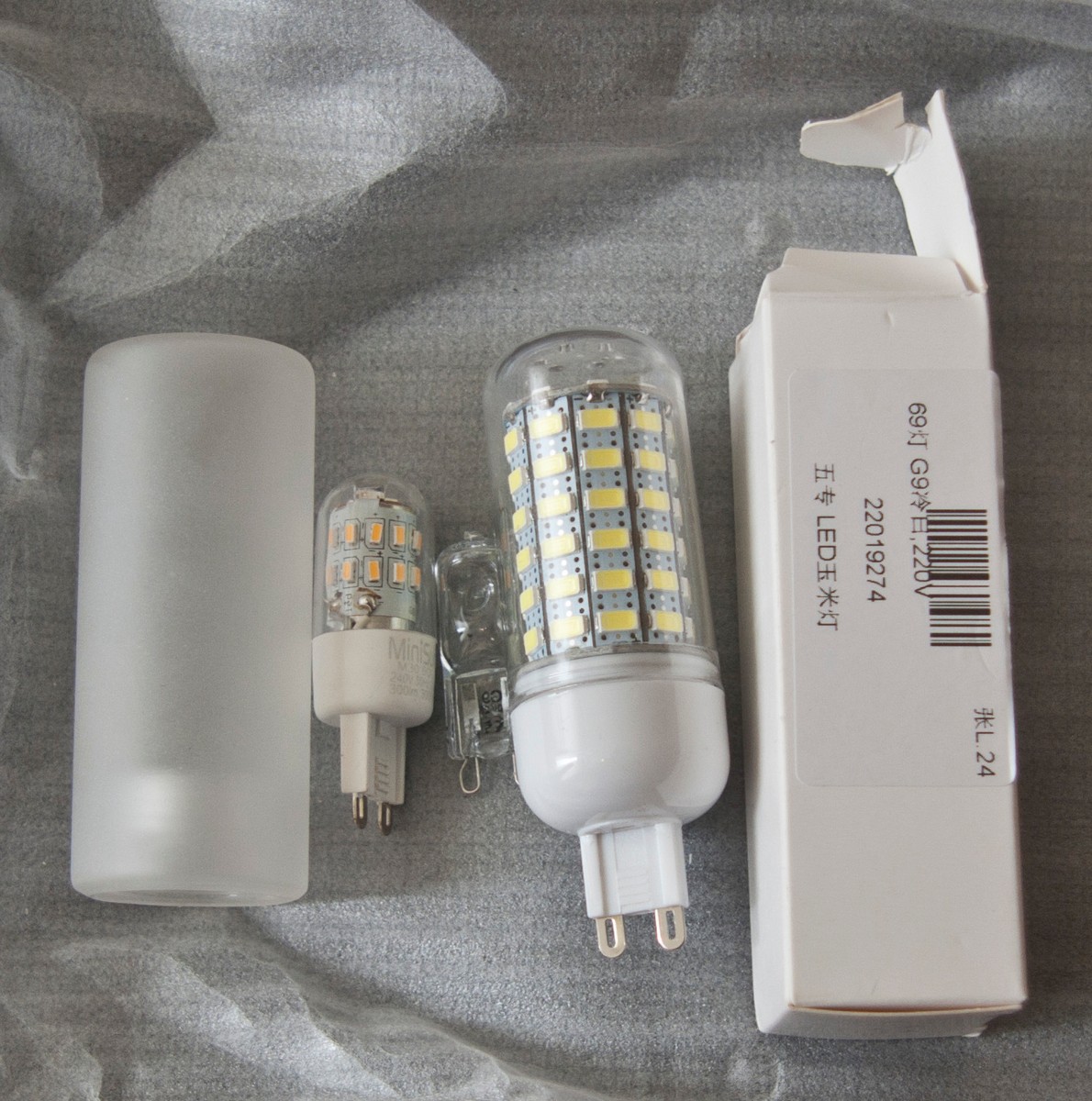

The biggest problem was G9, IMGP0870_1.jpg the large one did not flash or flicker, the package does not show watts, or Lumen neither does the bulb, but work well, however the cover will not fit over the bulb, the halogen bulb is far smaller and must have cover fitted, the small LED flashed when switched off, and flickered when switched on.

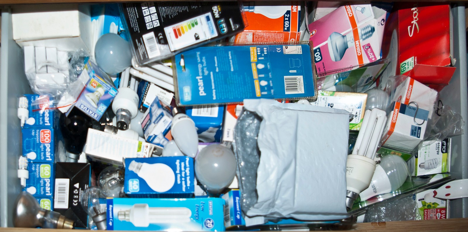

The problem is they last for ages, so when a bulb will not work with an electronic switch but is OK for some lamps, one keeps the bulb, it is brand new, so why dump, but you end up with a stock IMGP0859-60.jpg of bulbs which will likely last my life time. Included in that stock are the bulbs given to my parents to get them to move over from tungsten, compact fluorescent lamps, which are to be withdrawn from sale, the move from B22d to E14 and E27 has resulted in few places when I can still use the old bulbs, still use tungsten bulbs to keep my fermenter warm when brewing beer, LED do not work they don't produce enough heat.

The quartz bulb should not be dimmed, the whole idea is the quartz is so hot the tungsten will not stick to the quartz, running them cold the tungsten coats inside of quartz which can be seen as it goes black. The glass cover over the quartz is to stop white hot quartz landing on the carpet should a bulb fracture when it blows, it is not required when using LED bulbs, however it does charge the look of the lamp without the glass cover.
The small bulb G9-comp.jpg will fit in the standard glass cover, rated around 2 watt, but using an electronic switch there is a shimmer when switched on, and even with 5 bulbs it needed a load capacitor to stop it flashing, the temporary cure was fit one quartz bulb, however once there are no quartz bulbs clearly that option closes.
The large bulb breaks the rules, no wattage marked, and no lumen marked, however no shimmer or flash, my wife got 5, and one failed within a day, so ordered more, out of interest I opened the lamp, and there is a electrolytic capacitor nearly as big as the whole smaller lamp, clearly why no shimmer, and found a clear dry joint which I cured so back in use.
