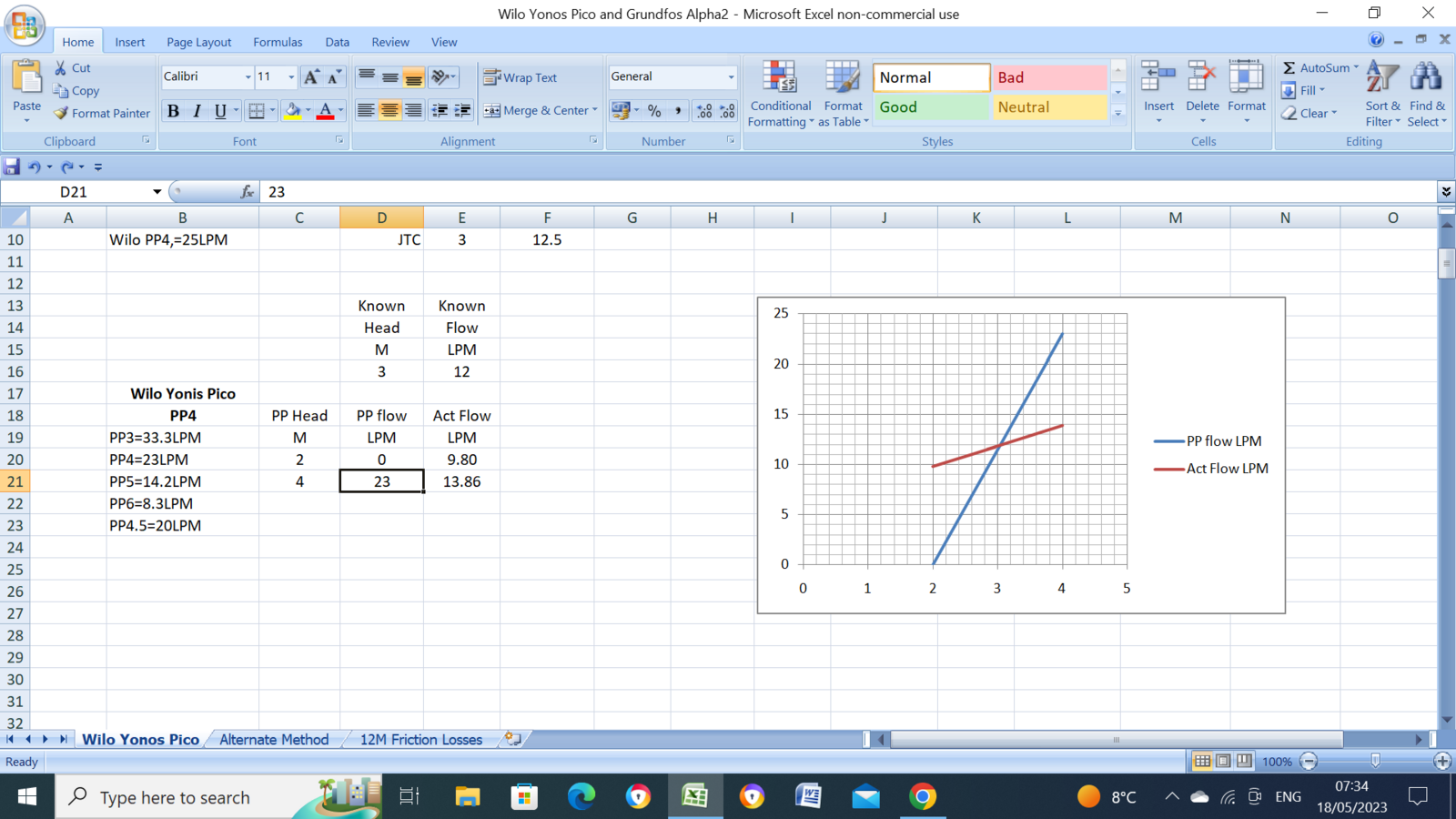

CP1 at 3M would be my choice as it gives excellent contol, I have a 6M Wilo Yonos Pico where I can incrementally change the CP & PP settings in 0.1M steps, I run at a PP setting of 4.6M which gives me a 3M head and 22/24W with all the TRVs full open, it will then fall to ~ 2.4M and 15/16w when TRVs throttle in, I couldn't achieve this with the above pump.
LPM = kw*860/60/dT, so LPM = 1*860/60/14.33, 1.0LPM.
or kw = LPM*60*dT/860
or dT = kw*860/60/LPM.
Must head for the bunk.

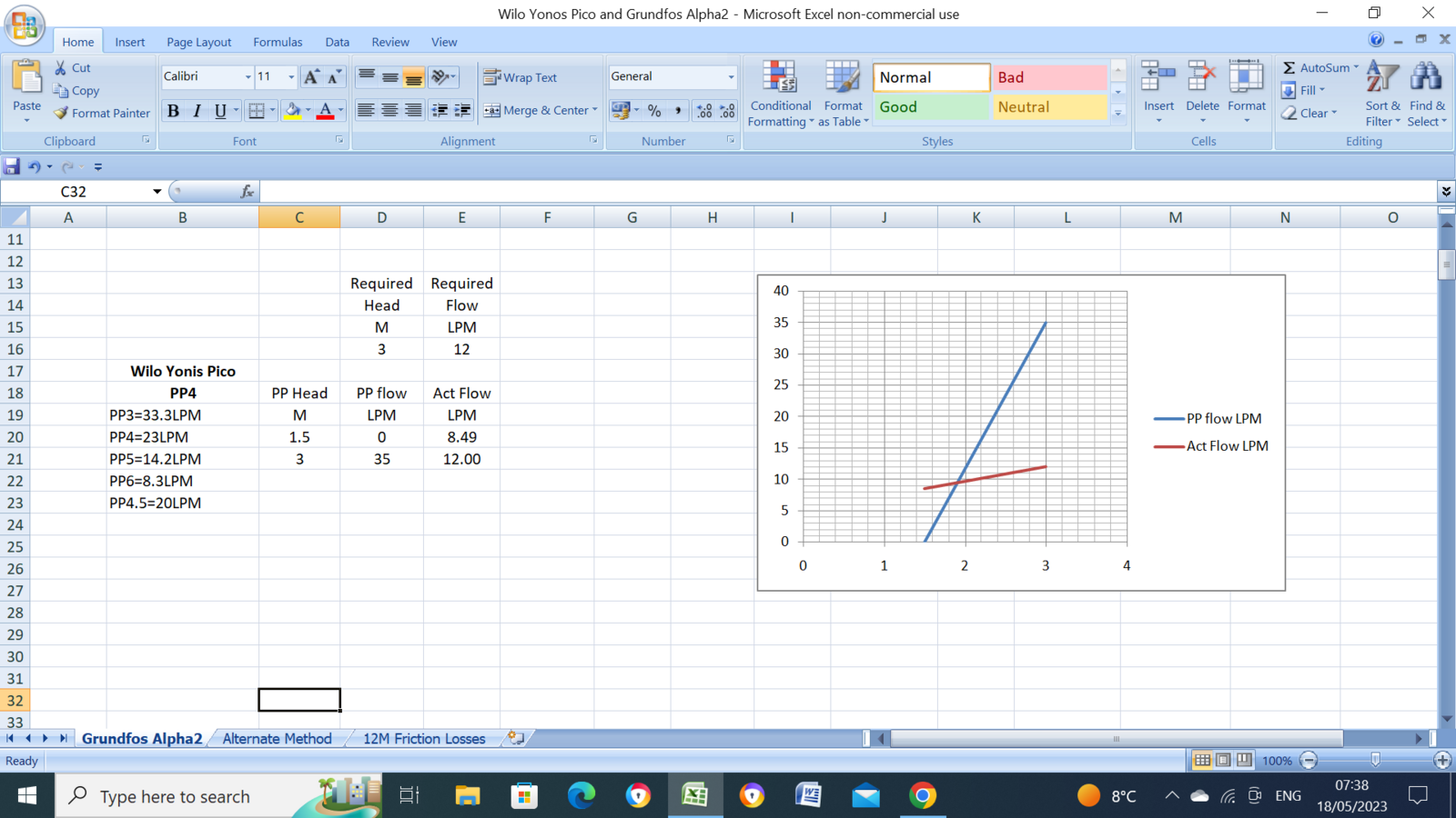

Slight correction on my own set up, I have 10 rads with a outut of ~ 12kw, I have the pump set to a PP setting of 4.0M which gives me 12.0 LPM at a 3M head.
If I used the Grundfos at a PP setting of 3M then I would get a actual flow of 9.5LPM at a 1.9M head. (see below)
Of couse your system may have bigger diameter flow and return piping than mine so with all rads on, PP2 at 3M may be OK, you can obviously play around with the different modes/settings.

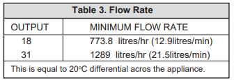

If 774LPM is the minimum flowrate required then if the boiler if firing at 30kw will have a dT of 33.3C anf IF 19kw is its minimum output the dT is 21C. Minimum flowrates are generally given at max output at a dT of 20C, in which case flowrate should theoretically be 1290LPH (21.5LPM). but more to that later.

The boiler has a max rating of 31kW but as far as I can tell its set at the factory default setting of 18kW.
The manual says:
The flow rate through the boiler must not be allowed to fall below that given in Table 3.
